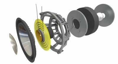

There are three 5.5-inch woofers in the 75F. It’s interesting that Paradigm presents these drivers as “5.5-inch,” rather than the industry-standard way of stating things as 5 ¼-inch drivers. These are not any “bigger” than any other 5.x-inch driver. It’s those Paradigm marketing guys again: just trying to make it seem as if their woofers are a little different and better than someone else’s. Nothing wrong with that.
Front Baffle Driver Layout
Woofer Exploded View

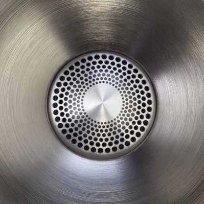

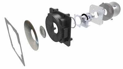

The tweeter is an aluminum driver with a perforated cover of varying-dimensioned holes placed over the diaphragm. They call it a Perforated Phase-Aligning (PPA™) Tweeter Lens. I’d imagine the purpose is to diffuse and mitigate the inevitable resonant peak exhibited by virtually all metal-dome tweeters, leaving the listener with the supposed attributes of a metal dome (“speed” and “detail”), while minimizing the negative aspects of metal diaphragms (audible peaks and “harshness”). The dome/lens assembly sits at the apex of a very shallow horn flare, which presumably is intended to act as a modest waveguide to control dispersion and aid in efficiency over the tweeter’s operational passband.
Tweeter Exploded View
