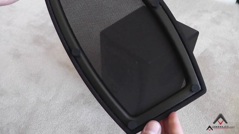

Fortunately, the flawless matte black finish does an admirable job of rejecting fingerprints, dust, and light. Sure, a piano-black, wet-look finish is always a head-turner, but this is a cinema system, and the XTZ speakers still look good while being functional and not directly reflecting light from your display back at your eyes. The magnetic grills are very sturdy, constructed on a nicely-finished wood frame; no rough edges or plastic here. As mentioned, the logos are also magnetic, so you can mount them on the top, bottom, or side of the grill, in any orientation, or leave them off completely.
XTZ S5 Magnetic Grill with Rubber Feet

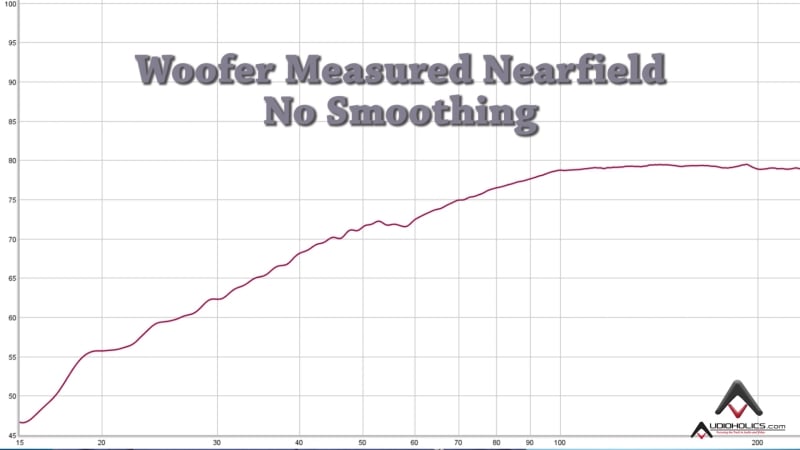

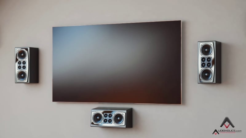

Looking at the main/center M6, you'll see the cabinets are asymmetrical with only two parallel sides. This not only combats standing waves within the cabinet; it allows you to flush mount the speaker on a wall vertically or horizontally using XTZ's optional flush wall mount, and still have a slight amount of toe-in or aiming with the angled front baffle. Of course, you can also use the available matching stands. The M6 also serves as the system’s center channel, and oriented accordingly can have the front baffle and drivers angled up or down towards the listener. These speakers are sealed designs, meaning they don't have any ports that need to be kept away from walls, and the bottom of their frequency response will drop off more gradually. In this case, the low end reaches 75hz +/-3dB, making the M6 perfect to cross over to a capable subwoofer.
XTZ M6 Single Woofer Nearfield Measurement

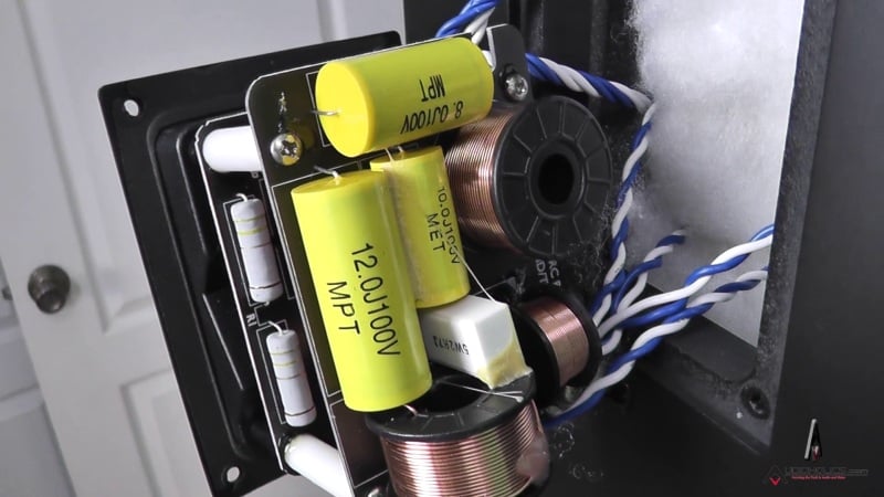

XTZ M6 Crossover and Cabinet Lined with Foam and Stuffed with Polyfill

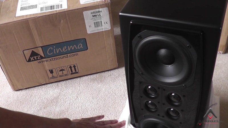

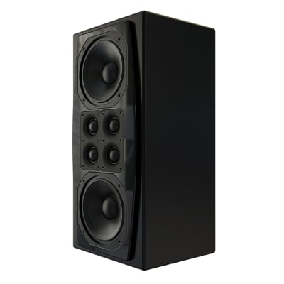

The driver configuration is probably the most unique thing about the M6. There are many speaker designs that feature a single tweeter flanked by two woofers, often called a D'Appolito array, but the M6 have not one, but four, 1” tweeters. I asked Dan Roemer at InterSource OEM which also does business as Claridy Audio, who designed the XTZ Cinema Series speakers together with XTZ, “what’s up with the 4 tweeters?”
XTZ M6 Fresh out of the box with 4 tweeters
Dan detailed a number of potential problems that using multiple tweeters works towards solving. For one, using multiple tweeters shares thermal loads allows for a lower crossover point to the woofer, reducing distortion and beaming of mid frequencies. The crossover frequency is lowered to 1.2kHz, which Dan notes is right around the area below which our brain uses phase to determine directionality, and above which uses amplitude. Where a woofer at 2-3kHz might be very directional, a tweeter can be more omnidirectional, allowing for a more even dispersion in this critical band.
One of the problems in using multiple tweeters in close proximity to one another is that they can cause interference with each other, and that’s the main reason people wrinkle their noses at this approach. However, Dan has a way around that. He doesn’t run all 4 tweeters all the way to 20kHz. Instead, 3 of the tweeters are rolled off at 3kHz, and just one of the domes takes over.

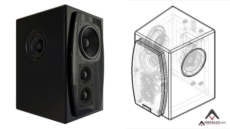

As you’d expect, the design cues from the M6 are carried over to the Hybrid 3 way XTZ S5. The S5 has a similar multi-tweeter design featuring two, 1” tweeters; (both operate from 1.2kHz on up).These are paired with a 4”mid-woofer on the front face, and the non-parallel sides each feature a single, 3” full-range woofer. They are again quite dense at 16.5 lbs and 11 inches tall by 8 inches deep. If you’re looking to hang these on a wall, you’ll definitely want to consider the sturdy XTZ flush-mount bracket.
The XTZ S5 and its versatile 3-array design
With three different wiring configurations, the S5 speakers proved to be a very versatile surround speaker. When it comes to surrounds, some people choose monopole, or direct-firing, speakers for surround use. These offer a very balanced frequency response, but can be easy to localize making all the surround effects sound like they are coming from a single point on your wall. For folks looking for a more diffused sound, where surround effects seem to be coming from the sides and behind you, but you can't tell exactly where, they often choose bipole or dipole speakers. The S5 takes a swing at being the best of all worlds. With various configurations of wiring the 4 binding posts using the included metal jumper/bridge, you can configure the speaker for one of three modes:

XTZ Cinema Series M6 flush-mounted
