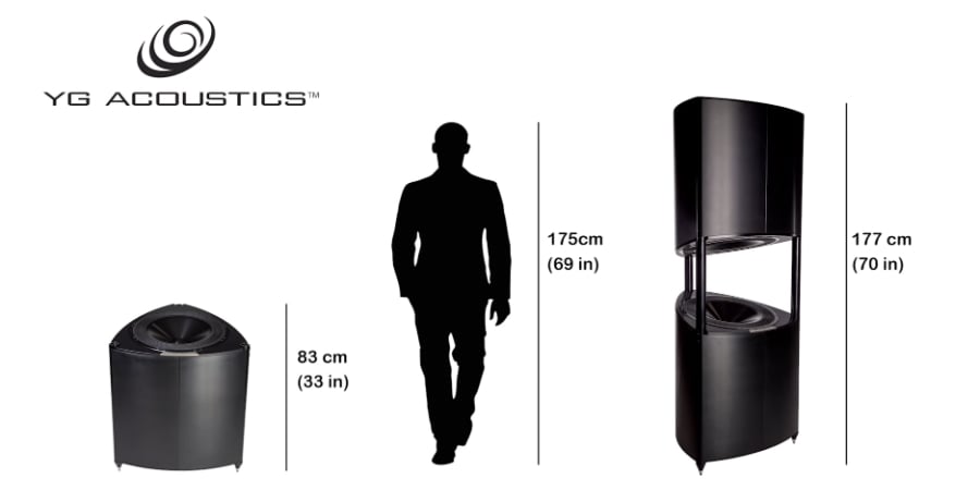

  • Drivers: Dual 21” CNC machined aluminum cones
  • Frequency response: Truly full output (-0 dB), even anechoically, to below 20 Hz. Usable output extends below 15 Hz
  • Amplifier Power: Up to 6,000 watts RMS (requires a 230 Volt AC hookup, otherwise 3,000 watts)
  • Dimensions (H x W x D): 70 x 27 x 27 inches
  • Weight: 462 lbs

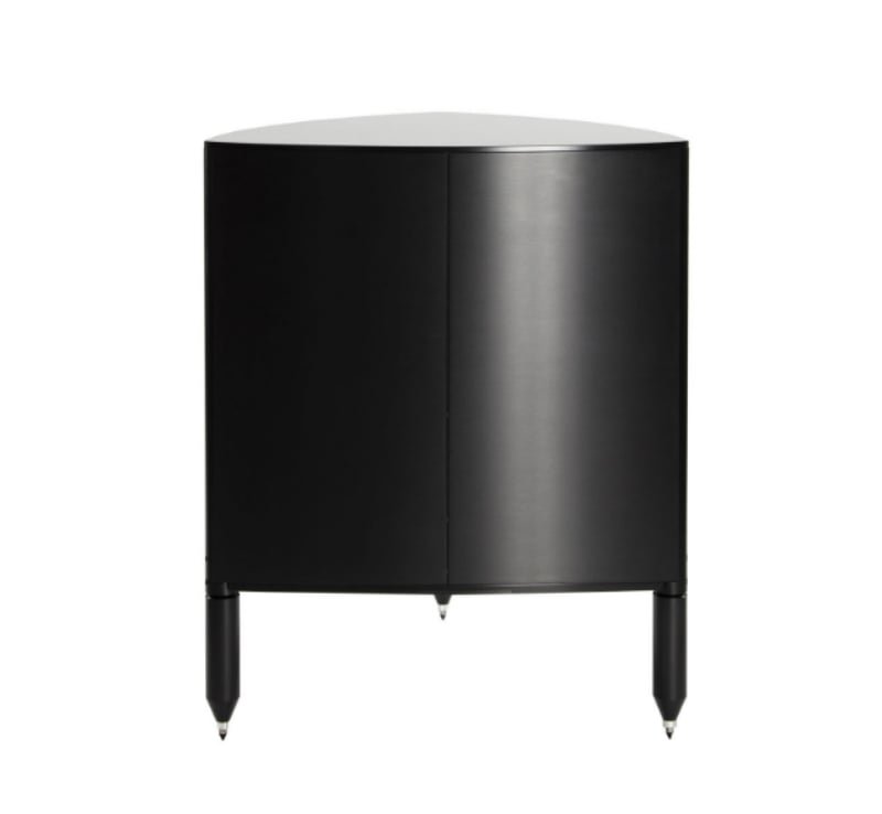

YG Acoustics has made some of the world’s best loudspeakers for 15 years now, but the InVinYG InVincible 21.2.jpgcible sub is unlike anything the Colorado-based company — or anyone, really — has ever produced. YG says the InVincible sub is:
the world’s first hyper-high-end sub-bass speaker,” created to be “a truly extreme solution, a no-holds-barred assault on everything deemed possible in the sub-bass realm.”
According to YG, many owners of the company’s flagship speakers wanted to add subwoofers to their systems, but found that doing so came with serious drawbacks. We’ve all heard systems in which the bass simply can’t keep up with the higher frequencies, and this problem can be even more apparent in highly resolving systems. In order to create a sub that could go toe-to-toe with the best speakers from YG and its high-end competitors (such as Wilson, Magico, and Rockport), YG’s designers began by developing a new 21-inch BilletCore driver, which is machined from a single, massive slab of aircraft-grade aluminum. After more than five hours of CNC machining, a 14.5-ounce cone is all that remains of the 66-pound slab from which it was delicately carved. The 21-inch driver is only 0.6mm (0.024 inches) thick, yet is reportedly far more rigid than any competing design. According to YG, the CNC-machined basket is “precisely assembled from 238 parts using lab-grade alignment and tolerances.”

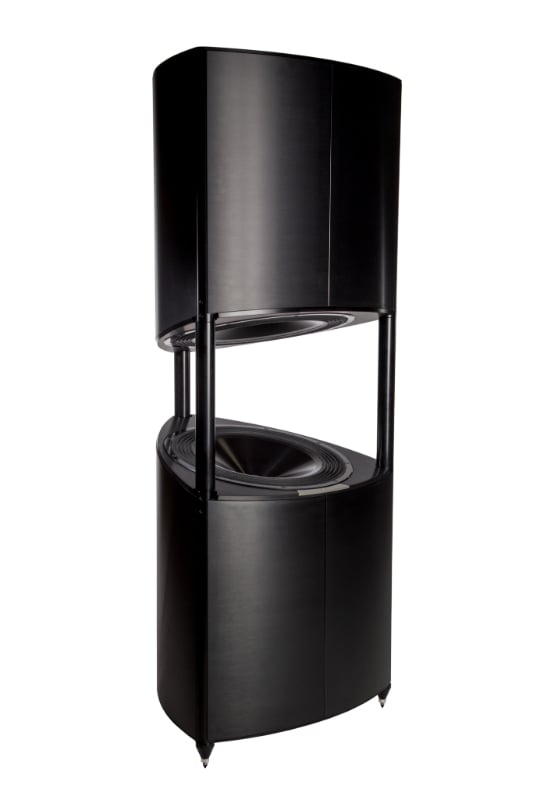

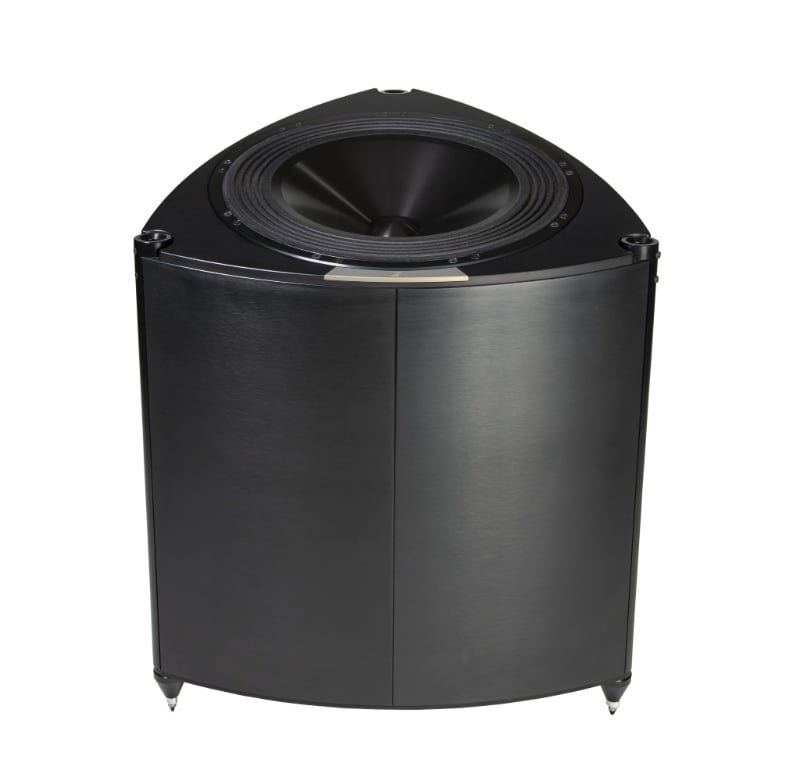

Doc BrownThe InVincible 21.2 sub uses two of these huge drivers in a dual-opposing, push-push setup. Each driver sits in its own enclosure, and is tilted at an angle that YG says improves the ease of room-integration by approximating the dispersion of a front-firing driver, while delivering the vibration-cancelling benefits of a push-push setup. The drivers are powered by a custom, American-made class D amplifier that provides up to 6,000 watts RMS (iyou're going to need a custom wall outlet to deliver anywhere near that power). Like YG’s flagship Sonja loudspeakers, the InVincible sub uses a “box within a box” cabinet design to minimize vibration. The sealed cabinet is CNC-machined from solid aluminum billet, and stands 5’10” high. The cabinet also features a YG technology called Focused Elimination, which relies on precise, sophisticated geometries to eradicate standing waves with less loss (i.e. less friction) than traditional stuffing and damping methods.
According to YG, the result is “a quick reaction-time, freedom from boxiness, and a tight, punchy bass.”
The InVincible sub uses an advanced DSP-based crossover, allowing it to blend with most high-end speakers in two-channel or surround sound setups. The DSP design was inspired by YG’s exclusive Dual Coherent technology, which ensures that the crossover is coherent in both the time and frequency domains. The user can select whatever crossover frequency works best, but the guesswork is eliminated for owners of YG speakers, thanks to pre-programmed settings for all current YG loudspeaker models, as well as for many legacy models. Like YG’s Sonja loudspeakers, the InVincible sub is modular, and is therefore available in two single-driver, single-enclosure configurations, either of which can be upgraded to the larger, dual-driver flagship design described above. The InVincible 21.1 is the upward-firing single-driver configuration; it is basically the bottom half of the dual-driver InVincible 21.2 configuration. The 21.1i is a downward-firing version of the single-driver configuration. It is designed for high-traffic installations where the user does not feel comfortable leaving the driver exposed. Because the 21.1i has a flat top surface, it can also double as a stand for the center channel speaker in a surround application. Both single-driver configurations sell for $55,000 each.
