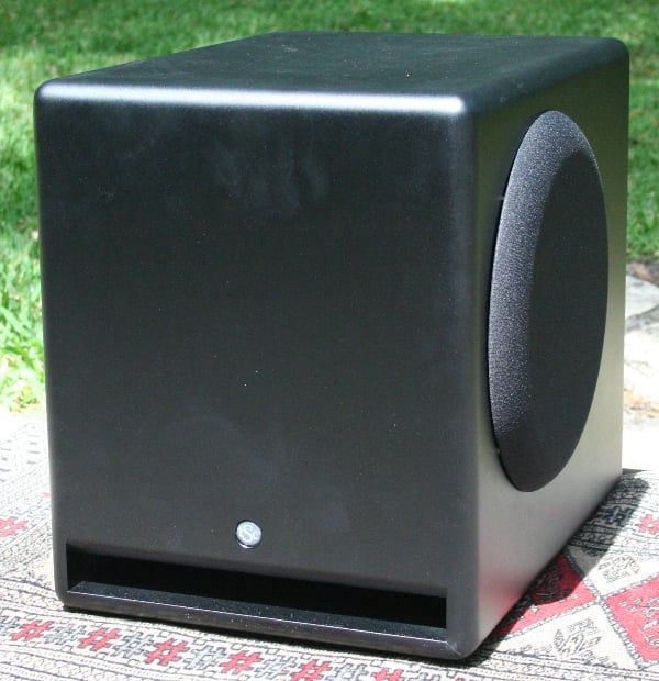

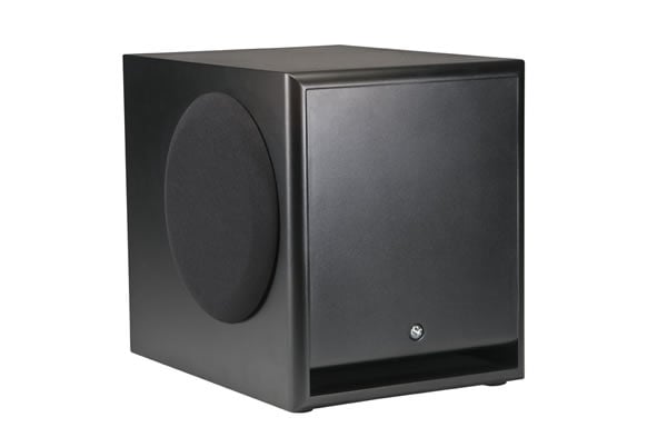

The T300 isn't especially large (a plus for placement and moving around). It is only 14 1/2” wide and 18 1/2" deep. The depth is really the only dimension that should give consumers pause. As always, when buying a subwoofer online, construct a box out of cardboard of the same dimensions and make sure it will fit your space. The T300 features a flat black, slightly textured finish and rounded corners. The stock picture on the website shows a seam on the front but the review unit did not - the front face was smooth. There are two side firing (one from each side) woofers and a front firing slotted port. The bottom has pre-attached rubber feet which are fairly short. There are no provisions for carpet spikes.
The

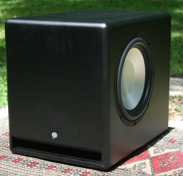

T300 weighs in at a paltry 36lbs. While this isn't the lightest sub you're
going to come across, it does make it very easy to move around. There are two

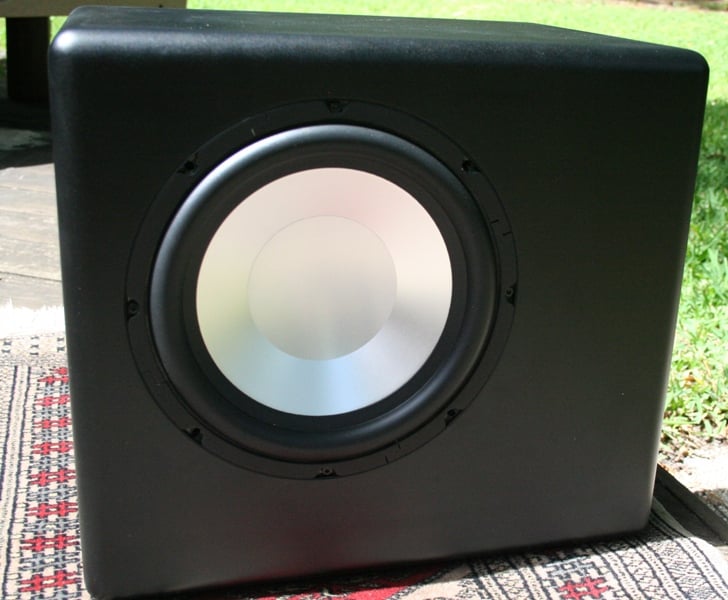

side-firing 10" aluminum drivers, a front slot-style port, and a rear
mounted amp. The grills are actually mounted through four of the holes that
would be used for mounting the drivers. This leaves four (instead of eight)
connection points for the driver to the enclosure. My first concern was that
those holes might be predrilled and allow extra avenues of escape for air other
than the front port. I did multiple tests during playback and found no evidence
that any air was escaping any of the holes.
The grills fit snuggly but not tightly. This means that they won't be falling off on their own but they also won't resist the prying of curious little fingers. The front slotted port is wide but unobtrusive. In fact, if I had to describe the T300 in a word, I'd say it was unobtrusive. The flat black blends well with the shadows and the overall look doesn't exactly draw the eye. It does pick up fingerprints fairly easily but they aren't easy to see in a darkened room. The driverless front of the T300 should get most the credit. However for those that like to see their subwoofer work during those intense action scenes, you'll have to turn the sub or just make due with what you can see of the rubber surrounds moving.

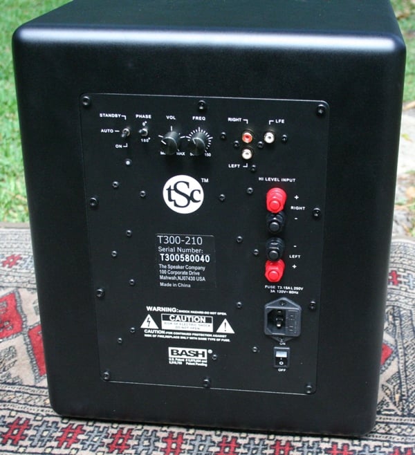

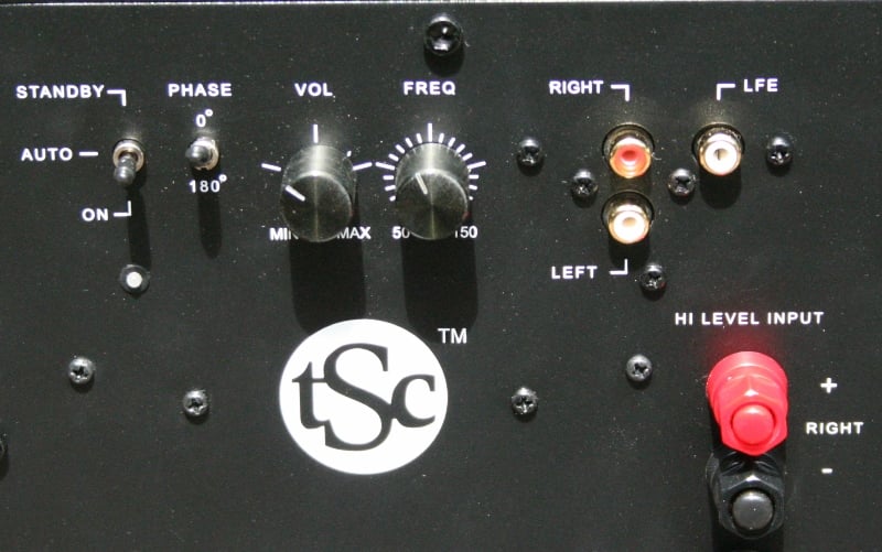

The amp sports 300 watt Bash Class D amplifier and all the usual
connections and controls. Variable volume and crossover control (50-150Hz) are
present. Phase switch (0-180 degrees), stereo RCA and LFE inputs and high level
inputs also there. One thing I wasn't expecting was not only a Standby/Off
switch but also an On setting for those (like me) that don't trust auto-sensing
functions.

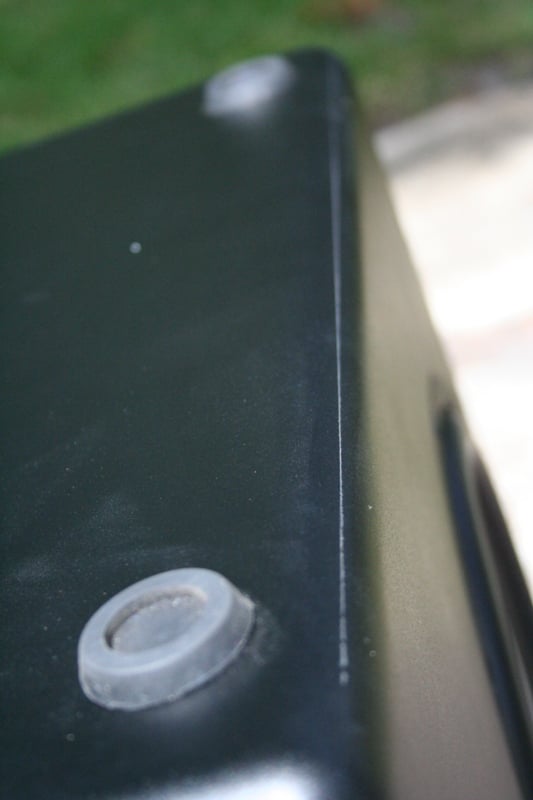

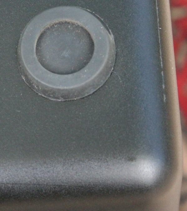

The only fit and finish issue I found was a bit of a crack along the bottom of the box. It was right along the edge along the side at the bottom. While this particular imperfection was invisible to the owner, it might indicate a systemic problem. New owners should be aware and check out their new purchase thoroughly. With free return shipping and a 30 day trial, this shouldn't deter any potential buyers.

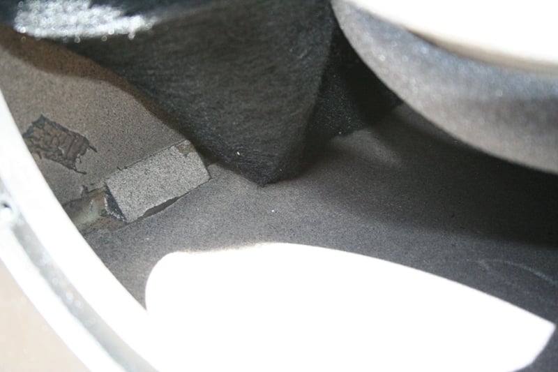

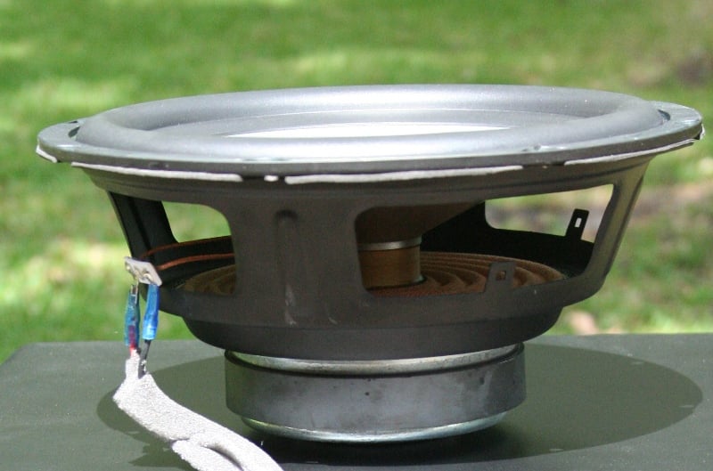

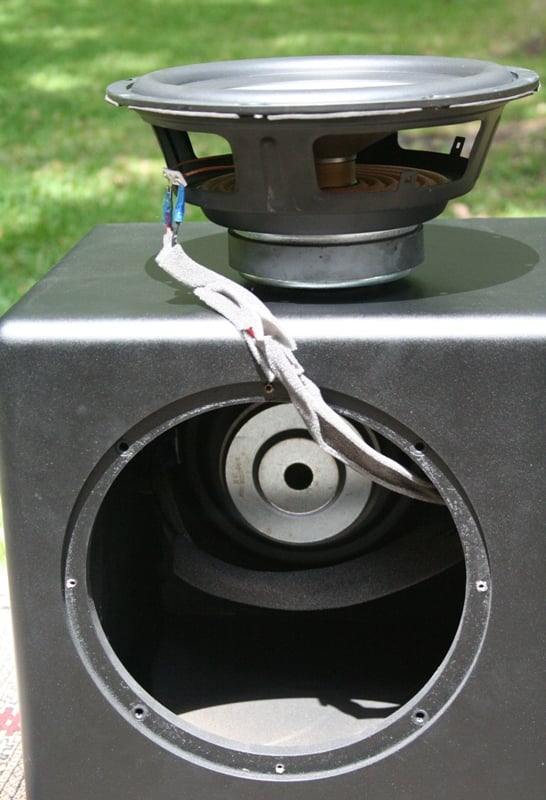

Opening up The T300, we see two drivers in a 3/4" MDF enclosure. The drivers sport stamped rather than cast baskets which is probably not unreasonable considering the price. The drivers also aren't magnetically shielded so you'll need to keep the sub away from any legacy CRTs or other magnetically sensitive equipment. The cabinet has modest stuffing and only a minimal reinforcement at the corners. One thing I was really impressed to see was total dampening of the internal wiring. Each wire was covered with foam tape so that any possible internal noise would be eliminated. A really nice touch at this price point.

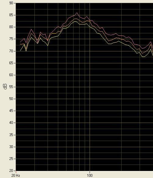

T300 Measurements and Conclusion
For laboratory measurements I used the Sencore SP395A FFT Audio Analyzer. Placing the subwoofer outside, I did groundplane measurements at 1 meter. During the test, when pushed hard I noticed some chuffing from the port and a bit of rattling from the amp.
