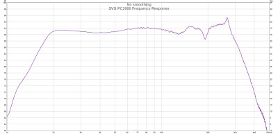

PC2000 SVS pic.jpgThere is a lot to like about the PC-2000. Its two greatest distinctions are the light weight and the very clean and linear performance. I would bet that with respect to deep bass in the 16 to 30 Hz range, the PC-2000 might be the market champion in a performance vs. weight and footprint ratio. You might think to yourself that weight is not a big deal in a sub, and that it is something too seldom dealt with to be a serious advantage since subs are mostly just plopped down in a corner and left alone. However, allow me to make a case for the usefulness of light weight in a subwoofer. Yes, many times the subwoofer is simply plopped into the corner and left alone, but a reason why it is not often moved afterward is because of the weight: it is a daunting task to move around a 70+ lbs object, so we will tend to find reasons not to. The PC2000 is different, because moving it around is a cinch. It is very easy to pick up and its small footprint allows it to be placed in many more spots than most subs. The relative mobility of the PC2000 holds a real set of advantages: it is easier to find the optimal location for the sub, it is easier to adjust the low frequency response for specific listening positions since it’s so easy to move the sub and thus change the response, and its portability makes it a simple matter when moving homes, selling, or just bringing it over to a friend’s place to demo.

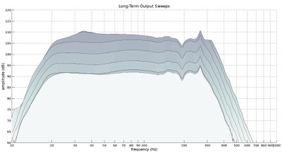

Speaking of demoing a sub, the PC-2000 is a good choice for that, since it has a combination of very good performance and excellent built-in protection against very rough use. The Sledge amplifier does a great job in shielding itself from overheating and protecting the driver from over-excursion. Some of the testing we did on the PC2000 is the most difficult that can be given to a subwoofer: continuous, high signal level sine-waves. In the multiple times that we took it out for testing, not once did we bottom the driver, even when pushing it as hard as we could. This is more than we can say for some other subs we’ve tested, which we managed to produce that cringe-inducing hammering sound, where we prayed the driver still functioned afterward.

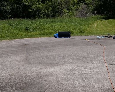

There was just one instance in running a battery of repeating CEA-2010 bursts where the amplifier overheated. The subwoofer had been subjected to prolonged heavy-duty test tones and the plate amplifier had been left in a position where it was directly exposed to the sun on a warm, cloudless day, so this was a worst case scenario. Instead of dying from excessive heat, the amplifier was smart enough to switch itself off, which was indicated by the blinking status light. After 20 minutes or so, it had cooled enough to begin operation again. A less sophisticated amplifier might have run itself into a heat death. What these layers of protection add up to is that you can really crank the PC-2000 and not have to worry about damaging it. However, as we mentioned before, you do not want to leave it or any subwoofer running at the edge of its performance limits in regular use, because that surely will kill it eventually.

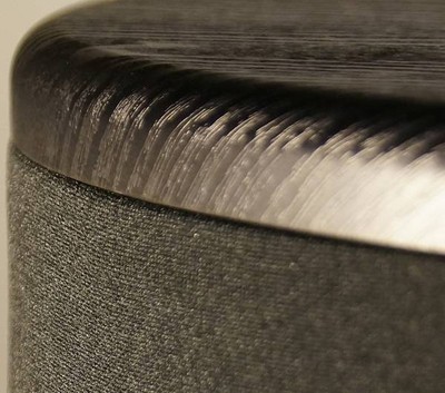

The shape and appearance of the PC2000 will doubtlessly be a liability to some subwoofer shoppers. However, if one isn’t put off by its appearance,bassaholic-master-large.jpeg there is no reason to go with its more traditionally-styled PB2000 sibling. The PC-2000 has all the performance of its box-shaped counterpart yet has a much smaller footprint and lighter weight; in other words, all the advantages without the disadvantages. The PC-2000’s good CEA-2010 showing nets an Audioholic’s Bassaholic Large Room rating, signifying that it should be able to provide satisfying bass levels in rooms of 3,000 cubic feet to 5,000 cubic feet (read about our Bassaholics Room Size Rating System). If you can afford it, I would still go for multiple subwoofers, regardless of room size, for the sake of smoothing out the low-frequency response. The extra dynamic range doesn’t hurt either, and the small footprint makes it easier to fit multiples, which is certainly an advantage in small rooms.
