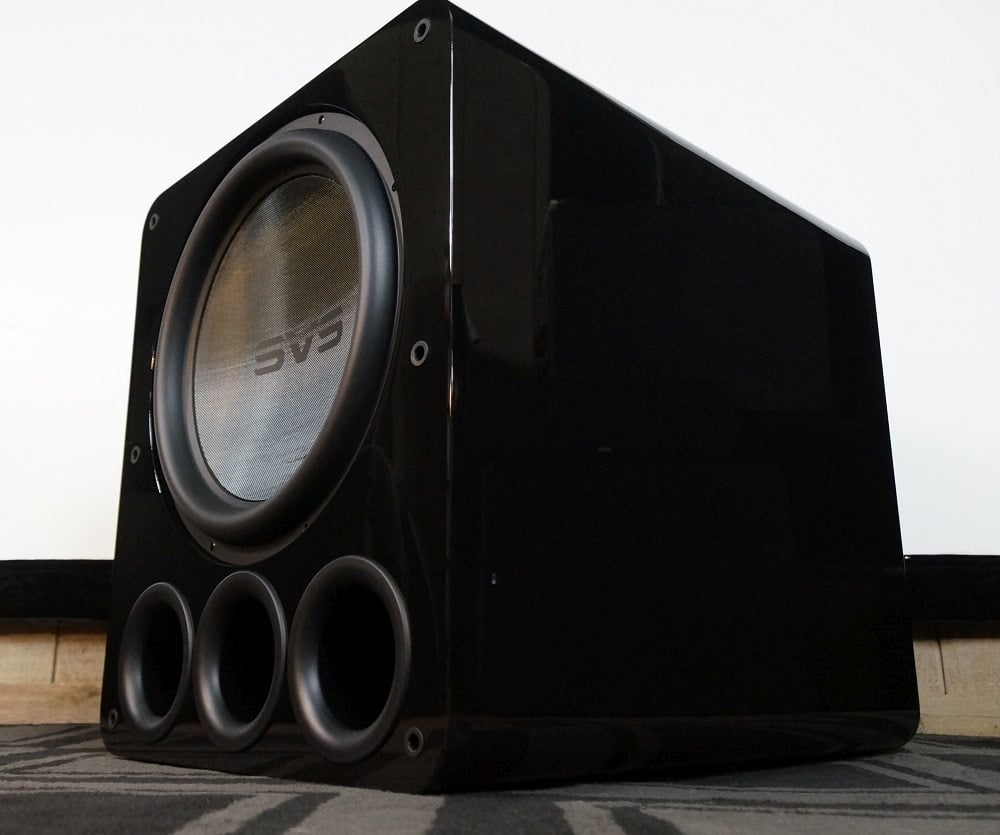

As we will talk about in our design analysis, the PB17-Ultra makes some major improvements over the outgoing model. It has a larger driver, more powerful amps, and new DSP features. SVS claims it's a ground-up redesign, but it still has similarities to its predecessor, and that leads to the question: is this really a ‘revolution’ or is it merely an ‘evolution ’? Let’s now dive in to find out…
SVS PB17-Ultra R|Evolution Subwoofer Packing and Appearance

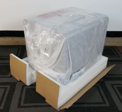

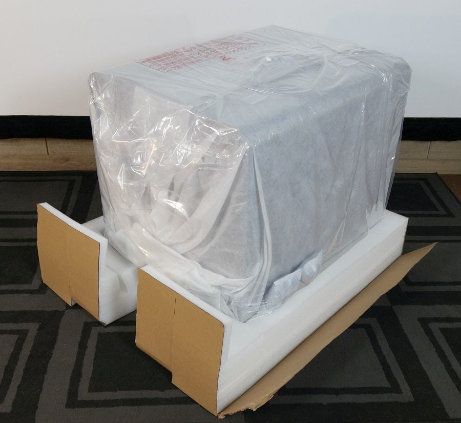

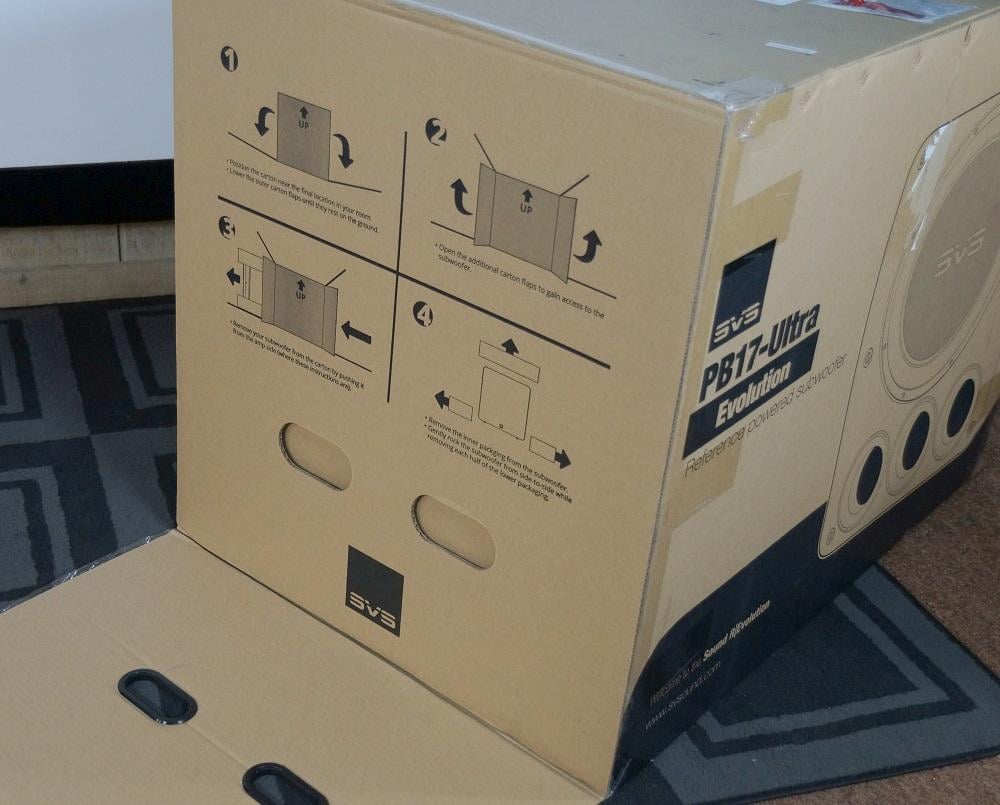

SVS has always had some of the most intelligent packing in the business as far as large subs go, and the PB17-Ultra does not depart from this practice. In fact, the packing is largely the same as the PB16-Ultra’s, a very good thing indeed, since that was the easiest large sub that I have had to unpack. A heavy-duty exterior box contains an interior package that slides out, after which, two lower pieces that hold the sub up can be slid out from under it, and the sub can be gently lowered into place. The sub does not have to be lifted out of any packing at any point, an achievement for which the buyer’s back will be thankful. The sub is covered by a cotton sleeve to protect it from scuffs and scratches, and the cotton sleeve is covered by a plastic bag to protect it from moisture.

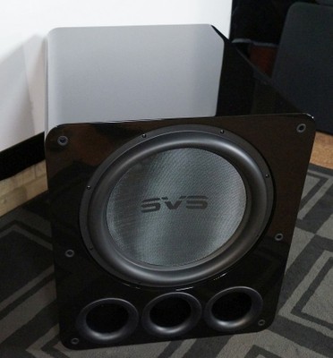

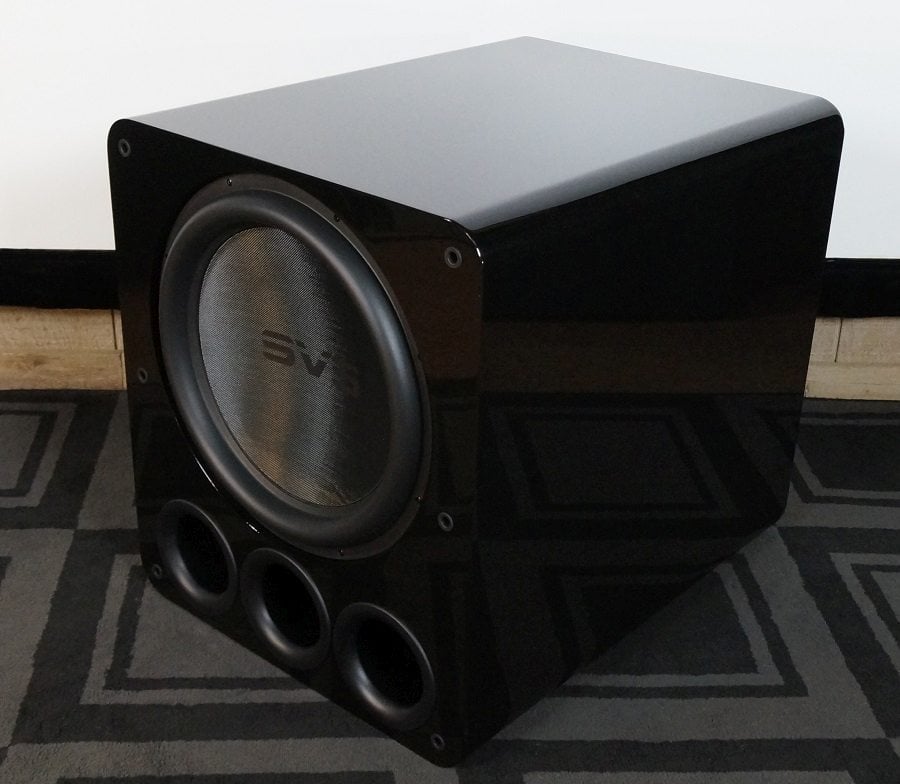

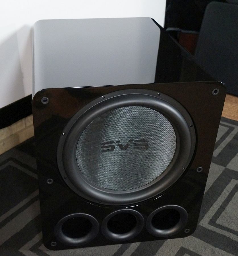

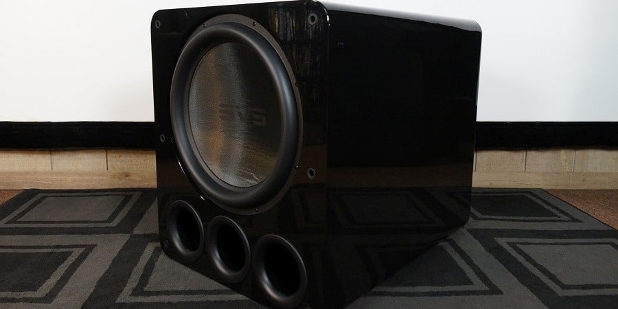

Once unpacked, the PB17-Ultra is revealed to be a handsome if somewhat daunting block of a sub. It can be had in either black oak or gloss black, and I received the gloss finish. It’s a huge subwoofer, and the fine finish does go a long way toward making it palatable, but it can’t hide the sheer size of the unit. The lengthwise edges are rounded, which helps to soften its appearance. As with the PB16-Ultra, the PB17-Ultra has a front-mounted glass fiber laminated cone with a reflective sheen and ‘SVS’ imprinted in the center. Underneath the cone are three flared ports. A grille is provided to cover the front baffle if you want to hide the cone and ports for some reason. The grille is just some black fabric draped over a plastic frame. It does mute the sub’s appearance somewhat, but it also makes the sub look less interesting. Overall, SVS has made the PB17-Ultra about as nice as a large oblong box can be made to look. Some people will object to it based on the size, but if you can get past its size, there is nothing to complain about regarding its styling.

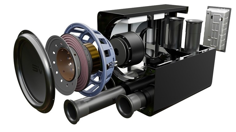

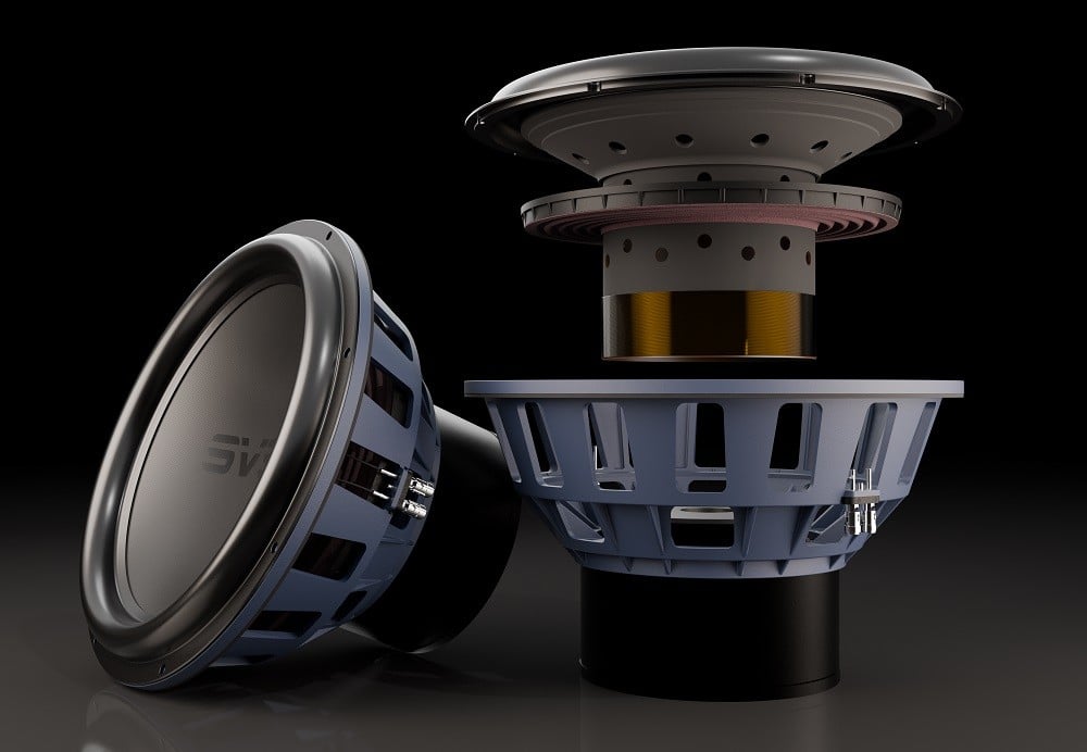

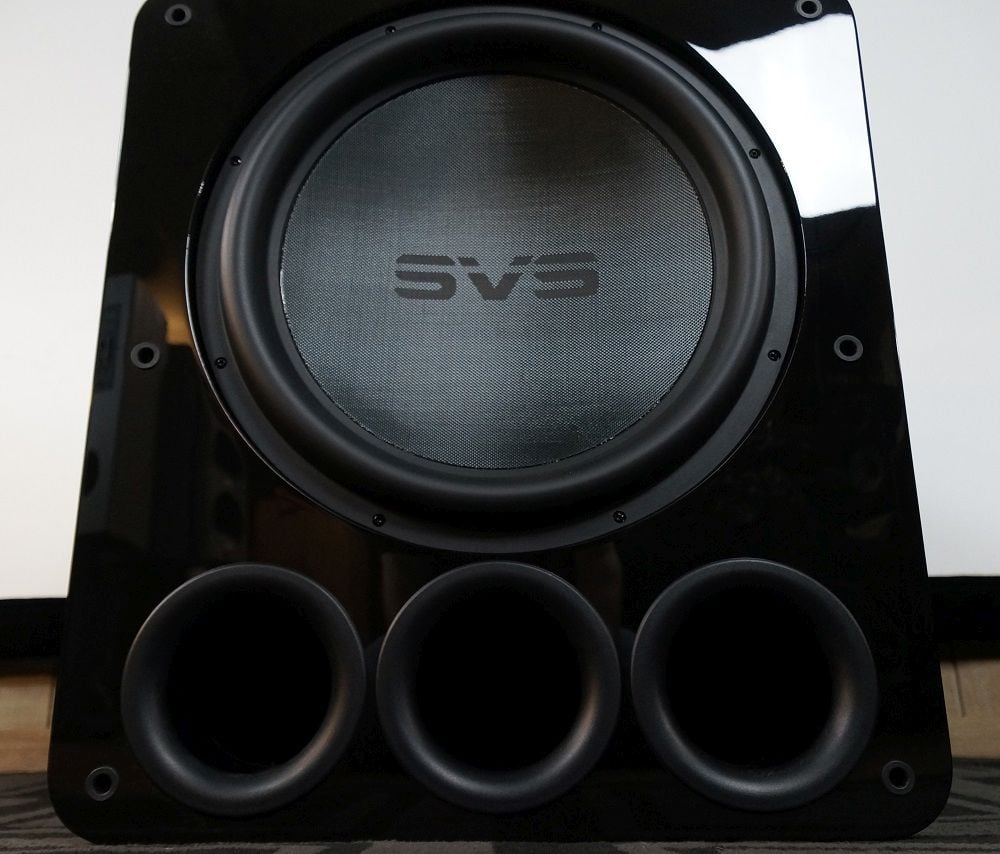

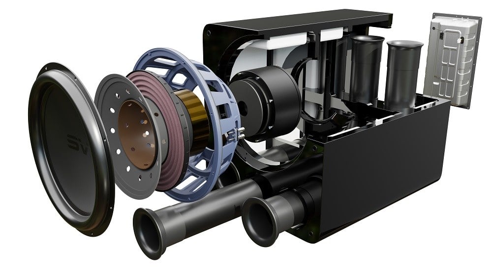

Let’s start our discussion of the PB17-Ultra by talking about its driver. As denoted by the name, the PB17-Ultra uses a 17” driver, but that is only measuring from the outer diameter of the frame edge. The cone itself is not that large. Cone diameters are usually quoted from the middle of the surround, and in this case, the cone diameter is a bit short of 15”. Most subwoofer manufacturers use the frame edge diameter specification in their literature, not the actual cone diameter specification. As with the PB16-Ultra, the PB17-Ultra uses an enormous 8” voice coil, but one difference is that they have split it in two, so the PB17-Ultra now has a dual voice coil system. Two voice coils allow more options in how the driver is powered, and SVS takes advantage of this by using two amplifiers, but they don’t just use each amp to power one coil. Rather, they utilize bridge-tied load (BTL) amplification so that both channels are powering both coils. One amplifier amplifies the positive phase signal, while the other amplifies the negative phase signal, effectively doubling the voltage compared to using just one amplifier channel. BTL amplification can theoretically achieve four times the output power compared to a traditional single-ended configuration.
The
coils wrap around the permanent magnet, which is a 54-pound chunk of ferrite,
and that should give it a tremendous level of magnetic force. The coil uses an
overhung configuration as opposed to the PB16’s underhung configuration, and
that should give this new driver more sensitivity in higher frequency bands.
Suspension consists of dual Nomex spiders and a half-roll styrene-butadiene
rubber surround. A lot of attention had to be given to the suspension
components to keep linear movement over a wide throw. SVS claims the PB17-Ultra
driver has a 48.9mm Xmax. I find that figure difficult to believe except in
certain specific senses such as a Bl measurement, although I have no doubt this
driver has a very long linear throw. The driver also uses two shorting rings to
help maintain linearity. The basket is a beefy powder-coated cast aluminum
structure that should be able to endure high excursions from the moving
assembly with ease.

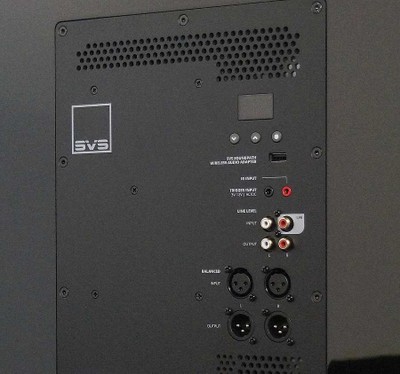

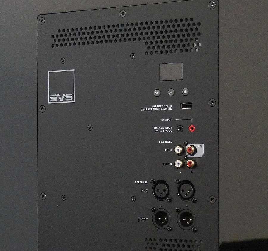

In terms of amplification, SVS has backed the driver up with 2,800 watts of RMS power. The system looks to be designed to pull as much current as can be had from the standard 15-amp circuits of North American homes. SVS uses a class-D amp with a switching-mode power supply — a very efficient design. Efficiency is absolutely needed to convert as much power as possible from a 15-amp circuit into sound for the kind of performance targets that SVS is aiming for. In my review of the PB16-Ultra, I remember that unit being able to dim my lights at high drive levels, effectively maxing out what that 15-amp circuit could deliver. So, in order to get more output, SVS had to look at higher efficiency rather than just brute force power draw, or else they would risk tripping the breakers of typical residential power circuits.
The
two mono amplifiers use eight 60A 200V MOSFETS. The amplifiers are arranged in
parallel per rail for higher output current. Power draw is constantly monitored
in real-time via Power Factor Correction with an onboard line conditioner,
thereby allowing the amplifier to draw as much power as it needs without
overwhelming a 15-amp circuit. The system is controlled by a 290Hz Analog
Devices Audio DSP chip, and that should be more than sufficient for any
processing on the signal, as well as monitoring power conditions. Connectivity
is comprised of a pair of XLR inputs and outputs and a pair of RCA inputs and
outputs. The XLR inputs and outputs are especially nice for those who want to
incorporate the PB17-Ultra into more upscale home theaters or even pro-audio
setups. The amp panel also has a 3.5mm trigger and a USB power source for easy
integration of the SVS Soundpath Wireless Adapter. Basic functions can be
operated by a small OLED display on the amp panel with some selector buttons.
Advanced functions have to be operated through SVS’s Subwoofer Control
Smartphone app.
To me, relegating all but the most basic controls to the app is a problem. So much can go wrong on the software side that I am sure there will be more than a few instances of the sub simply not being operable by some phones. Also, in the long term, what if SVS does not or can not keep the software updated to work in future software environments? In that case, so much of the feature set of the subwoofer would simply be lost.
We have covered the many features of SVS’s Subwoofer Control app many times before, so we won’t go over all of that again, but rather we will mention a new feature that SVS promises but has not yet released as of the date of this writing: the Subwoofer Auto Room Equalization. Supposedly, this feature will use the Smartphone’s own microphone to take in-room measurements. It is an interesting idea, and I suppose one way to do that is to calibrate the phone with the sub itself in a near-field measurement. That is just a guess, though. We will hopefully evaluate that feature when it is released.

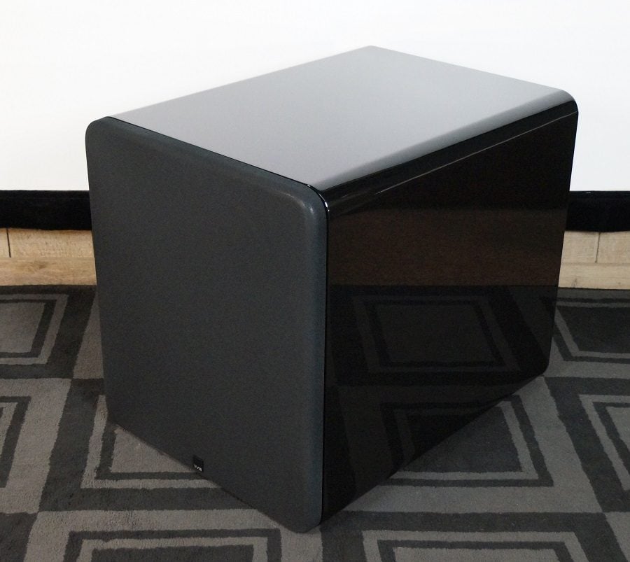

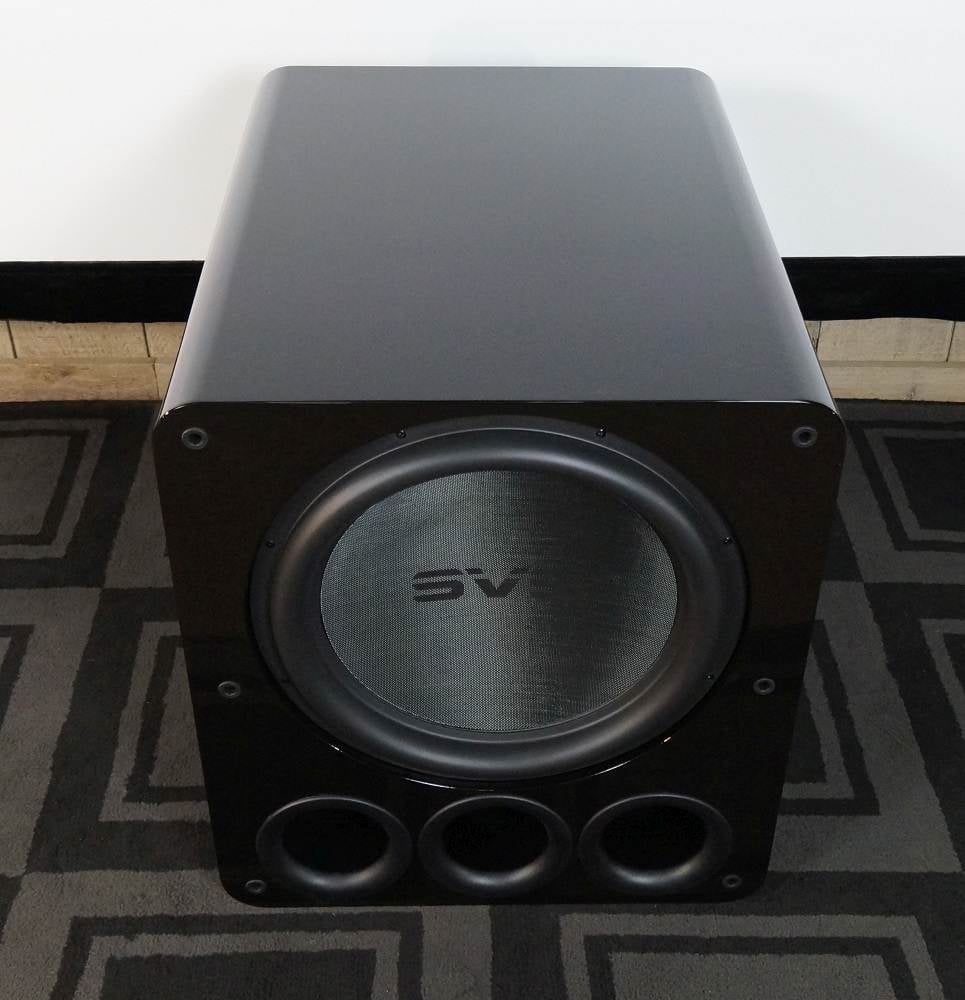

The enclosure has a boulder-like solidity (and weight). Side panels look to be about 1” thick, with the front baffle being 2” thick. With an all-MDF construction, that will constitute the bulk of the weight of this 167-pound subwoofer. The interior is lined with acoustic stuffing. There are three ports with a 4” diameter that stretch way back in the sub and take a turn upwards. Such long ports with a 4” diameter promise some seriously deep bass. Like its predecessor, the PB17-Ultra has variable-tuning capability, so one of the ports can be sealed to lower the port tuning frequency and thus the low-frequency extension that the sub is capable of. Additionally, users can seal all of the ports to turn the PB17-Ultra into a sealed subwoofer, but, in my opinion, that would be inane. What is the point of buying a gigantic ported sub just to neutralize port output? The reason this sub is so big is for port output. If you want a sealed subwoofer, get the SB17-Ultra. SVS claims a response window of +/-3dB down to 12Hz when configured for extended mode and 14Hz for standard mode. That has to make this the most deeply tuned mass-produced subwoofer in history. There are other subs that can be bought with extremely deep tuning frequencies, but none that you can just walk into a store and buy. They have to be ordered from smaller manufacturer-direct subwoofer companies, and then there is a wait period for construction and delivery.
One unfortunate carry-over from the PB16-Ultra is the feet. They were too small for that model, and SVS has opted to use them again in the PB17-Ultra. They do not give your fingers much clearance if the sub has to be lifted and set down, barely half an inch. That can be a problem for a subwoofer of this weight, especially if the sub is being lowered onto dense carpeting. Users should not underestimate the task of lifting or carrying this sub. It’s a two-person job at the very least, and those two people better be in good shape. If being carried over stairs, a dolly is a must, whether a shoulder-strap dolly or a wheeled dolly. Anyone who decides to order the PB17-Ultra would do well to carefully consider the logistics of safely getting it into place.

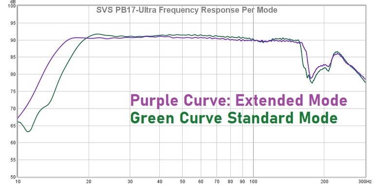

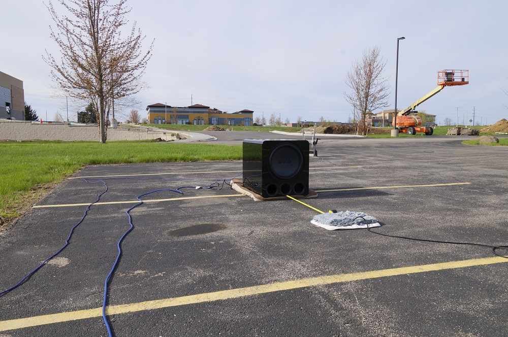

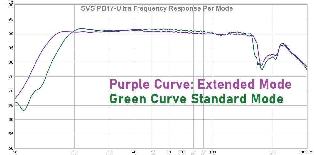

Testing on the SVS PB17-Ultra was conducted with the microphone facing the woofer at a 1-meter distance with measurements scaled back to a 2-meter distance by subtracting 6dB. The temperature was recorded at 60°F with 80% humidity. The subwoofer’s gain was set to maximum; the phase was set to zero, and the low-pass filters were set to bypass.
The above graph shows the measured frequency responses for the SVS PB17-Ultra subwoofer for standard and extended operating modes. Standard Mode was tested with all ports open, and Extended Mode was tested with one port sealed. As we have seen so often in SVS subs, we get a ruler flat response. This is nice, of course, but readers should understand that room acoustics will mutilate this picture-perfect response once the sub is in place. It’s still worth pursuing a flat response since it makes for more predictable behavior for multi-subwoofer setups. We can see that the Extended Mode digs a bit deeper than Standard Mode and looks to extend the knee of the response about 3Hz deeper. But there are no free lunches in audio engineering, and the catch of that extended response is less port output. By removing one of the three ports, the port output should be similarly reduced by a third. However, this sub is so powerful that it is probably a worthwhile trade-off for most users since they aren’t likely to hit the limits of this beast.
SVS claimed a response window of +/-3dB of 12Hz to 220Hz in Extended Mode and 14Hz to 220Hz in Standard Mode. That isn’t quite what we see in our measurements. I would characterize what we see as closer to 14Hz to 170Hz in a +/-3dB window for Extended Mode and 16Hz to 160Hz in Standard Mode. That still makes for a very deep-digging subwoofer, and the in-room response will dive down well into infrasonic frequencies.

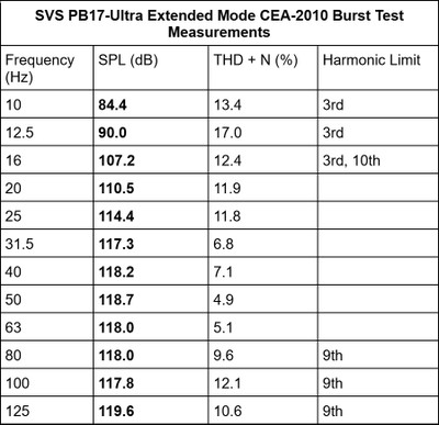

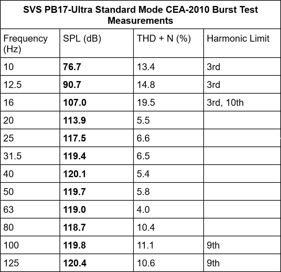

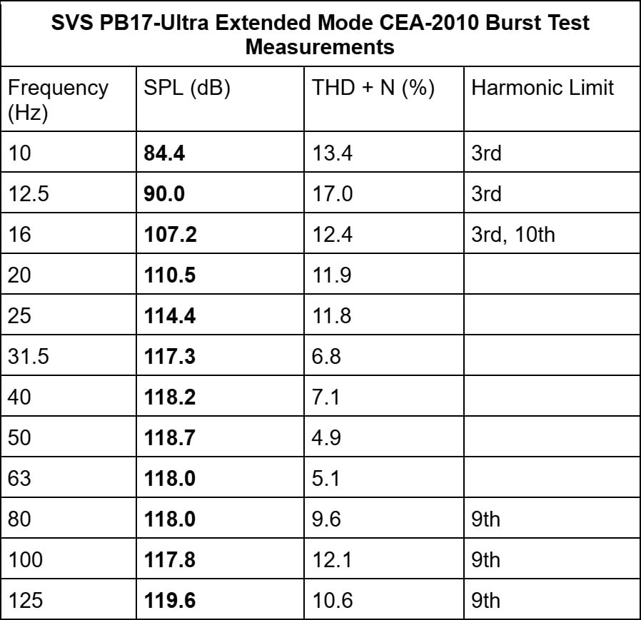

The above CEA-2010 measurements are short-term bursts that show the subwoofer’s clean peak SPL before heavy distortion sets in. Our measurements have been referenced to 2-meter RMS, which is 9dB down from the standard requirement for the measurements to be shown at 1-meter peak. However, most publicly available CEA-2010 measurements are shown at 2-meter RMS, so we followed that convention.
The above table of burst measurements is for the PB17-Ultra in Extended Mode. These are some pretty tremendous results. 107dB at 16Hz and 110dB at 20Hz is an earthquake in a box. And an average of 118dB at 31Hz and above is brutal mid-bass power. What is interesting is to see how this sub compares to our results from its predecessor, the PB16-Ultra. While we weren’t able to get a passing result from the PB16-Ultra at 10Hz, we did with the PB17-Ultra. When comparing both subwoofers in standard mode, the PB17-Ultra has nearly a +10dB output advantage at 16Hz, almost +3dB at 80Hz, and +6dB at 100Hz over the PB16-Ultra. This means it’s not only more capable in the infrasonic range but also delivers stronger mid-bass slam too.

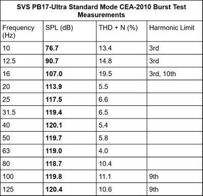

The above table shows our CEA-2010 burst results for the PB17-Ultra in Standard Mode. Again, we see monster SPLs being produced by the subwoofer across the board. Oddly, the deep bass output of Standard Mode seems to be on the level of Extended Mode. However, Standard Mode isn’t quite as clean in terms of distortion when pushed to the edge in those lowest frequencies, and that is not surprising.
Regarding mid-bass output, I was skeptical when SVS claimed they had gained up to 7dB more output in mid-bass versus the PB16-Ultra, but their claim really does pan out in both of the tested operating modes. One of my criticisms of the PB16-Ultra was that its mid-bass output could not keep up with its deep bass output, but SVS has solved that problem entirely. This allows a higher crossover frequency for PB17-Ultra users with the assurance that its mid-bass punch will match its deep bass rumble. Bravo SVS! Either operating mode of the PB17-Ultra earns our Bassaholics ‘Maximus’ Room Rating, meaning it should be able to handle a room of over 6,500 cubic feet. It is only the fourth subwoofer that we have tested that was able to accomplish this feat. To learn more about Audioholics’ Bassaholics Room ratings, please look at this article: Bassaholic Subwoofer Room Size rating Protocol.

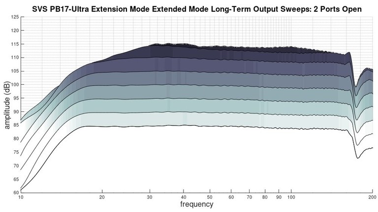

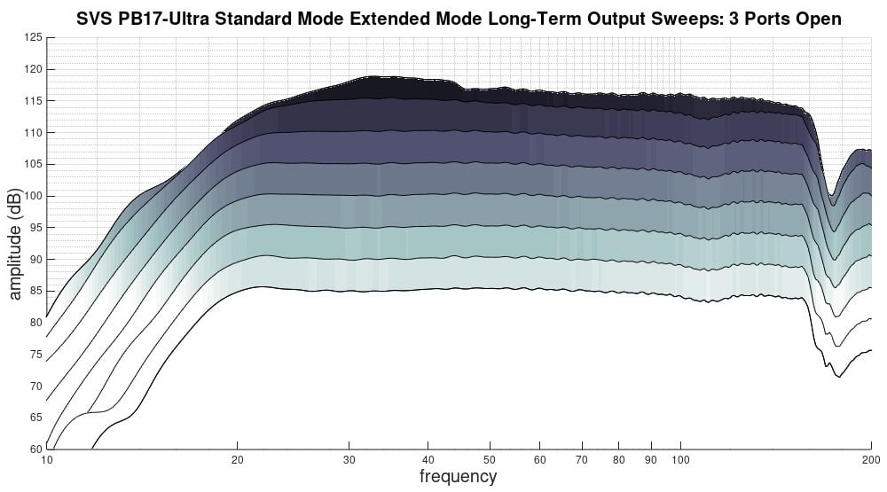

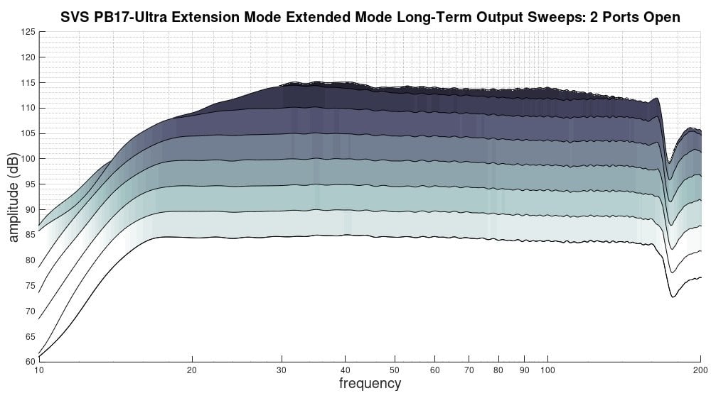

Testing for long-term output compression was done by first conducting a 20-second sweep tone where 50Hz hit 90 dB with the subwoofer 1 meter from the microphone (graph has been scaled to 2 meters for easy comparison with our other review measurements). We then conduct further 20-second sweeps by raising the gain by 5dB until no more output can be wrung out of the subwoofer. These tests show us the long-term continuous headroom that the subwoofer is capable of.
These are terrific results from the PB17-Ultra. It holds its ruler flat response until the last 5dB of headroom, where it starts to compress port-generated output just a bit. This happens in both modes. Not surprisingly, it does have a bit more overall headroom in Standard Mode than Extended Mode, although Extended Mode does have an edge in deep bass below Standard Mode’s port tuning. Both modes are scraping up against 115dB of continuous output. That is some pretty pulverizing bass.

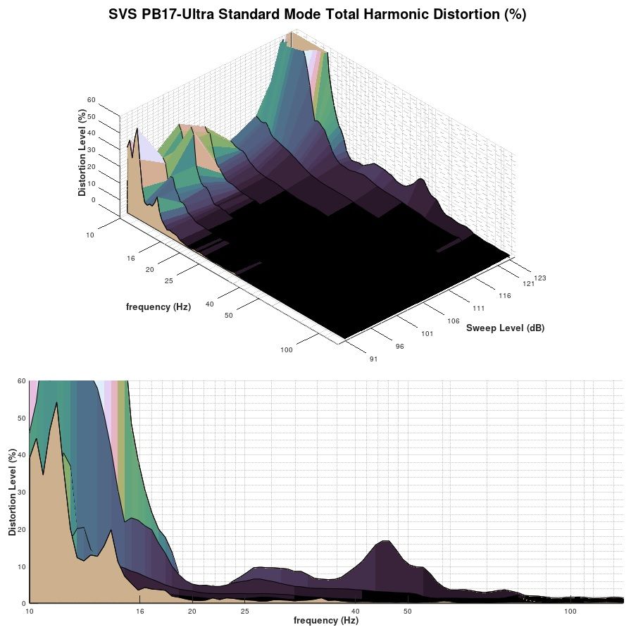

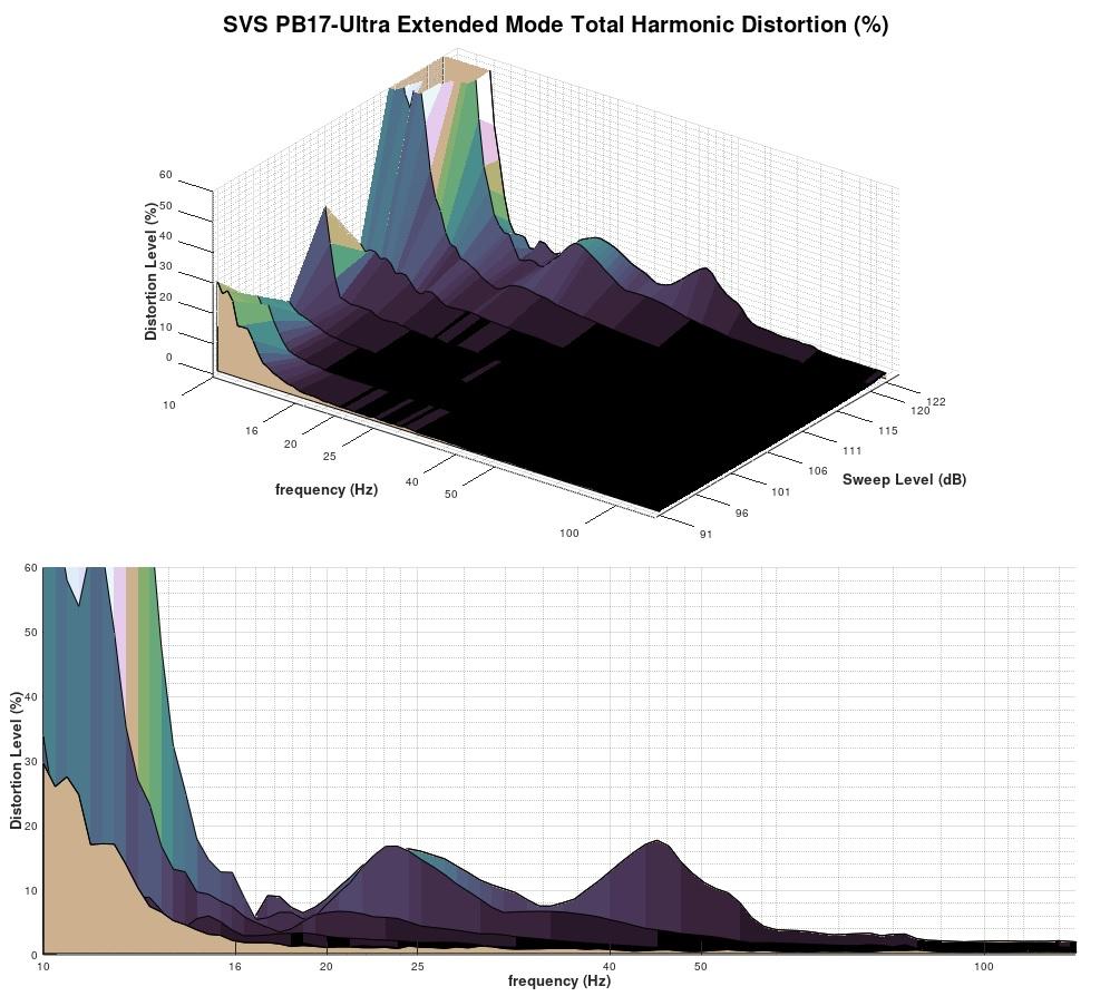

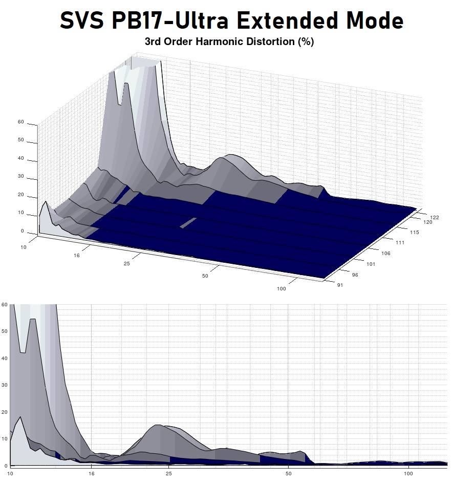

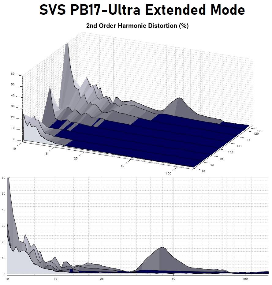

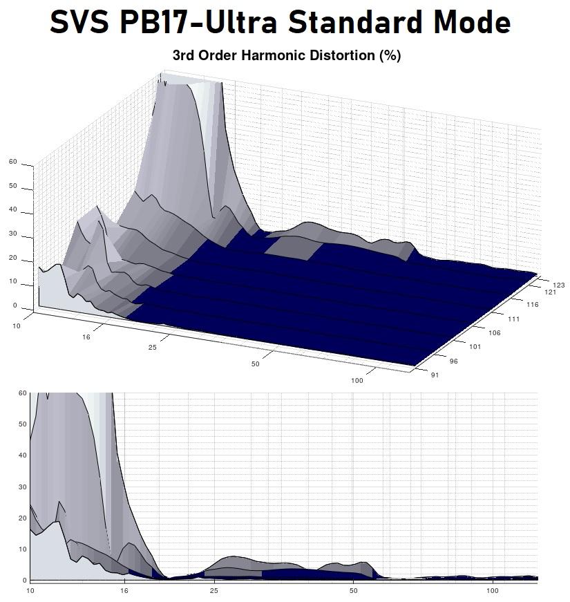

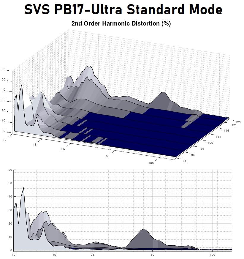

The above graph shows the corresponding total harmonic distortion to the long-term output graph. Essentially, it depicts how linear the subwoofer remains for the corresponding drive level seen in the long-term sweeps. The quantity being measured is how much of the subwoofer’s output is distortion, shown here as a percentage.
Again, these graphs are a terrific showing by the PB17-Ultra for both modes. Only in their highest drive levels do they exceed 10% THD above port-generated frequency output. At nominal levels, they offer extremely clean distortion performance, largely hovering under 1% total harmonic distortion above 30Hz. In the ‘3D perspective’ graph view, any black that you see is almost totally clean bass, for all practical purposes. There is a lot of black. We do see some slightly more elevated levels at lower drive levels at deeper frequencies, but much of that is background noise of the testing environment and not from the PB17-Ultra itself. The reality is that the PB17-Ultra performs better than what these graphs show. At the highest drive level, it can be pushed to produce some audible distortion, but I don’t think any users would push it that hard unless they were deliberately trying to hit its limits. It’s difficult for the PB17-Ultra to produce anything other than clean, undistorted bass.
The above graphs depict measurements of the constituent harmonics from the long-term output sweeps and are what the total harmonic distortion measurements are composed of for the 2nd and 3rd harmonics. These individual harmonics can give us a clue as to what might be the cause of some quirk or non-linearity. We are only showing the 2nd and 3rd here because they more or less reflect the higher even-order and odd-order behaviors, although higher-order harmonics tend to be much farther down as a percentage of distortion compared to the second and third.
There isn’t anything all that unusual about the harmonic composition of the PB17-Ultra’s distortion. One item to note is how the second harmonic spikes just under 50Hz at the highest drive level. I am not sure what to attribute that to, but I don’t regard it as a serious problem. One thing to note is the lack of even-order harmonics at lower levels; to me, that indicates that SVS has managed to keep inductance effects under control, which is surely a challenge with so much voice coil.

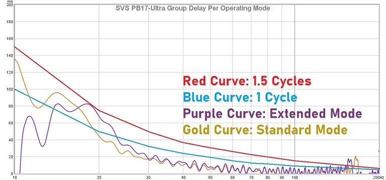

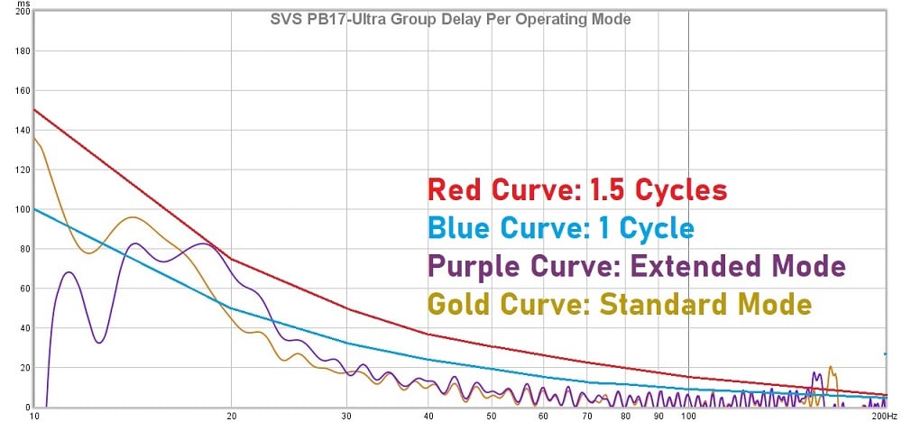

Group delay is the measurement of how much time it takes for individual frequency bands of an input signal to be produced by the speaker. It can indicate that some frequency components are developing slower than others or are taking longer to decay. It is generally thought that 1.5 sound cycles are needed for group delay to be audible at bass frequencies, although there is an argument that group delay should remain under 20ms to be completely unnoticeable, but that is likely meant for mid and upper bass frequencies.
The PB17-Ultra puts up a very good showing in this measurement and improves upon its predecessor. Group delay doesn’t cross 20ms until around 30Hz below which human hearing is very insensitive. Above 40Hz, it hovers at or below 10ms. That is very good time domain performance. Many people would assume that a big ported sub wouldn’t be great for crisp transients in music, but that wasn’t my experience with the PB17-Ultra, and that is not what our measurements indicate. The different operating modes do not make a big impact on group delay either. Port-generated output does jump up to a cycle of delay, as would be expected. However, it’s far too low in frequency to affect anyone in musical range or likely anything that human hearing would perceive as amiss.
