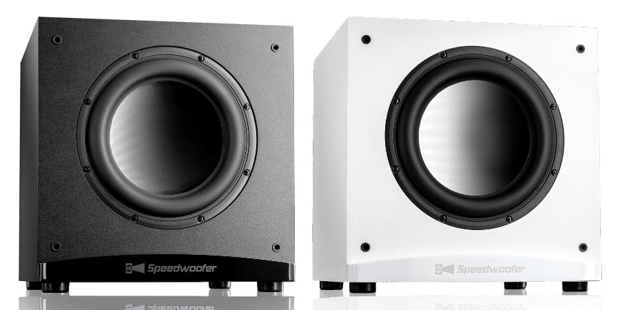

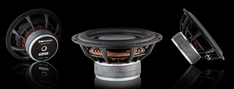

Compression Guide Technology was already at work in the original Speedwoofer 10S subwoofer, but the new MKII version features an updated rear vent tuned with CGT to further reduce port noise. Other improvements include an upgraded amplifier with new circuitry and integrated dual-mode DSP, and a new woofer designed to handle the increased power and heat. RSL calls its new amp the XDR (eXtended Dynamic Range) series amplifier, which can deliver 400 watts RMS (up from 350 watts in the original 10S), and 1020 watts peak for explosive dynamics. The XDR amp also features selectable dual-mode digital signal processing (DSP). The new LFE mode serves up greater low-bass output and deeper extension, down to a size-defying 22Hz. The DSP’s Music mode offers the same tried-and-true performance as the original Speedwoofer 10S, but with increased power and superior dynamics. The amp uses an oversized half-bridge switch-mode power supply, coupled with a highly efficient Class D design with admirably low distortion. The new circuitry also includes advanced thermal management and protection schemes for fluctuations in voltage and DC conditions. The 10-inch woofer boasts a proprietary die-cast aluminum frame, improved thermal capacity, dual-stacked high-grade magnets, and a “fatigue-resistant” suspension. RSL says that the high-excursion linear motor and overall high-precision craftsmanship simply outclass pricier rivals. The original 10S model comfortably met our "Medium" Bassaholic room size rating so we are itching to test the MKII to see if it can achieve our "Large" Bassaholic room size rating.
RSL Speedwoofer 10S MKII
The Speedwoofer’s cabinet features a reassuringly solid front baffle made from 1-inch-thick laminated MDF, with cross-braced panels of 3/4-inch MDF providing the internal Compression Guide Technology framework. Additional bracing at the corners helps minimize resonance while further strengthening the structure. The new rear-vented CGT tuning delivers a reduction in air-flow turbulence, and a concomitant reduction in port noise. Thanks to the design of the wide slot-style port, RSL says you can place the Speedwoofer 10S MKII closer to a wall — just 4 or 5 inches of space should be enough to allow for the proper distribution of air-flow leaving the port. Even greater placement flexibility is offered by the new, smaller AT-4 wireless transmitter, which is available as a $50 add-on. The AT-4 works in conjunction with the wireless receivers that are already built in to every Speedwoofer 10S MKII, allowing the user to take advantage of cable-free connectivity, and to place the subwoofer(s) in whatever location delivers optimal performance. If you want to run multiple subs, the AT-4 transmitter will pair with up to 4 Speedwoofers simultaneously.

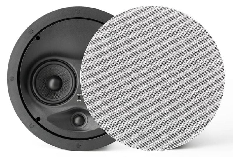

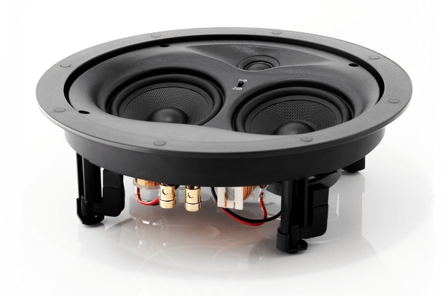

It takes more than great bass to make a great home theater, and one of the most effective ways to take your home theater experience to the next level is to install height-effects speakers for real-deal Dolby Atmos. RSL has chosen to go the in-ceiling route, and it’s not hard to justify that choice. Although in-ceiling speakers require more of a commitment on the installation side, they avoid the performance compromises inherent in reflective-style “bouncy house” height-effects speakers (which sit on top of your main speakers and aim sound at the ceiling). In-ceiling speakers are also less visually intrusive than the wedge-shaped on-wall height-effects speakers offered by brands like SVS and Arendal Sound. RSL’s new C34E MKII in-ceiling speakers are a drop-in replacement for the previous version, so upgrading should be relatively painless. The new MKII version reportedly offers increased bass output and extension, greater efficiency, and lower distortion than its predecessor, along with tweeter level adjustments. The C34E MKII features dual 4.5-inch woofers with woven aramid fiber cones and butyl-rubber surrounds. The speakers employ high-energy ferrite magnets and high-strength, cold-rolled stamped steel frames, according to RSL. The 22mm soft-dome tweeter uses a treated-fabric exposed dome and a powerful neodymium magnet. The driver complement is arranged on a 15-degree angled baffle, allowing the user to aim the sound to achieve better clarity and more accurate imaging. The lateral driver placement “ensures proper time-alignment and eliminates the interference and cancellation of conventional stacked-driver designs to deliver maximum fidelity with greater mid-range and vocal clarity,” according to RSL. The company also reports that the C34E’s crossover uses proprietary, low insertion-loss lami-core and air-core inductors, resulting in improved efficiency and lower distortion. RSL-branded poly caps reportedly reduce distortion and improve the lifespan of the circuit. Finally, non-inductive resistors are said to provide a significant improvement to high-frequency clarity. The C34E MKII is just 3.75 inches in depth (3.5 inches mounted), and includes mounting clamps allowing it to be affixed to surfaces up to 2 inches thick. Although the C34E MKII is ostensibly an in-ceiling speaker, RSL says that it can also be used as an in-wall speaker where required. The edgeless magnetic grille can be painted to match the color of your ceiling or walls.
