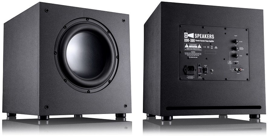

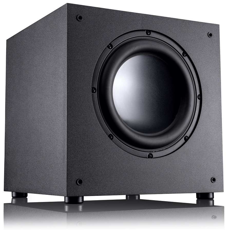

On the surface, the Speedwoofer 10E looks to essentially be a version of the 10S but with features and niceties removed in order to make it more affordable. The basic enclosure design and dimensions are the same as well as the use of a 10” woofer. However, RSL tells me that the 10E has been engineered from the ground up to maximize performance at its price point. While the driver looks the same as the 10S, it is an entirely different design that is optimized for the 300-watt amp used. There are structural changes made to the amplifier to make it less expensive without losing a lot of performance. And while the basic enclosure design is similar to the 10S, there are differences in the port design that should make it less costly to manufacture.

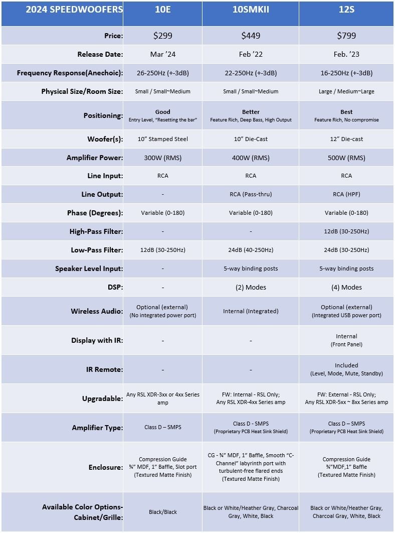

RSL Comparison Table
RSL 10E vs the Venerable 10S MKII
To be sure, there are compromises that must be made to lower the cost. One such compromise is a bit less bass extension than the 10S; this can be gleaned from the +/-3dB frequency response window in the specs where the 10S has a 22Hz extension as opposed to the 10E with its 26hz extension. Nonetheless, 26Hz is pretty darn good for a $300 subwoofer shipped to your door! The 10E also has to give up some features as compared to its more expensive brothers such as speaker-level connectivity, signal output connectivity, DSP modes, and different finishes. With a less powerful 300-watt RMS amp, it probably doesn’t quite have the output potential as its more expensive RSL brothers, but 300 watts is a lot for a sub at its price point since most $300 subs typically have 150 watts or less. The amplifier power difference alone won’t translate into a major output penalty; all other things being equal, an extra 100 watts on top of 300 would only translate into an extra 1.2dB of output. However, the 10S MkII has a more sensitive driver, so its extra efficiency combined with it slightly more powerful amp will likely net more headroom than just a 1.2dB gain.

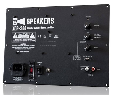

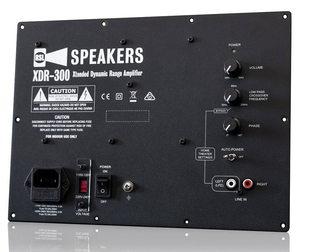

10E Amp Plate
Many of the core technologies of RSL’s higher-end subs have made their way into the 10E. The Speedwoofer 10E still uses RSL’s famous ‘Compression Guide Technology,’ a slot port system that divides the internal space of the sub into different chambers so that rear backwave pressure from the cone compresses and expands in a way that reduces resonances. As with RSL’s other subs, the 10E uses highly efficient class D SMPS amps that RSL has branded their ‘XDR’ amplifier (where XDR stands for eXtended Dynamic Range). It also has a similarly smooth kevlar reinforced cone with an NBR surround like the 10S and 12S.
