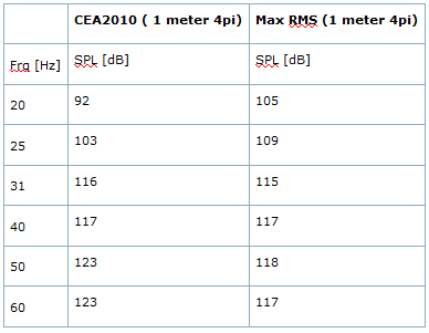

Revel Rhythm2 Measurements
CEA2010 ( 1 meter 4pi)
Max RMS (1 meter 4pi)
Frq [Hz]
SPL [dB]
SPL [dB]
20
92
105
25
103
109
31
116
115
40
117
117
50
123
118
60
123
117

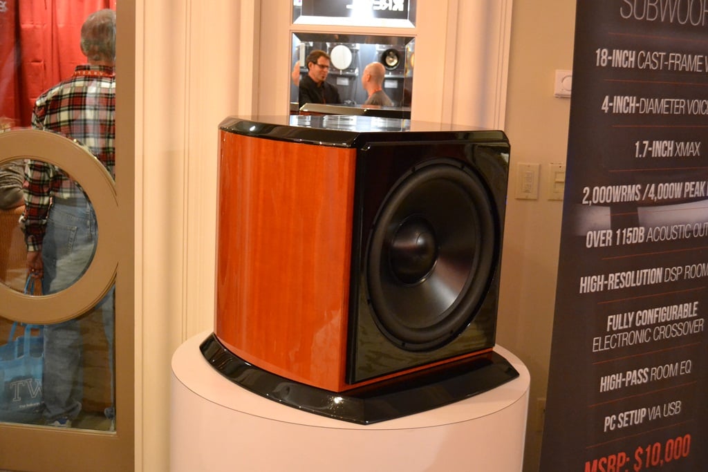

Revel is rounding out their Ultima2 loudspeaker lineup with the release of the Rhythm2 Subwoofer. Their goal with the Rhythm2 was to create a subwoofer that was worthy of the rest of the Ultima2 speakers and could compete with other premium subs on output and features. It’s a single driver sealed design (nothing too crazy there), but it has a number of cool features, like setup via USB, that make it unique.

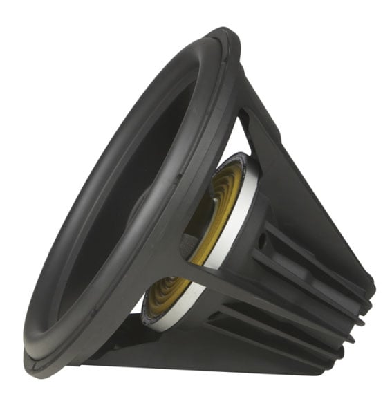

Revel Driver
Revel Rhythm2 18" Subwoofer Driver
The Revel Rhythm2 sports a dual voice coil 18” aluminum cast-frame driver powered by two amplifiers with a total of 2,000 watts RMS (4,000 watts peak). The driver itself has a 4” diameter voice coil and approximately 1” Xmax, which is pretty big huge. Combine the powerful amp, large driver, and long Xmax and you end up with the ability to hit over 115dB and a -3dB point below 20Hz (at lower power levels). Unfortunately, the marketing material leaves a few unanswered questions about these ratings, like at what frequency can the sub hit 115dB and what exactly the -3dB point is. So, we reached out to Harman Audio and got some answers. When in "Normal" mode the -3dB point is 20Hz, but in "Extended" mode that drops down to 16Hz. We also learned that the Linear Xmax, as stated above, is approximately 1" (non peak-to peak), while the mechanical Xmax is 1.7" (not peak-to-peak). The available marketing material available simply says 1.7" Xmax, where it should more accurately say 1.7" Xmech.

1m 4pi = 2m groundplane, Measurements Provided by Harman
The enclosure measures 24.6” H x 27.9” W x 28.1” D and the total weight comes in at a hefty 177lbs. The cabinet itself has a 1.5" thick baffle, is curved on the sides, and has a beautiful glossy finish.  There is no servo control in place, but there are protection circuits. The build quality and driver compliment are certainly impressive, but seem a little lacking for a sub in its class. Did we mention MSRP is a blistering $10,000? But let’s take a look at some of the features before making a final judgment.

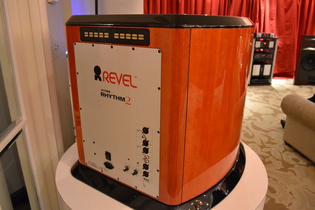

Revel Rhythm2 Rear View

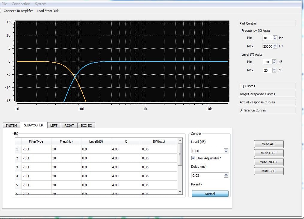

One of the big highlights of the Rhythm2 is the optional setup via PC and extensive EQ options. Typically, most of the settings on a subwoofer are configured via controls on the back panel, but the Rhythm2’s advanced adjustments are done using a computer. Revel's LFO, or Low Frequency Optimization, software allows for adjustment of delays (true delays, in contrast to most phase controls), high/low pass filters, volume, and EQ. On the back panel you will find a set of RCA and XLR inputs and outputs for your main speakers. This is because the Rhythm2’s EQ has the ability to handle crossover and EQ settings for your speakers, as opposed to setting them in the receiver. Using the subwoofer's processing power you can EQ up to 10 different room modes from 20-400Hz, whether the bass is coming from your speakers or the sub. You can also choose different slopes and high pass filters for the sub and main outputs. By adding the extensive EQ options Revel allows users to integrate the Rhythm2 with their main speakers much more seamlessly than might otherwise be possible. Below is a screenshot of Revel's LFO software, which is quite full-featured.
HK LFO
Low Frequency Optimization (LFO) Software

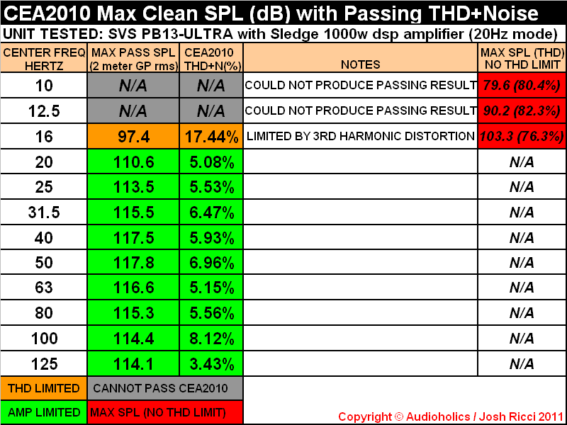

Overall, it looks like the Rhythm2 has some cool stuff going for it, particularly the EQ options. But when compared to other subs in the $10,000 price range, a nifty EQ isn’t likely going to make anyone run out and buy this thing. Lukily the Rhythm2 has much more than a "nifty EQ". It's actually quite powerful and a big feature of the subwoofer. But, ignoring the software setup and EQ, for $1000 less the Paradigm Sub2 we reviewed will give you more low frequency output and it comes with Paradigm’s own Perfect Bass Kit for EQ. The SVS PB13-Ultra we reviewed costs 1/5 the price and we measured clean output levels of up to 117.5 dB earning our Extreme Bassaholic rating, but it lacks the sophisticated EQ system found on the Revel. However, you could easily purchase four SVS PB13-Ultra subs to get the ultimate in bass output, extension and smoothness to all listening seats requiring little to NO EQ at all, and still pocket $2k.  Also consider the great Velodyne DD-18+ with a very useful adjustable manual EQ that received our Extreme Bassaholic rating and 2011 Product of the Year award for 1/2 the price of the Revel.
