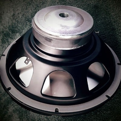

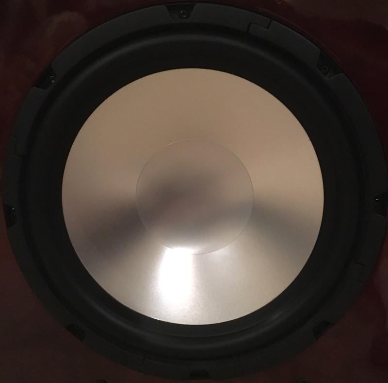

  • Drive Units:     ...     (1) 12" (305mm) Aluminum Cone Subwoofer

RBH's Impression Series consists of two models, the $499 I-12 and $699 I-12/e.  The I-12 is powered by a 350-watt RMS Class D amplifier while the I-12/e features a 500-watt RMS Class D amplifier and some extra DSP processing to lower the bass extension.  These are continuous rating power figures, not peak like some subwoofer companies often specify.  The I-12/e is a triple ported, large box subwoofer sporting a 12" aluminum driver with a 2.5" voice coil, a large motor structure with vented pole piece, and stamped basket.  This driver has been used in other RBH products for years so it's field-tested and very reliable.
I-12 Driver  RBH I-12/e backview

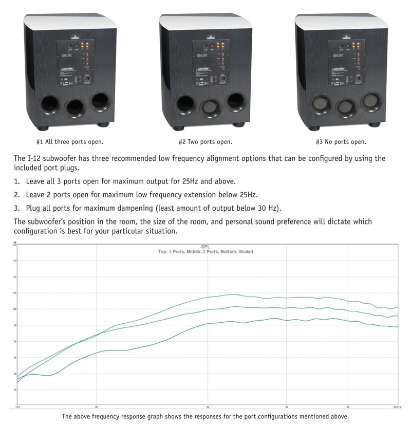

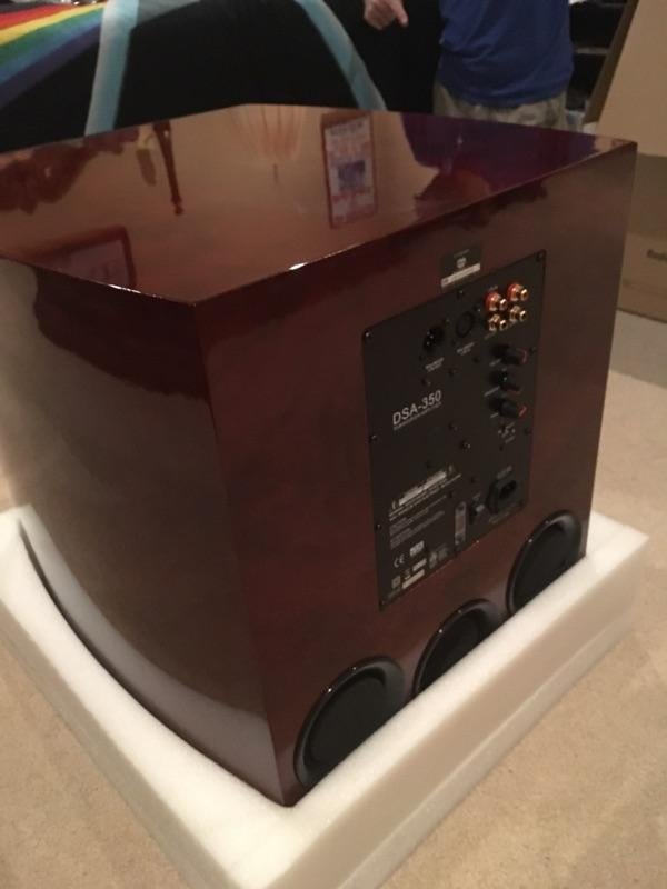

It comes with port plugs that allows the end user to tune its response to preference.
  • All ports open - max output above 25Hz
  • 1 Port Sealed - max extension below 25Hz
  • 3 Ports Sealed - maximum damping, least output below 30Hz
The I-12/e amplifier offers unbalanced stereo and balanced LFE inputs and outputs to daisy chain multiple subs while also bypassing the internal crossover in favor of using the AV receiver/processor internal bass management.  Unlike most subs in this price class that typically offer 0/180 degree phase switch, the I-12 offers a variable phase dial for more precise adjustability when blending the sub with the main speakers at or near the crossover point.  Trust us, this is a nice addition and can really come in handy for bass heads wanting to fine tune their set up.  For those using the internal crossover of the I-12, it offers an adjustable dial from 40Hz to 150Hz.  The power cord is detachable and there is an auto-on option.

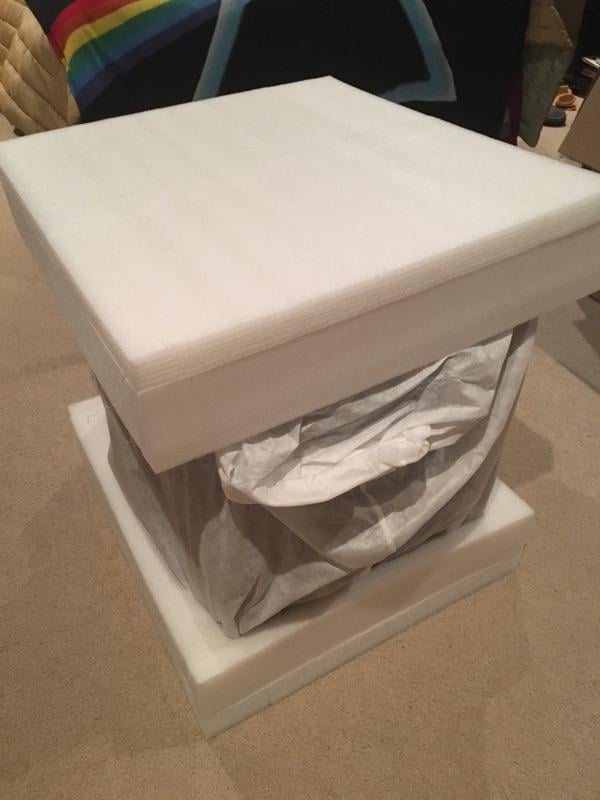

The RBH I-12/e was well packaged as you can see in the photos above.  It came double boxed with very thick padding and cloth protecting the subwoofer from taking a beating during shipping.
Given its largish size, the most aesthetically pleasing position for a sub like this would be in a corner.  Of course this may not always be the optimal placement for the sub, but EQ can help and given the affordability of this sub, a pair loaded on opposite corners would certainly improve the quality of bass from seat to seat while also providing more usable output.

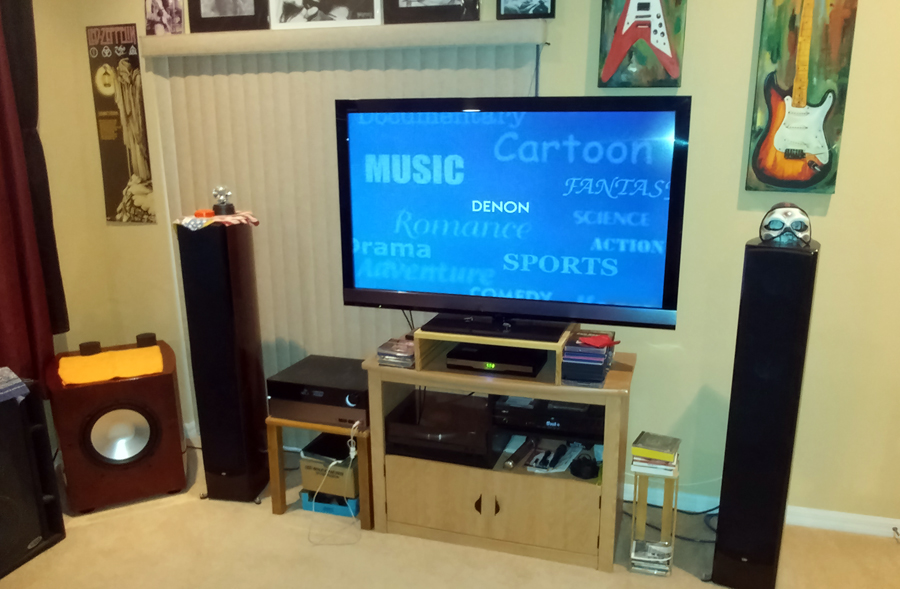

We tested the I-12/e in the Audioholics family room system which uses a compete RBH Signature Series speaker system powered by a Yamaha RX-Z7 AV receiver and at my neighbors house who runs a pair of RBH R55ti towers powered by a harman/kardon HK3490 stereo receiver.  When connected to the RX-Z7, I used the LFE In connection to bypass the subwoofers internal LPF.  However when connected to the HK3490, we utilized the line inputs and dialed in the subwoofer crossover to around 60Hz for the best blend to the R55ti towers.  In both rooms we corner loaded the sub.  I preferred one port closed for the listening tests in the Audioholics family room setup while my neighbor settled on sealing all ports since he was primarily using his sub for music listening and thought it sounded a bit tighter in this configuration especially when used with his RBH R55Ti towers running full range.

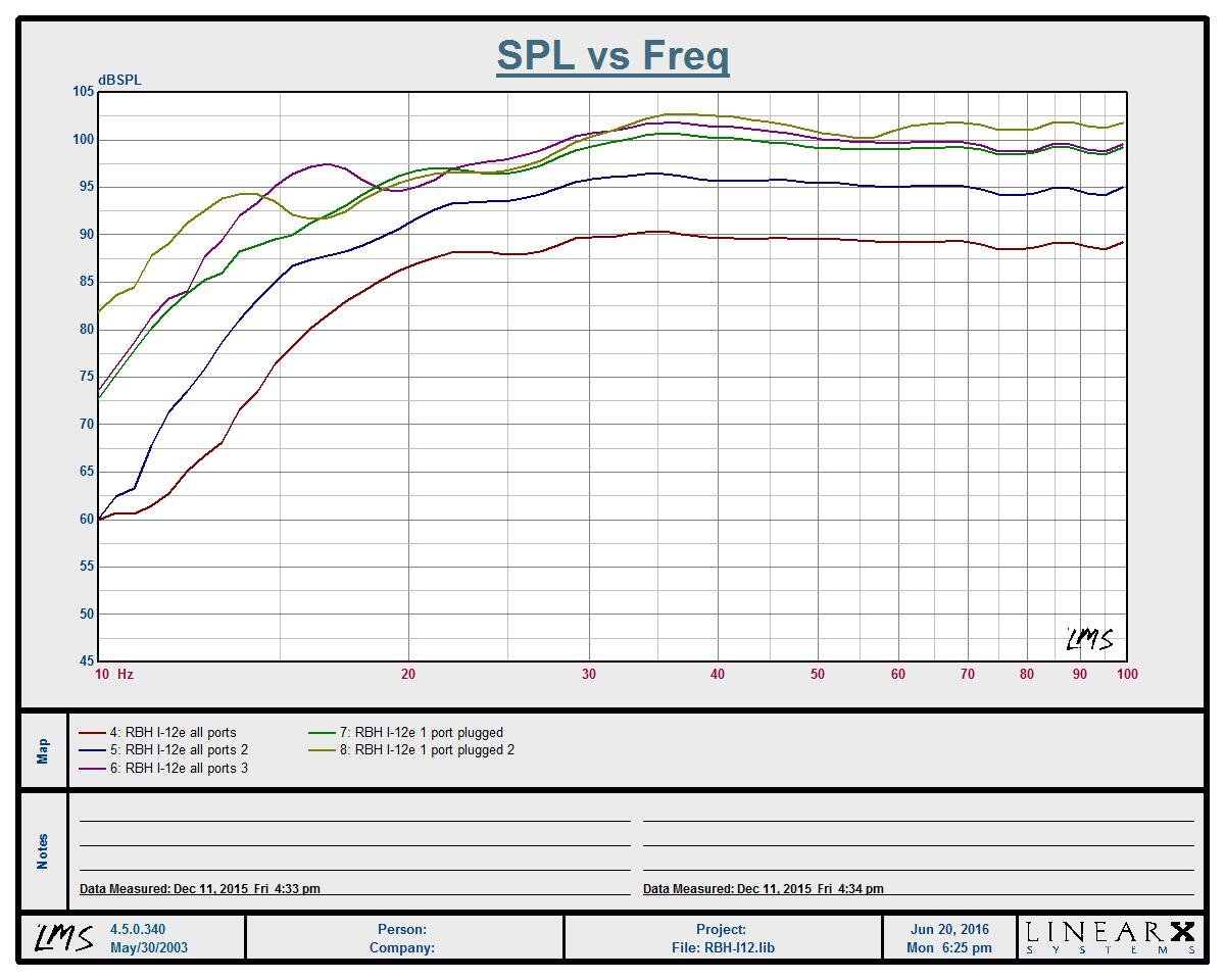

There are 3 tuning modes for the I-12/e subwoofer as shown below in a screenshot from their manual.
RBH Port Tuning
RBH I-12/e System Tuning
RBH I-12/e sweeps

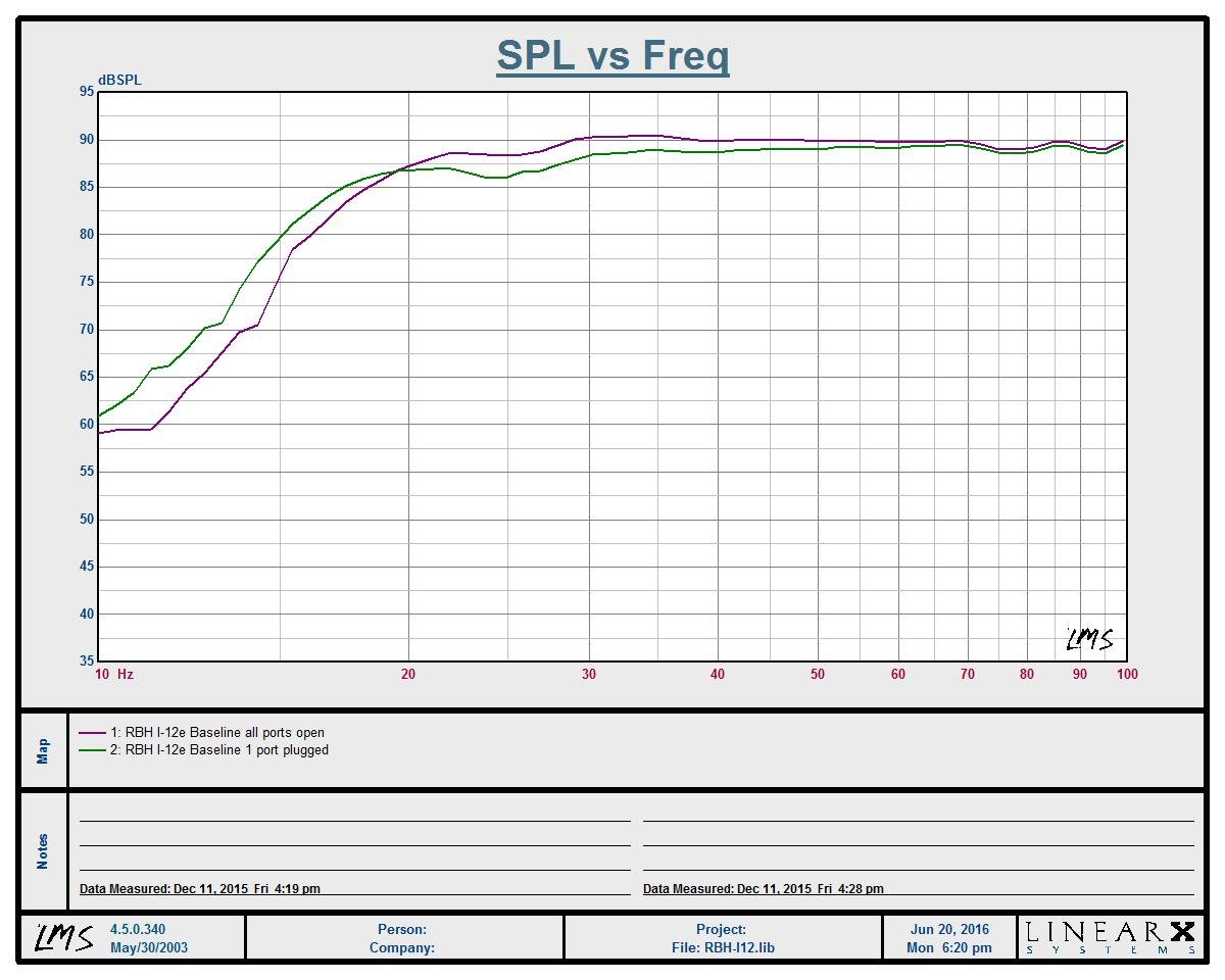

Outdoor 2 meter ground plane testing of the RBH I-12e
The I-12e exhibited a very linear frequency response beyond 100Hz making it a good subwoofer for small satellite speakers requiring a higher than 80Hz crossover frequency.  The limiting factor for output of this sub above 20Hz was actually the amplifier, which wouldn't allow me to exceed 103dB output levels at 2 meter as seen above for continuous sweep tests.  I couldn't help wonder how much more output this sub would have if RBH chose an amplifier with a less aggressive limiter and how that would have ultimately affected my listening test results.
For max output, you will want to leave all 3 ports open.  However, if you want extended deep output and slightly more control below 20Hz, I'd recommend using 1 port plugged.  Trace #6 shows the woofer losing control below tuning with all ports open but plugging 1 port dampened and lowered this behavior to subsonic frequencies.
 RBH I-12/e tuning
Tuning with all ports opened was around 21Hz but with 1 port plugged, it dropped to about 18Hz.  You do loose about 1-2dB of efficiency with one port plugged but in my opinion it's worth it for the increased extended low frequency response and better system control below tuning.

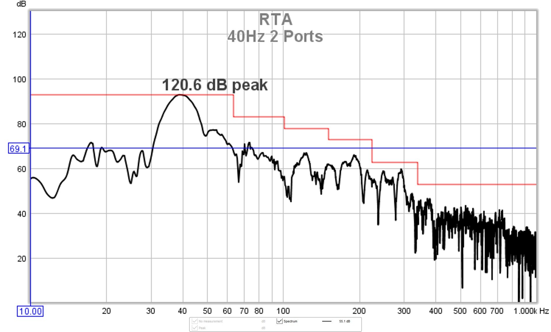

CEA2010 Test Results

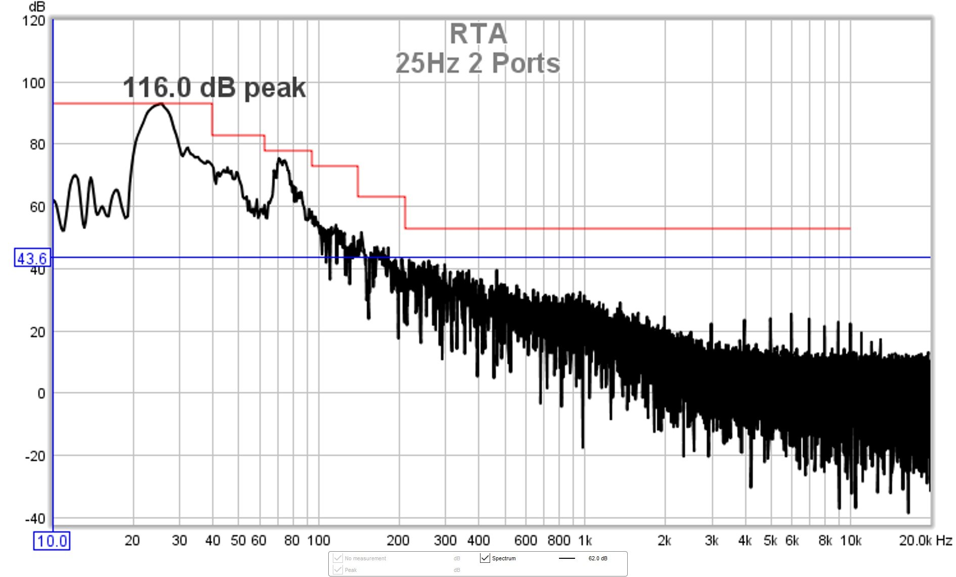

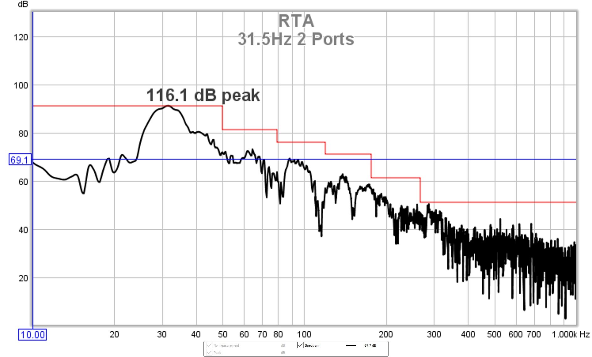

Here are the peak CEA2010 burst results taken at 1m and translated to 2 meter in the data table below.  The mic was SPL calibrated with a B&K 4230 reference microphone calibrator.
Frequency 3 Ports 2 Ports
20 Hz 93.2 dB 100.3 dB
25 Hz 107.6 dB 107.0 dB
31.5 Hz 110.6 dB 107.1 dB
40 Hz 112.0 dB 109.3 dB
50 Hz 109.9 dB 109.9 dB
63 Hz 109.2 dB 109.5 dB
80 Hz 109.5 dB 110.2 dB
100 Hz 106.2 dB 106.1 dB
CEA 2010 Results 2 meter rms (measured sideways)
 25Hz 2port  31.5Hz 2 Port  40Hz 2 Port
CEA Distortion Thresholds (2 Port Mode)
Large Bassaholic
Based on the test results above, the I-12/e has earned our Large Bassaholics rating, signifying that it should be able to provide satisfying bass levels in rooms of 3,000 cubic feet to 5,000 cubic feet (read about our Bassaholics room rating system). If you can afford it, I would still go for multiple subwoofers, regardless of room size, for the sake of smoothing out the low-frequency response and extending dynamic range.

Aluminum coneFor years I've been suggesting that RBH Sound build an affordable HUGE subwoofer to compete with the ID subwoofer greats.  Not only has RBH succeeded with the I-12 and I-12/e subwoofers, but they've managed to do so in an attractive package that goes beyond just the standard square box.  Although the I-12 sub is large, it looks quite attractive, especially when placed in a corner and used alongside their matching Impression series loudspeakers.
