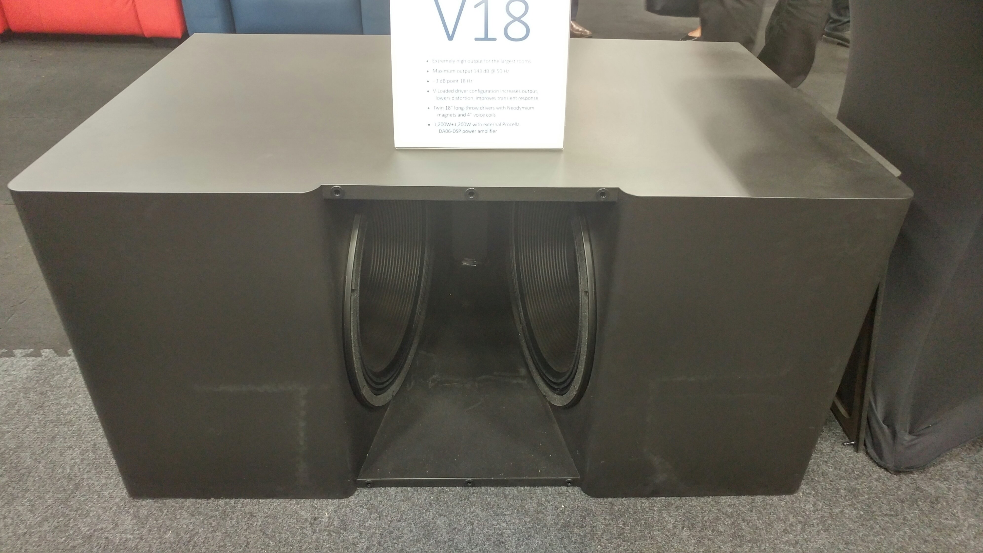

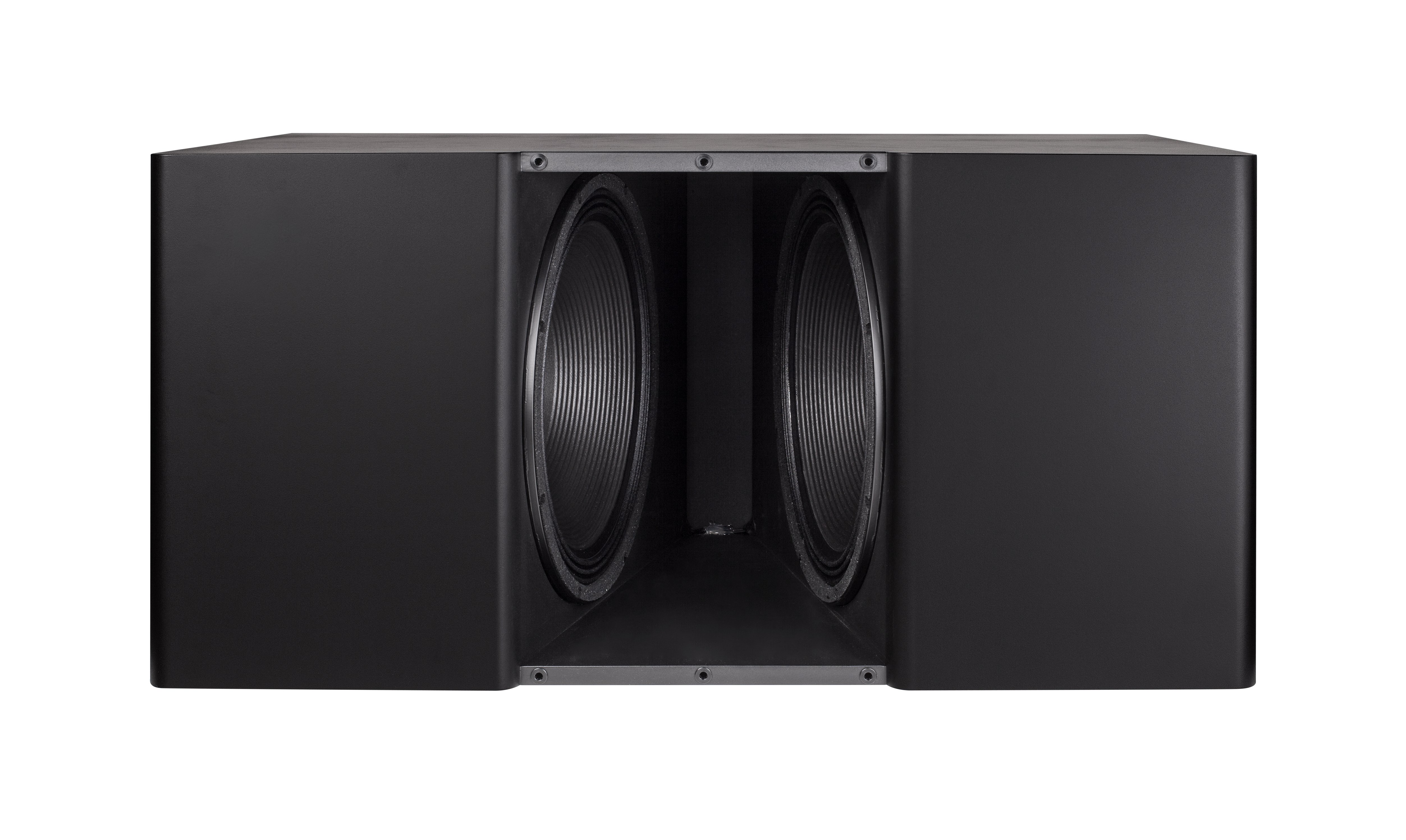

In the V-Loaded configuration, which was first made available in Procella’s P860 speaker and V6 subwoofer, the drivers are mounted facing each other, angled at about 12 degrees to form a shape like the letter V. In playback, this produces coupling and a high compression loading of the drivers, resulting in lower distortion, improved transient response, and reduced cone excursion at high SPL.

While Procella has always produced extremely high output subwoofers that include the reference P18, there are large rooms and listeners with requirements for low frequency reproduction at even higher playback levels. The V18 was produced to address those needs,” said Procella founding director and V18 designer Anders Uggelberg. “We increased the enclosure volume and added our V-Loaded configuration to enable the V18 to achieve higher sensitivity, 3 dB higher maximum SPL, and some 3dB more power at very low frequencies.”
With 1W/1m sensitivity of 105 dB, and power handling of 2 x 1,400W continuous and 2 x 2,800W peak, the V18 has an extremely high output capability. Its low frequency extension to a –3 dB point of 18 Hz enables it to produce massive output at subsonic frequencies. Its hand-made Neodymium subwoofer drivers have 4 inch voice coils and are produced for Procella by one of Italy’s top professional audio driver manufacturers. Each 8 ohm driver is fed directly from an amplifier channel through gold-plated binding post inputs.
The companion amplifier for the V18 is Procella’s DA06-DSP two-channel class-D power amplifier, which provides 1,200 Watts continuous to each driver. Factory-programmed amplifier DSP presets are used to optimize the subwoofer’s response and provide compensation for room placement. User-selectable options include subwoofer location against a wall, in a corner, or located in a baffle wall.
The V18 is as impressive visually as it is acoustically. To achieve its greater internal volume, its rectangular cabinet shape has greater depth than Procella’s traditional shallow profile. Its dimensions are 105 cm (41.3”) wide x 52 cm (20.5”) high x 67 cm (26.375”) deep. Its weight is 81 Kg (178.5 lbs.), and shipping weight is 100 Kg (220 lbs.) including shipping crate and pallet.
