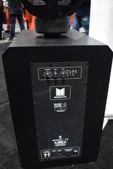

 - Input Connectors: RCA (2), XLR
 - Output Connector: XLR
 - Power Output: 500 watts for 10” THX Select and 12” THX Ultra, 1000 watts (RMS) for 15” THX Ultra

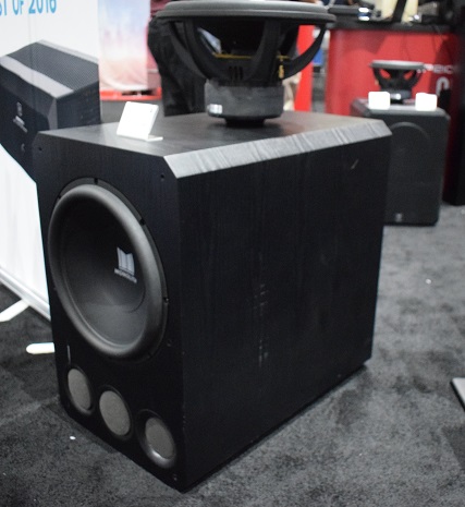

Online A/V accessories store Monoprice.com is positioning themselves further into a hi-fi and home theater solution by expanding their Monolith line with a set of heavy-duty subwoofers. At this year’s CEDIA, Monoprice has announced their Monolith THX subwoofer line that, as its name implies, carries THX certification for the entire line. The Monolith THX subwoofer line is comprised of three subwoofer models named the 10” THX Select, 12” THX Select, and 15” THX Ultra. Monoprice could hardly have picked a more literal naming scheme for these subs since the names can also serve as short descriptions. The 10” THX Select uses a 10” cone and is THX Select certified, the 12” THX Ultra uses a 12” cone and is THX Ultra certified, and the 15” THX Ultra uses a 15” cone and is THX Ultra certified. The Monolith THX subwoofers all have front-firing cones and ports, with the 12” THX Ultra and 15” THX Ultra having variable tuning capability.

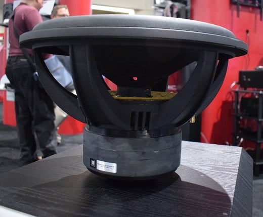

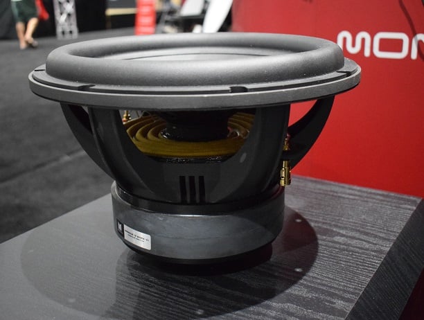

Driver for 15” THX Ultra (left) and 12” THX Ultra (right)
Note the triple stacked magnets of the 15" and double stacked magnets of the 12" driver.
Even disregarding THX certification, there is a lot of promise for performance in the base specs of the Monolith THX subwoofers. The listed Xmax of 18 mm for the 10” and 12” and 25 mm for the 15” is a tremendous amount of linear throw for those cone sizes. Furthermore, the cabinets are also quite large for the cone sizes which bodes well for deep bass efficiency. Indeed, the 15” THX Ultra is specified for a -6 dB low-end response of 14 Hz. The large cabinet sizes are not without a weight penalty, with the entry-level 10” THX Select weighing in at a hefty 72.5 lbs., and the 15” THX Ultra weighing in at a daunting 128.5 lbs. Amplification is provided in abundance with 500 watt RMS amplifiers for the 10” and 12” and 1,000 watts RMS for the 15”. The drivers look serious, with large roll surrounds and beefy cast-iron baskets. All these ingredients can add up to excellent performance in the hands of a competent subwoofer designer, and Monoprice has handed the task of design to a highly-experienced and very qualified subwoofer designer.
