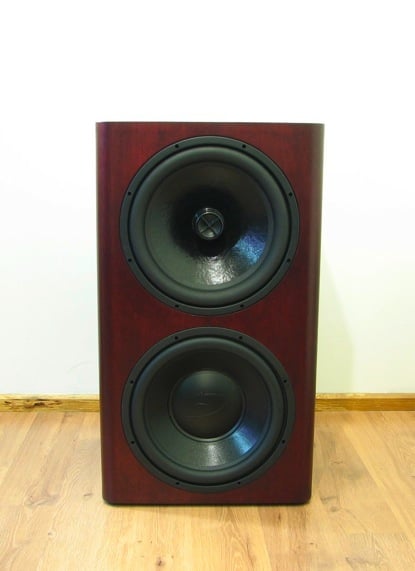

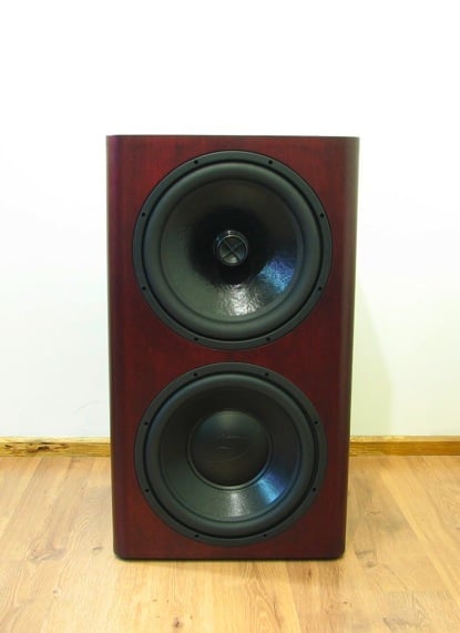

15.3
The 15.3 is very similar to the 15.0, utilizing the same driver and amp. The biggest difference is that it has dual 15" passive radiators, taller enclosure, and variable tuning. The enclosure measures 18" wide x 34" high x 18" deep. It has variable tuning from 19-28Hz, allowing you to choose SPL vs. extension. With the 500w amp it has a -6dB point at 16Hz (lowest tuning) and 116dB maximum output. With the 800w amp it has a -3dB point at 16Hz and a 118dB maximum output. For an extra $200 you can get a curved cabinet, add $200 more for the upgraded amp, $150 for solid wood inlayed corners, and a magnetic cloth grill for $150 and you it's like West Coast Customs got a hold of your sub. Well, more like a skilled engineer improved and customized your sub. Even though the base price is $1600 ($1800 for US) you could quickly end up spending a few hundred extra dollars to get the sub how you want. But this is one of the great parts about buying a Funk Audio sub, the company wants to work with each customer to make a sub that works perfectly for them, it will just cost you some extra coin.
