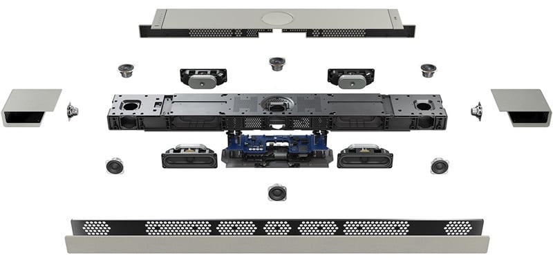

KEF XIO exploded
The XIO’s 5.1.2-channel system is powered by 12 Class-D amplifiers, which drive a number of custom-designed transducers. There are six Uni-Q MX driver arrays, of which only five are in use at any given time (depending on the physical orientation of the soundbar). Three of these fire forward for the LCR front stage, and two are aimed at the ceiling for height effects. There are four race-track-shaped bass drivers for the low frequencies, and a pair of 2-inch side-firing full-range drivers meant to increase immersion and provide surround-channel content. The XIO can be wall-mounted below your TV, or it can sit flat on a TV stand or other piece of furniture. When wall-mounted, the drivers that normally fire forward are pointed upward, and the ones that normally point up are pointed straight at the listener. KEF’s Intelligent Placement Technology (IPT) detects the soundbar’s orientation and automatically re-routes the correct signals to the drivers. Built-in microphones enable IPT to further adjust the XIO’s performance based on the listening space, detecting walls and furniture, and self-calibrating the audio automatically. For those who may struggle to understand dialogue, the XIO offers a dedicated Dialogue Mode, in addition to other EQ presets, such as Night Mode and Music Mode. All of the aforementioned smart features are part of KEF’s Music Integrity Engine (MIE) for Cinema, a suite of sophisticated DSP algorithms designed in-house for the XIO. The MIE also handles multi-channel processing and virtualization.

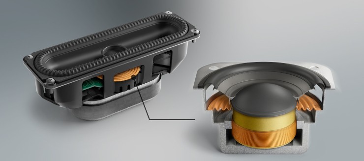

The bass is handled by two pairs of KEF’s newly-developed P185 LF drivers, positioned back-to-back in a force-cancelling configuration that significantly reduces mechanical vibrations, according to KEF. The racetrack-shaped P185 measures about 7 inches wide and 2 inches tall. According to KEF, the P185 has about the same radiating area as a traditional 4-inch circular cone, but its elongated shape allows the XIO to be considerably slimmer than it would be using more conventional bass drivers. The surround of the P185 incorporates KEF’s P-Flex technology, adapted from the KC62 and KC92 subwoofers. This tech reportedly resists acoustic pressure within the cabinet, enabling the driver to move with greater precision and to achieve deeper bass extension without sacrificing clarity.
Also at work inside the P185 LF drivers is a new patent-pending technology that KEF calls Velocity Control Technology (VECO). A built-in sensor within the bass driver monitors coil motion in real-time, employing a negative feedback loop to dramatically minimize distortion and compression, according to KEF. This reportedly delivers “ultra-clean, deep bass and a listening experience free from unwanted artifacts.” The embedded electromagnetic sensor within the driver features a sophisticated wire pattern that generates an electrical signal based on the speed of the voice coil. Surrounded by a magnetic circuit of tiny magnets and steel rings, the sensor is said to detect motion with “incredible accuracy,” inducing a current in response. This real-time data is then sent back into the amplifier through a negative feedback loop, correcting any misalignment between the audio signal and the driver’s motion, according to KEF. By applying the necessary damping to maintain system stability, VECO reportedly ensures that the signal reaching the driver’s voice coil is “a seamless integration of the intended musical content and real-time corrections.”

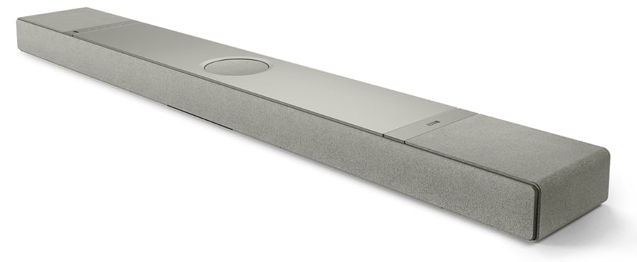

The KEF XIO Soundbar is available in Slate Black and Silver Grey, with an aluminum top plate and “splash-proof” fabric completing its very attractive design. It should be available to purchase by the time you read this.
