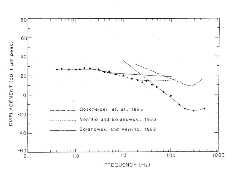

Of course, any system set up to sense vibration must have a range in which to discern periodic motion, or in other words, a frequency response. Our sense of hearing, which is also a form of mechanoreception, is often said to have a frequency response of 20 Hz to 20,000 Hz (although that frequency response is a simplification, and a more accurate depiction of normal hearing response can be seen here). Likewise, mechanoreceptors throughout our skin and inside our body have a frequency response range, although the vibration that is normally measured is an object having contact directly with the skin. While air has direct contact with the body, its vibratory motion is not usually forceful enough, except when moving hair, to trigger mechanoreceptors except at high sound pressure levels. For sound pressure levels on the skin to be felt, they must be greater than the mechanical thresholds of the mechanoreceptors as outlined in figure 1.
Fig 1 response of mechanoreceptors
Fig. 1: Dashed lines represent sensitivity threshold of different mechanoreceptors located in the palm of the hand, and the dots represent the absolute sensitivity of all mechanoreception. Threshold values are given in decibels (dB) referenced to 1 micrometer (μm) peak. (from Bolanawski, Gescheider, Verillo, & Checkosky, 1988). Reproduced with permission from AIP Publishing LLC. Copyright 1988, Acoustical Society of America.”
Note how, much like our sense of hearing (seen in this chart), our sense of touch is relatively insensitive at low frequencies. Also, note the total frequency band of vibratory mechanoreception: 0.4 Hz to approximately 800 Hz, has a much more limited frequency range than hearing. The threshold of sensing touch vibration frequencies seem to follow the contours of the minimum audibility curve, and it has been shown at levels 20-25 dB above the hearing threshold, it is possible to feel vibrations in various parts of the body. In theory, to sense sound ‘non-auditorily,’ a sound wave would need to be powerful enough to displace enough skin and be above the mechanical sensitivity threshold of the frequencies in Fig. 1 to be felt. While the non-auditory sensations of sound have not been studied enough to establish a ‘minimal sound pressure-induced tactile sensations’ response curve, many studies have been done on the physiological effects of sound on the body.

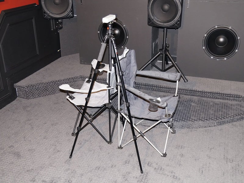

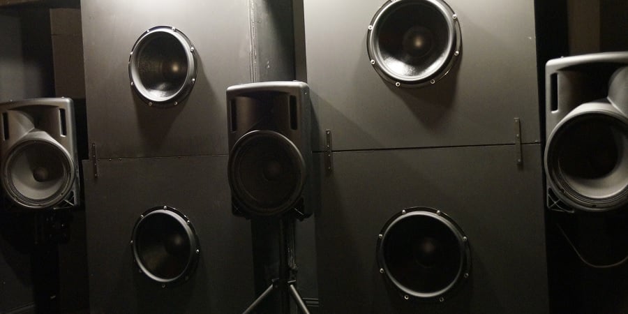

To the Lab!
Now that we have surveyed some of the results of the physiological and subjective sensations of low frequency sounds, let’s see how well they match our own experience by running a test of our own. We gathered nine participants, all adult males in ages ranging from 25 to 58, and subjected them to a set of bass frequencies at three different output levels and had them write down where in their body were they feeling any sensation, while we recorded what output level was needed to reach that point. The results were then tabulated, with areas of the body which needed less output to effect a sensation given a higher weighted score than those body areas which only responded to higher output levels, so anatomical areas with a higher score were more affected than those with lower scores. The scoring system was weighted by having the body areas that registered sensation at the lowest output level count for three points, while those areas that registered sensation in the middle output level count for two points, and those areas that would only register sensation at the highest output level counted for one point. The test sounds were ⅓ octave tones starting from 10 Hz and ending at 200 Hz. Each frequency was played back in five successive pulses at one second per pulse and repeated at three different volume levels, with each volume level ramped up by 6 dB and the starting loudness level averaging around 95 dB (C-weighted). While the frequency response in the listening position was not perfectly flat, the testing was done in a manner which insured all subjects were exposed to the same output levels per tone, by confining the listening position to a very small area and only testing two subjects at a time (see Fig. 3). The sound playback equipment consisted of four large subs with 18” woofers powered by 4,800 watts of amplification. The results may not be as rigorously scientific as they could be (to say the least), but some interesting patterns did emerge.
To make a large amount of frequency data digestible, we divided it into three bands: ‘deep’ frequencies from 10 to 25 Hz, ‘mid bass’ from 31.5 to 80 Hz, and ‘upper bass’ from 100 to 200 Hz.

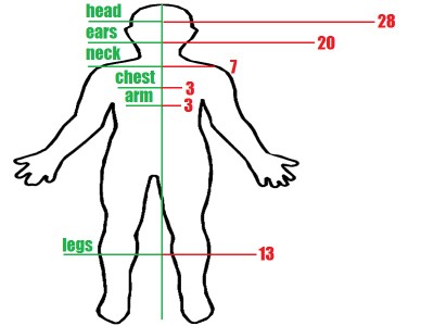

Fig4 body chart 10-25 Hz
Figure 4: Reported sensations from 10 to 25 Hz. Areas of body with higher scores were more commonly or severely affected than lower scored body regions.
Fig. 4 is a graph of the deepest frequency segment of our testing, 10 to 25 Hz, and we see many participants reporting a considerable amount of activity in the head for this band. Comments include “pressure” and “pulsing” with respect to head sensations. We also see the ears themselves were felt to vibrate. As was mentioned before, auditory structures in the head may intensify vibrations felt there. Perhaps low frequencies have some kind of effect on the vestibular system? Also in this band, one test subject mentioned feeling his nose vibrate.

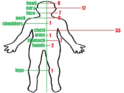

Fig5 body chart 30 - 80 Hz
Figure 5: Reported sensations from 31.5 to 80 Hz. Areas of body with higher scores were more commonly or severely affected than lower scored body regions.
In Fig. 5 we see the results of test tones from 31.5 to 80 Hz, the bulk of the ‘subwoofer’ range. What is immediately clear is that the chest is very sensitive to sound within this band, with most test subjects reporting sensation there at some volume level. In light of the results of previous research in the effects of sound on human anatomy, this is an unsurprising outcome. Something else notable is the continued sensations on the ear, which was not reported in previous studies. Perhaps the thin structure of the ear and the stiffness of the cartilage combine to make it prone to vibration at sufficient volume levels in lower frequencies.

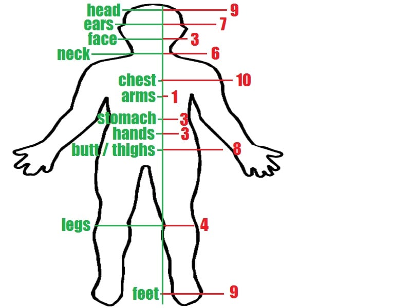

Fig6 body chart 100-200 Hz
 Figure 6: Reported sensations from 100 to 200 Hz. Areas of body with higher scores were more commonly or severely affected than lower scored body regions.
Figure 6 seems to show the sensations were more evenly distributed over the body. Indeed, two participants wrote down “whole body” on some tones in this range. Perhaps this is because the skin’s mechanoreceptors become more sensitive in these frequencies (as shown in Fig. 1), so more skin area feels activity instead of just those body regions prone to vibration.

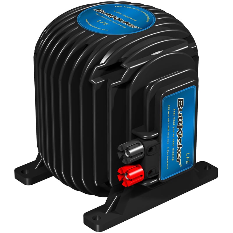

Buttkicker Tactile TransducerThe surest way to increase a tactile feeling from your sound system is to simply increase the loudness level, particularly in the bass region. Of course, that is the brute force method to gain a more physical presence from the system, and there are other more exact solutions. One solution is tactile transducers which are devices attached to the seat and hooked up to the receiver’s subwoofer pre-out. Tactile transducers physically shake according to the frequency of the signal they receive, which vibrates the seat and thus the listener. Some tactile transducer brands have colorful names such as ‘Bass Shaker’, ‘Buttkicker’, and ‘Earthquake’. They can have an impressive effect; however, they are not a full substitution for the effect of a high-level air pressure wave. To quote one review of published research on low frequency noise and its effects, “The vibratory response of the body to acoustic stimulation is different from its response to mechanical vibration through the feet or seat. Low frequency acoustic stimulation acts over the whole body surface.”
There may be other tricks into increasing the tactile feeling of your bass. As was mentioned before, it could be that simply having your mouth open may make a difference in how you feel sound. Keeping the room warm may help as well, since one experiment found the skin to be more sensitive to vibrations at 86°F than at 59°F. Body fat has also been shown to dampen vibration and obstruct its propagation throughout the body, so shedding some body fat may help to get a more visceral feeling from your sound system. One precise way to easily bump up the ‘feeling’ of your bass is to boost certain narrow bands in the bass region instead of the entire frequency range. As was noted in our testing, 50-63 Hz seemed to carry a very potent effect on the chest region, so giving that frequency range a boost may give your system an extra kick.
