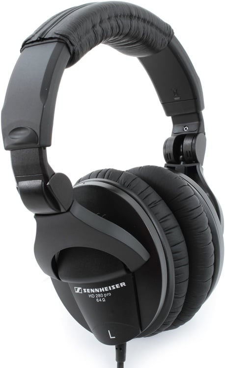

Sound isolation involves a combination of techniques designed to limit the sound that enters as well as exits your theater. Think of it like wearing a pair of closed back "over ear” headphones: you can’t hear what’s going on in the outside world, and they can’t hear what you’re listening to. “I don’t care if people hear what’s going on in my theater” you say? No problem, but if sounds can easily leak out of a theater, they can leak in just as easily. If you’re trying to achieve a reasonably low noise floor (not to mention avoid ticking off your significant other), it behooves you to consider a bit of sound isolation when designing your theater.
HD280Pro-large
Like this, but for your room.

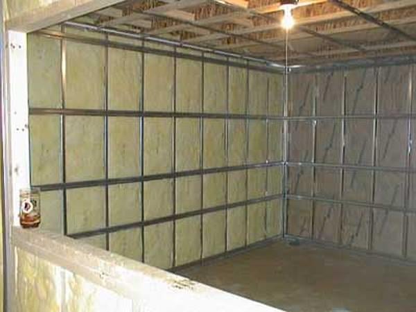

2.0 Absorption – When you beat on a hollow drum, it makes more sound than beating on a drum filled with sand. The same principle applies to your theater walls: when you fill those walls with insulation, it again cuts down on the sound transmitted to the other side.
3.0 Decoupling – If you can create a ‘gap’ between two surfaces, it makes it harder for the sound to ‘jump’ from one surface to another, again improving sonic isolation.
