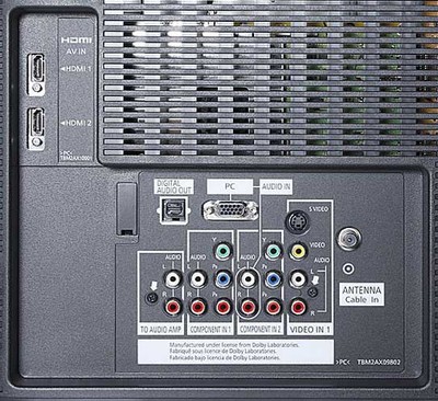

The back of the TV supports two HDMI inputs, two component video inputs, a PC input and a shared composite/S-video input. Separate stereo audio channels are included for use with all of the non-digital inputs (HDMI requires audio be sent over HDMI if you want to use the TVs internal speakers).

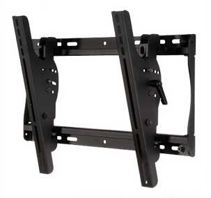

One very important thing to note is that the HDMI inputs will be covered up if you use a full size traditional flat panel mount that includes a full face horizontal mounting plate (see below).
The mount on the left will not play well
with accessing the two rear HDMI inputs on this TV; the model on the right will
give you a fighting chance but is still not a guarantee and is sure to be
awkward.
This type of open-backed mount is going to be your best bet.

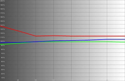

Using our reference Datacolor
Colorfacts Professional software, we measured grayscale and primary colors
as well as the contrast of the TC-37LZ800. Color reproduction, as seen by the
CIE chart was pretty good, though red really looked off - like it was leaning
towards a more pinkish hue. This bore out in our results, but not as much as I
had initially guessed, showing me that instrumentation is a vital addition to
my eyes.

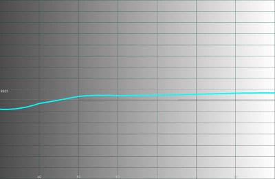

Even though the panel warmed up for over an hour before we began these tests, the CCFL stability was a bit odd. In Vivid mode I literally watched the lumen output climb from 125 fL to over 155 fL. Conversely, when I dropped it back to Standard, the output dropped steadily from about 65 fL down to the initially measured 54 fL. The other thing to note is that the edges of the screen lack uniformity when displaying a solid black (or dark) image. This is light from the CCFL backlight sneaking around the edge of the screen and is a common issue with many LCD displays. One good thing about the backlight in the Panasonic is that its level is affected by the Picture modes of the television. This means that Vivid mode jacks up the backlight level while Cinema mode backs it down. In my experience many backlight settings are universal to all inputs and modes, so this is a great feature to look for in a television.
The TC-37LZ800 passes both Blacker than Black (below Black) signals as well as Whiter than White, making it easy to guarantee the correct levels for viewing (aside from a pesky menu system that seems to have ADHD).
Considering the grayscale cannot be adjusted in the user menu, the best RGB performance I measured wasn't too bad. There is a bit of Red topping out on the television, but easing off the saturation control might help a bit. Overall it’s an apparent attempt to goose up the weakest color of the set and the real-world performance of the set doesn't bear out any sort of deficiency - at least not to my eye:
Temperature tracked consistently, though not quite the D65 that we would have hoped for. You may actually find slightly more accurate color in the Standard mode as compared to Cinema, but you'll need to make other adjustments as well.

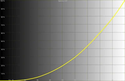

Gamma measured out at 2.47 and was a nice gradual track with no crushing of Black or White anywhere in the spectrum. This bore out with our viewing tests which showed an exceptional picture.
