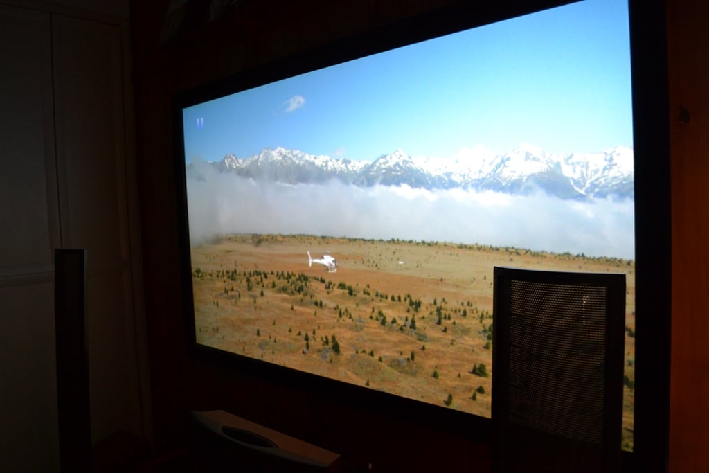

G4 Off-Axis Viewing (ambient light present)
Throughout my viewing tests the picture was stunning. Whites were white and blacks were blacker than I had seen before on this projector. I was finally able to watch movies at any time of the day, and under any lighting condition. With the lights on, the blacks were noticeably washed out and turned to a dark grey, but I was still able to see all of the black information. The rest of the color gamut was always vibrant. In fact, with lights on, the image was so realistic I thought it looked like a giant photograph. When reviewing other gear I like to have the lights up, so this was very important to me.
Lights on (much brighter in room than it appears)
I spent a significant amount of time looking for all of the issues that are inherent with ambient light rejecting screens, such as color shift and hotspotting. I tried different viewing angles, from zero degrees all the way out to nearly ninety degrees. I also used the viewing angle test included on the Disney WOW Disc. I never noticed any significant color shift, hotspotting, or even significant light output loss, even at extreme angles. The G4 gain chart (and gain charts in general) makes it seem that if you sit outside of the 60 degree viewing window the light loss is so great the image is rendered unwatchable. This is not the case. Yes, the amount of light reflected back at you does decrease, but A) in most situations I doubt many viewers will sit more than 30 degrees off axis and B) the image is still very watchable.
When asking for the G4 in for review, I was most concerned with hotspotting. The closer the projector is to the screen, the more likely you will notice hotspotting, and my Epson is just at the minimum recommended distance. However, hotspotting was either not noticeable at all or very minor. It shows up a bit more in the photos, but the photos aren’t a particularly accurate representation of the picture. In the “lights on” photos, the room was actually much brighter (I didn’t have a light meter on hand) than the picture shows. The screen also looks more washed out than it appears in person.

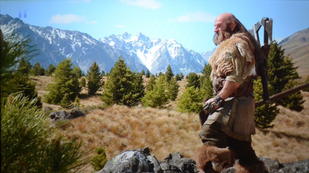

Lights off, cropped image
I think it’s the perfect solution for individuals who have a multipurpose room that will be used just as often to host people as it will be to watch movies, which is undoubtedly an increasing number of people. The possible applications for use are expanded exponentially thanks to the nearly limitless mounting options that Stewart offers. The screen could roll up completely out of sight, and come down from the ceiling or up from the floor only when you want to watch a movie. This means that a wall on which a TV normally wouldn’t work, like one with a picture window, a projector screen could work perfectly (Stewart’s new Plexus system is actually made just for this type of install).
