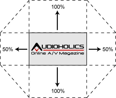

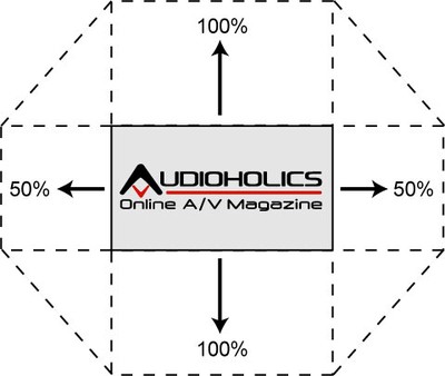

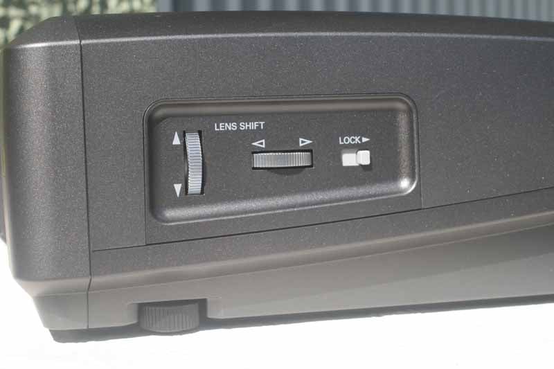

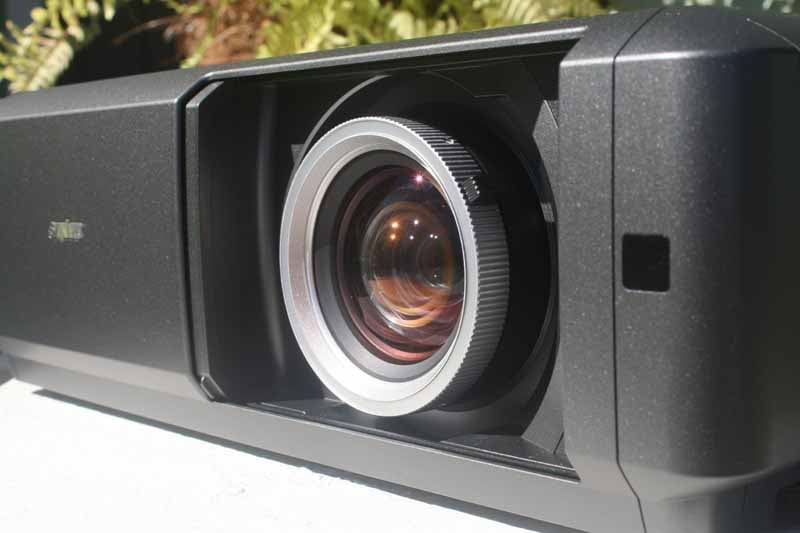

Placement of this projector is a
cinch, especially since the lens shift provided on this unit will allow 100% up
or down positioning of the screen or 50% left or right movement. Combined with
the 2x manual zoom lens, that means you can place the projector almost anywhere
and get it square to the screen without having to deal with the ill-advised
keystoning. The lens shift is facilitated by two knobs on the side of the unit
which we found to be stable and easy to rotate. Once the appropriate settings
are made and you have the exact placement you are looking for, a small locking
switch prevents the lens from drifting out of its fixed position.

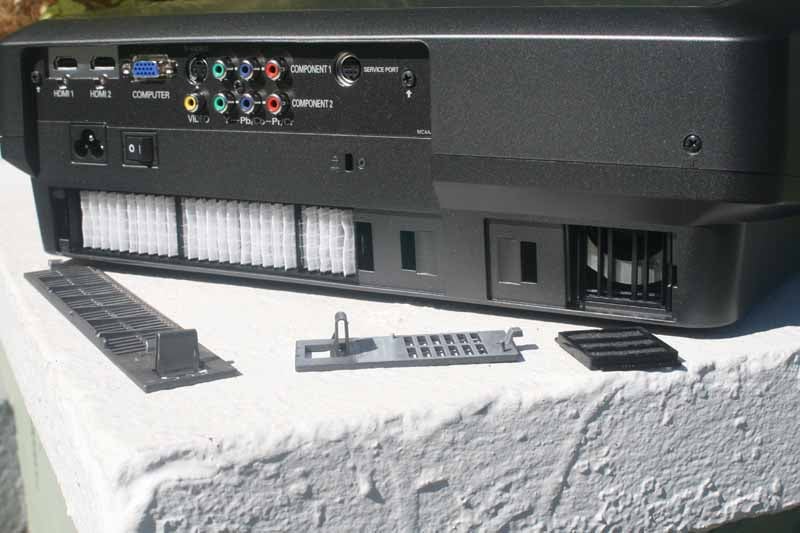

We've always been a fan of the way
Sanyo allows consumers to battle those pesky dust blobs. Their method involves
a blower tool and access into the projector to clean off the problematic area.
It's a decent design that is less sophisticated than some, but works, and
doesn't inflate the price of the projector in the process. The Sanyo also
includes easy-to-replace filters which are accessible from the back of the
projector. These are intake filters that keep dust and debris from entering the
projector as the fan takes in clean air to cool the system. The filters can be
vacuumed or brushed off, but should never be made wet.

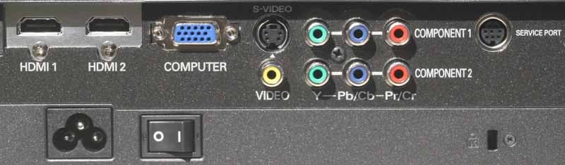

The menu system in the PLV-Z60 is essentially unchanged from the PLV-Z5 and we covered that in our other reviews so we won't rehash it here. It is extremely easy to navigate and one of the more ergonomic systems. Once an item is selected for adjustment, the menu disappears while the items are adjusted. This helps you monitor the picture in real-time as you make changes. Additionally, the menu "remembers" where you were, so the next time you activate it you are more or less where you left off. This is a boon for calibration. The remote control is also the exact same remote as was used with the PLV-Z5 projector. It's not fancy, but it is fully backlit and the light button glows in the dark for easy identification.
You can definitely hear this projector running. It's not nearly as quiet as some more expensive models we've tested and if you don't ensure it's far enough in front or behind you the ambient noise will compete a bit with quiet passages of the movie.

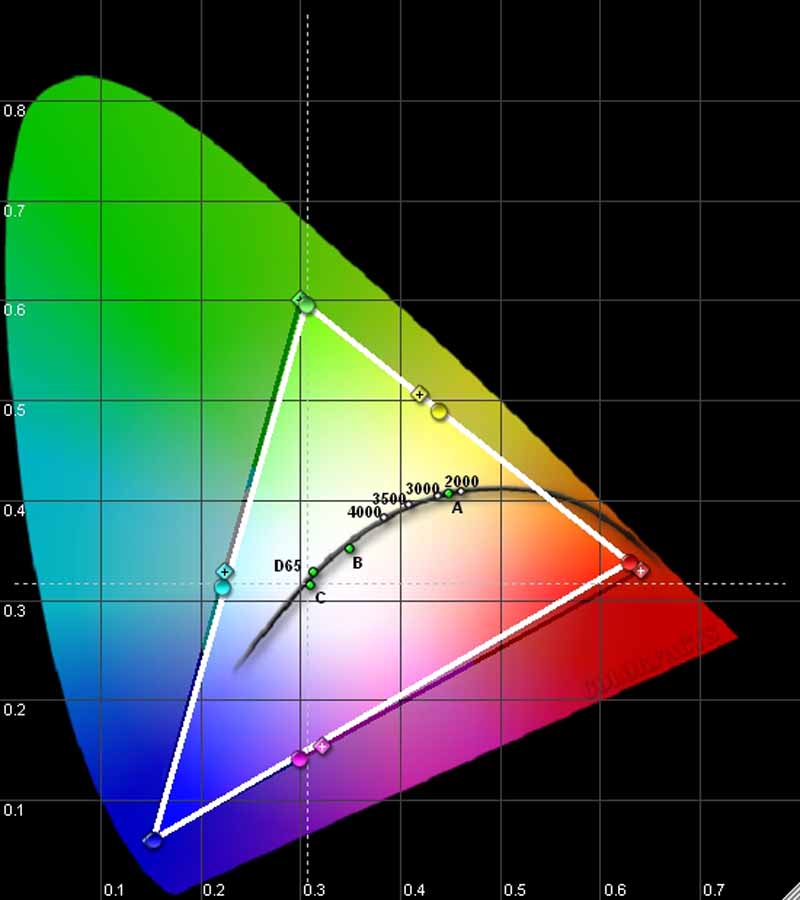

After the projector truly settled in, I read some average color temperatures in the upper range of 6550K while the average color temp for my selected mode, Pure Cinema, hovered around 7000K. The color temp and light output range at 100IRE looked like this:
- Brilliant Cinema - 61 cd/m^2 @ 7200K
- Creative Cinema - 46 cd/m^2 @ 7400K
- Pure Cinema - 32 cd/m^2 @ 7000K
- Natural - 50 cd/m^2 @ 7700K
- Living - 62 cd/m^2 @ 7500K
- Dynamic - 119 cd/m^2 @ 9800K
- Vivid - 119 cd/m^2 @ 9900K

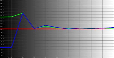

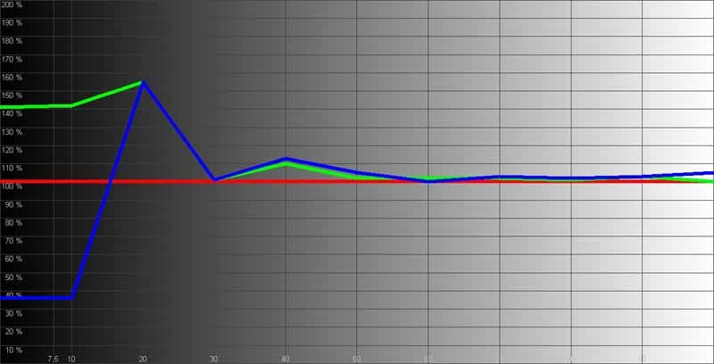

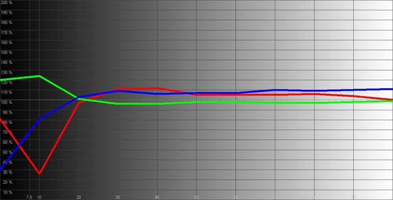

Taking some measurements I came very close to saying that this projector really doesn't require calibration. The truth is that it doesn't - not to look good, but it can look better with some adjustments to the RGB gain and offset levels. Here are some of the before and after measurements as measured by our reference Datacolor ColorFacts Professional software:

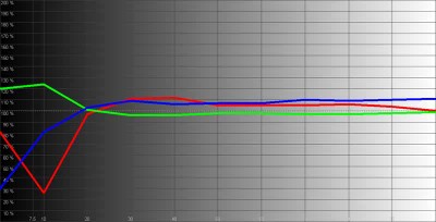

RGB levels before calibration (not bad at all)
RGB levels after calibration (tighter)

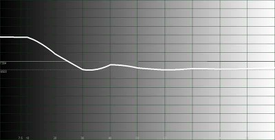

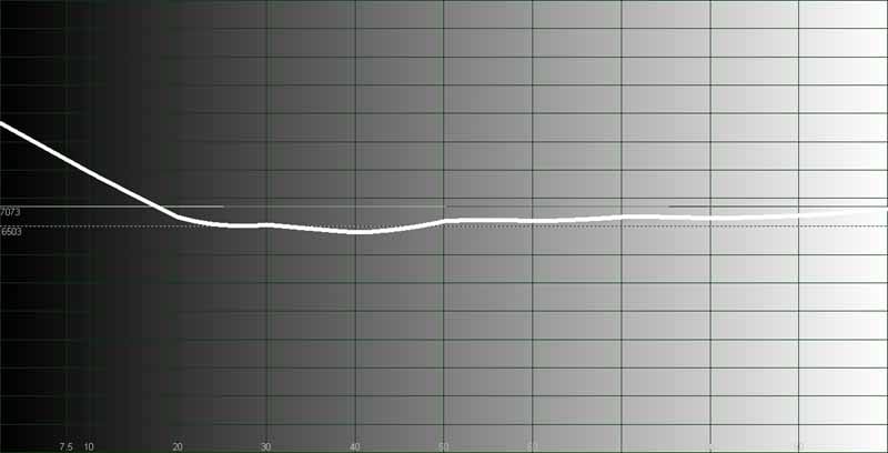

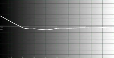

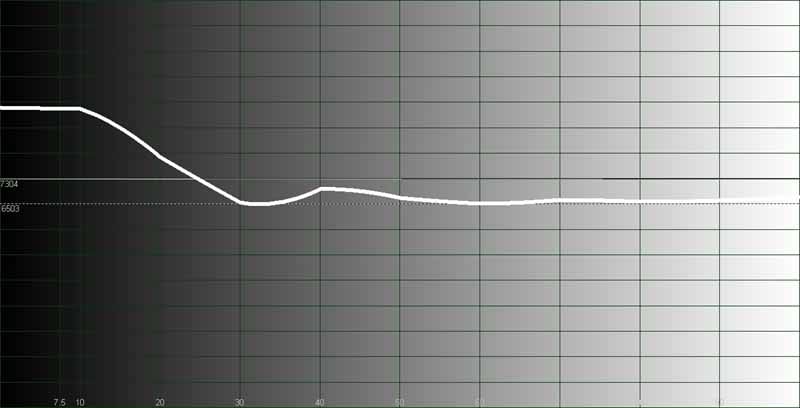

If RGB levels were barely brought in line, looking at the color temperature measurements yields a similar picture:
Color temp drifts above 6500K as light output levels increase
Calibration brought us nearly perfect to 6500K from 30 - 100 IRE

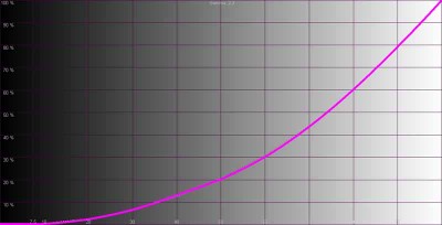

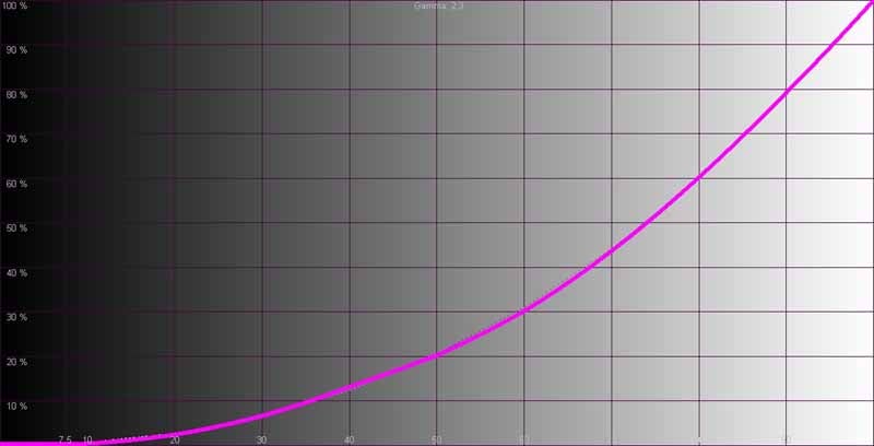

The gamma curve looked smooth and stayed almost unchanged (at ~2.3) before and after our calibrations:
Perfect

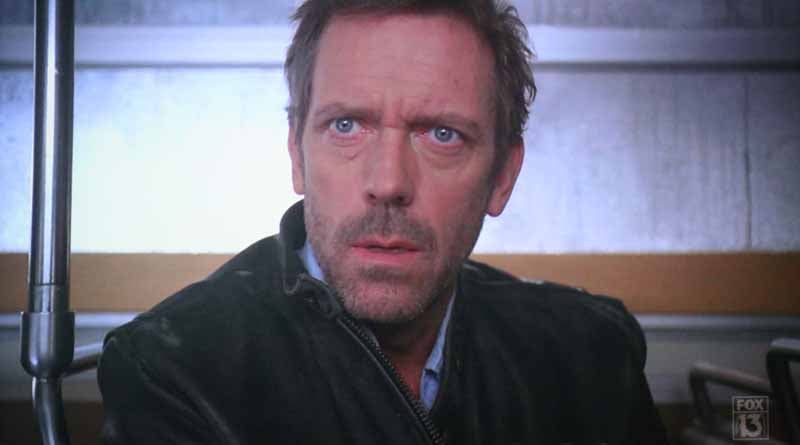

HDTV: House
Check
out House' hair and the black detail in his leather jacket. The PLV-Z60
certainly isn't the darkest projector I've seen, in fact that's probably the
area it needs the most work in, however the detail is never left out and you
can always get an accurate luma response that pulls every bit of info out of
the picture.

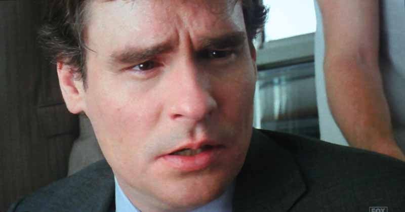

Looks like Dr. Wilson hasn't shaved in several hours according to this next snapshot.

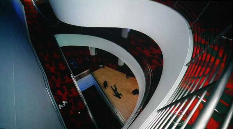

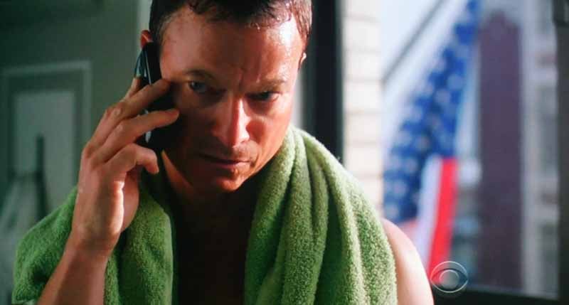

HDTV: CSI:
NY
The
CSI shows are always a great place to get some HD stills for any projector I'm
reviewing. They're colorful.... They look good... They're on 24 hours a day.
Seriously, if you can't channel surf and find some flavor of CSI you must be in
northern Canada.

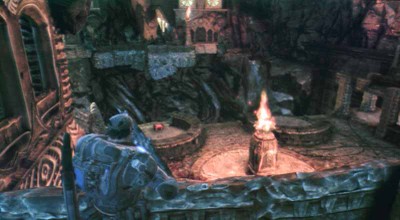

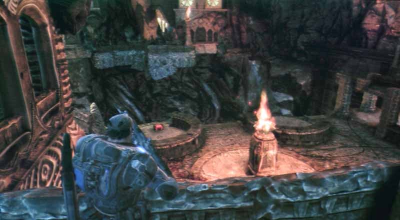

Xbox 360: Gears
of War 2
I'm
not necessarily convinced that the pics came out all that great, but Gears of
War 2 is such an incredibly cool game - and fresh off the presses - that I'm
going to include it. Just because I can. It's actually another great example of
how the PLV-Z60 can show incredible amounts of black level detail, even though it may not exactly sport the deeper blacks of

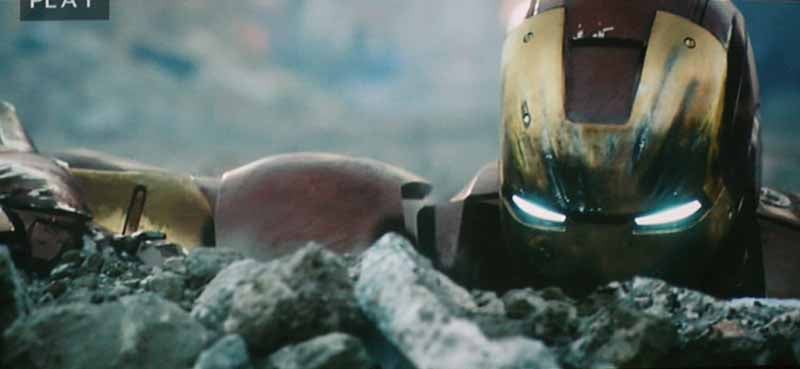

Blu-ray: Iron
Man
I
saw so many clips of Iron Man recently that I have probably sat through the
movie a few times, though not in a linear fashion. It's a very detailed and
colorful movie, and detail & color are what really make the Sanyo stick out
in the crowd.
By the way, the sound in this scene is off the hook!
