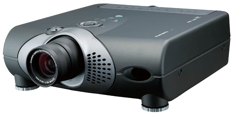

The
chassis of the Marantz VP-15S1 weighs 28.6 pounds. Yeah, I actually had to
exert effort when mounting the unit to my Peerless PRG-UNV Precision Gear
universal projector mount. Lucky for me my mount is literally anchored to the
top of my ceiling joists or I may have been concerned that the unit, with its
rigid die-cast chassis, could have pulled out of my ceiling. As it stands, you
can rest assured that this is a cut above the type of build quality found in
budget consumer DLP projectors.

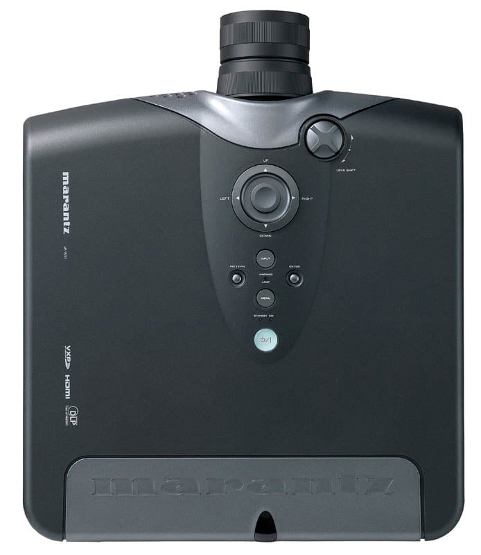

If you take a head-on look at the projector you can't help but notice the rather impressive looking glass protruding from the center. A custom-built Konika Minolta 1.45x zoom lens gives the VP-15S1 an edge that is readily-apparent when comparing the system to other high-end projectors. It was the same difference between an all-in-one point-and-shoot camera and a high-end Digital SLR model. The glass does affect the image and likely explains why the viewing tests we'll get into later were so phenomenally detailed.
Features
Marantz spared no expense on this unit, except to refrain from including a full 3-chip DLP system, that is. We'll leave the "Why aren't there 3-chip DLP projectors under $15,000?" question for another time, however and simply point out that the VP-15S1 includes Texas Instruments' Darkchip3 1080p DLP technology. Coupled with a high-end Gennum VXP video processing chipset, this projector packs a high definition video punch that is hard to beat. We've discussed the Gennum VXP GF9351-based system in the past, so we don't need to rehash its top of the line? deinterlacing, scaling, and motion adaptive noise reduction features here - oops, too late.
The light engine utilizes a large 98mm 6-segment color wheel that spins at a 5x speed (9000 rpm) which is apparently very favorable to people like me who perceive rainbow effect (RBE) everywhere there is a single chip DLP. I'm not going to say there isn't RBE, but it's mostly apparent on test patterns and doesn't rear its head too easily on typical program material. The color wheel was also very quiet from about 5 feet away, even though at this speed you would think it would sound like a small jet engine. The "fluid dynamic bearing motor" apparently works as advertised to reduce noise in this area.
One other item that deserves mentioning is the presence of vertical lens shift. This is extremely helpful in making sure your installation avoids keystoning, especially when you are unable, for whatever reason, to correctly align the projector at the exact proper height to the screen. I do have to take away marks, however for not including a horizontal lens shift - at this price there is simply little excuse for missing this important feature.
The system itself has adjustable feet which I can't imagine ever being used by anyone who can afford this projector (who wouldn't be utilizing a mount?). There are ventilation holes on the bottom of the chassis for air intake and exhaust holes on the front of the unit and on the lamp cover. The lamp is rear-replaceable, something I like to see in good-quality projectors since this means you don’t have to remove the unit from a ceiling mount in order to provide simple maintenance. There are dual IR sensors - one on the front and one on the back, so the included remote should be able to make contact regardless of how you mount the projector.

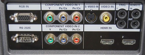

Connections
Taking a look at the rear panel of the unit you will see that Marantz has provided a pair of HDMI and component video inputs, both of which can support up to 1080p/24/60 resolution. The HDMI inputs included in this system are 1.3-compliant, supporting up to 12-bit Deep Color (per channel). There are also composite and S-video inputs, but if you use these I will personally come to your home and replace this projector with a $999 DLP unit since you obviously can’t tell the difference! I liked the inclusion of dual triggers and RS-232C is mandatory at this price point.

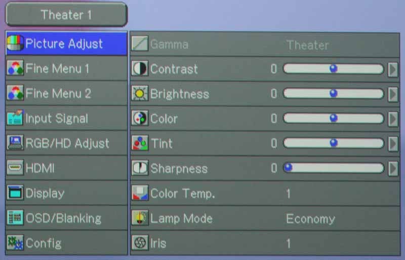

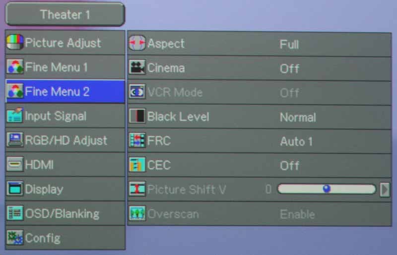

Menu System
The menu system for the Marantz was easy to navigate and its structure seemed to make sense. The picture mode is always located at the top left of the menu, and below are the 9 (count 'em) menu sections: Picture Adjust, Fine Menu 1, Fine Menu 2, Input Signal, RGB/HD Adjust, HDMI, Display, OSD/Blanking, and Config. We'll pretty much ignore Input Signal, which allows the manual configuration of what resolution the inputs will be accepting (always set this to Auto - the default). We'll also bypass making much ado about the RGB/HD Adjust menu which allows HTPC users to really tweak the resolution, position and phase of the incoming signal. If you have an HTPC and a propeller hat, you'll likely spend a lot of time here.
Adjust
Your basic picture controls are here,
including Contrast Brightness, Color Tint and Sharpness. You can also adjust
the global Color temp for the particular input and set the lamp mode to Economy
(recommended for theater use) or Normal. Keep in mind that the lamp will also
be adjusted automatically based on the Picture Mode you have selected. As with
most (but not all) projectors we've reviewed, Sharpness (almost a dummy control
in this projector) is best left at 0, and the Color and Tint controls can be
left where they are for best performance.
Fine
Menu 1
This
is where you will return again and again if you are calibrating this projector.
The Marantz VP-15S1 is one of the easiest projectors we've ever had the
pleasure of calibrating, and the easily accessible Gain and Bias (cut) controls
are largely responsible. We'll discuss Noise Reduction settings later and
Luminance Gain and Chroma delay are not for use with HDMI (our primary utilized
input for calibration and testing).
Fine Menu 2
This
menu allows control over the aspect ratio of the displayed image. You can
choose from Full, Normal, Zoom, V-Stretch and Through. These are becoming more
and more familiar to most viewers, so I'll just say to leave it on Full for
16:9 (and 4:3 if you like your images stretched to take up the whole screen) and
Normal for 4:3 aspect ratio content.  I
honestly have no use for the other modes, but feel free to experiment as you
see fit. Should you actually make use of the Zoom or V-Stretch modes, realize
that the "Picture Shift V" control unlocks to allow you to vertically
move the picture to optimize the screen presentation. As for the Black Level
setting: Set this to 'Expand' . Typically we always recommend leaving this to
'Normal', however with this projector 'Expand' is the only way to achieve
Blacker-than-Black response via HDMI. A CUE (Chroma Up-sampling Error) mode is
provided for 1080i input signals. You can leave this to 'Off' unless you
encounter a source requiring it (doubtful). Lastly, for standard definition
signals (up to 480/576p) you can enable or disable Overscan to eliminate the
outermost edges of the picture.

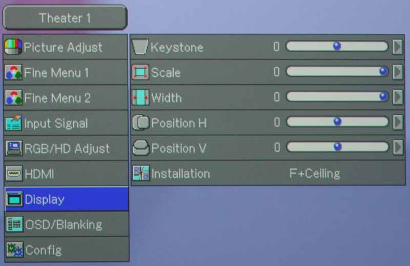

Display
Here you can set the vertical Keystone
(ridiculous given the presence of physical lens shifting), Scale the image down
(up to 70% its original size) and even change the Width of the image apart from
height. The Scale function is actually helpful in the event that you cannot get
the projector far enough away from your screen using the wide angle lens. Apart
from these features, you can adjust the horizontal and Vertical position of the
image on the DLP panel. This is also the place you'll go to configure the type
of installation you'll be using (Front/Rear Desk/Ceiling).

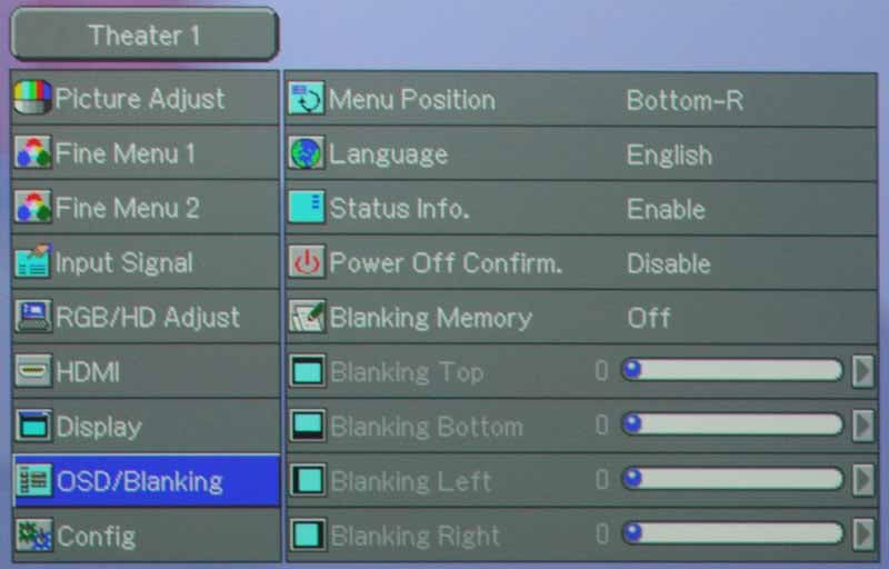

OSD/Blanking
The OSD/Blanking menu is set up to
allow you to control the menu function (Language and Position) and adjust
Blanking, or the amount of "underscan" of sorts is provided on each
edge of the image. This is helpful if you consistently have issues with
artifacts along one or two of the edges of the picture. You can store up to
three different Blanking configurations in the memory slots provided. There are
a couple more functions such as Power-OFF Confirm and Status Info, but they are
self explanatory.

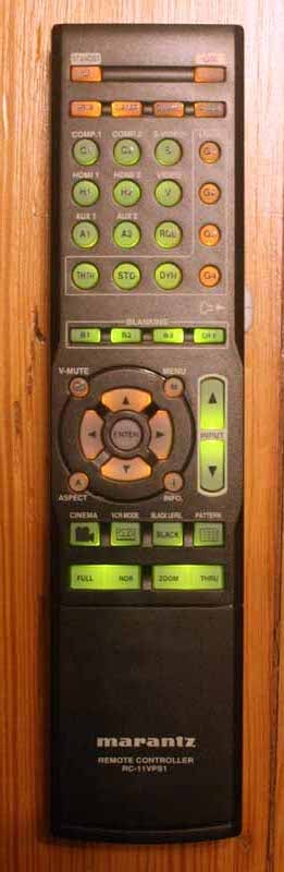

VP-15S1 Calibration, Remote Control, and Recommendations
I
really like the remote supplied with the Marantz VP-15S1. Aptly named the
RC-11VPS1, this is a fully backlit remote with direct access to all primary
functions, including Input selection and video modes. After initial calibration
it would be unlikely you'd ever need to actually enter the Menu system to make
any adjustments since the remote gives you direct control over Blanking, Black
Level, Aspect Ratio and even Iris, Color Temperature, Gamma and Lamp control.
The backlight function isn't automatic, but an easily accessible side switch
puts the light on for 10 seconds at a time. In addition to simply providing
backlighting, the remote actually separates various areas of the remote by
utilizing both green and amber coloring. There are four User/Gamma modes (only
the first three buttons work and they toggle up to 9 settings overall) which
allow you to store custom Picture Modes. With these modes you can literally
customize Picture settings until you have one for every day of the week… and
then a couple more.

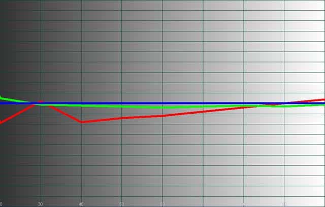

Calibration
We
took some before measurements after resetting the projector to its Factory
defaults. We then calibrated the system and compared the end results to the
original. For calibration we utilized datacolor's ColorFacts Professional software with a Spyder2 sensor
(tristimulus colorimeter). I have to say, this was one of those projectors that
really only needed to be set to the correct menu configuration. Calibration was
not something that dramatically improved the already excellent picture.
To begin with, and this is something I try to do with all projectors, we analyzed the various default Picture modes and took a look at how that related to color temperature. Using an 80IRE full field gray screen, we received the following results:
- Dynamic - 8700K
 - Standard - 6400K
 - Theater - 5300
Now, the default Theater 1 mode ran the projector with the lamp set to normal. With the Iris set to 1 and the lamp on Economy color temperature jumped to 5800. Select Color Temp 2 in the menu system and the results fall in line at 6400K. With that said, we recommend Theater 1 mode with an Iris level of 1 and Color Temp set to '2' for your default theater mode. This will give you excellent color as well as the deepest Black levels this projector is capable of delivering. The color reproduction of this projector is nothing short of brilliant for HD signals per our CIE chart which displayed our RGB measurements.
As indicated in the menu section, Black Level is a setting we typically tell everyone to leave at 'Normal', however with the VP-15S1 you will need to set this to 'Expand' if you are using HDMI and want to be able to view (or calibrate with) Blacker-than-Black signals. With this setting I made an adjustment to the Brightness control which placed it at -10 for optimal results in my room. The calibration images below came from the settings indicated above and were viewed on a 100-inch Stewart Studiotek 130 screen.

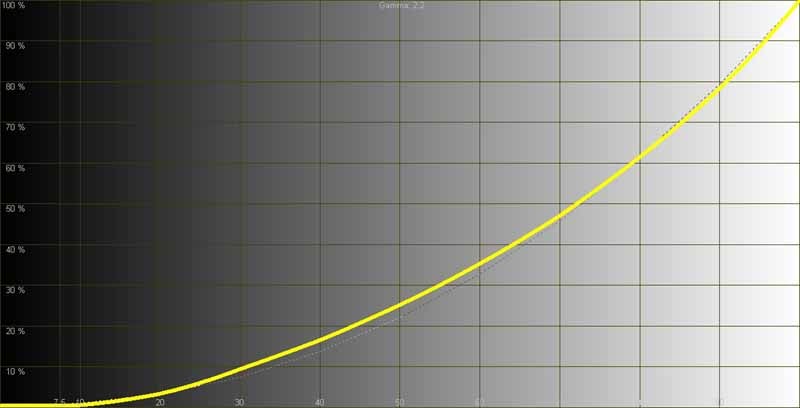

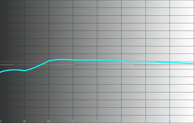

Gamma was a solid 2.2
and had a nice smooth response

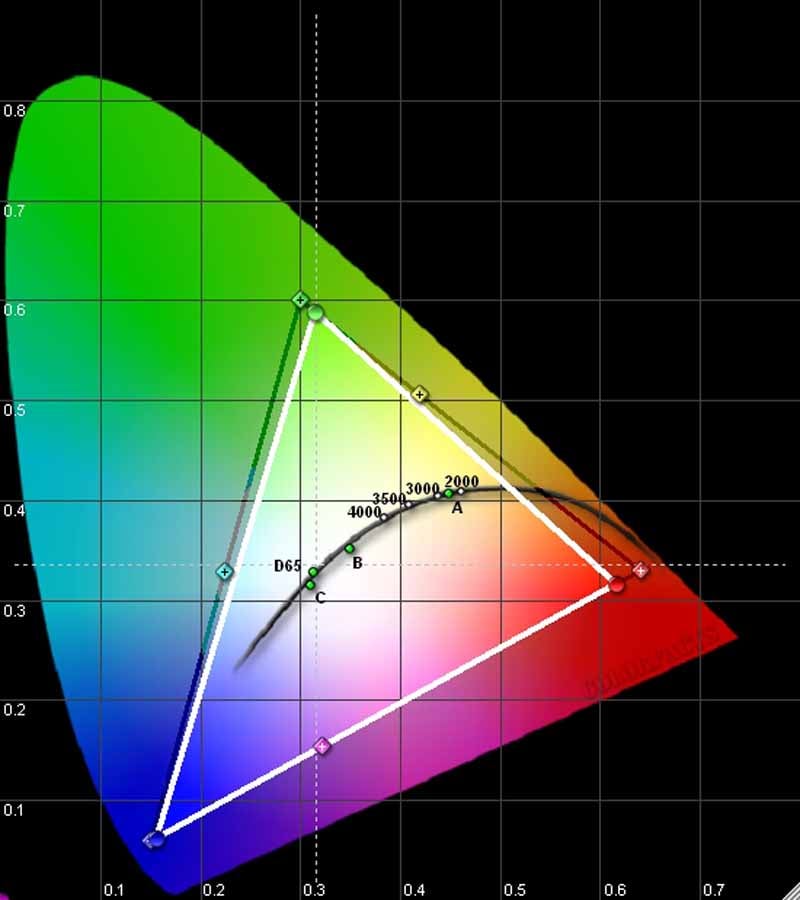

Color temperature was
generally excellent across the board
RGB levels showed
very respectable tracking and calibration only pulled in the values a little
bit more than the default
