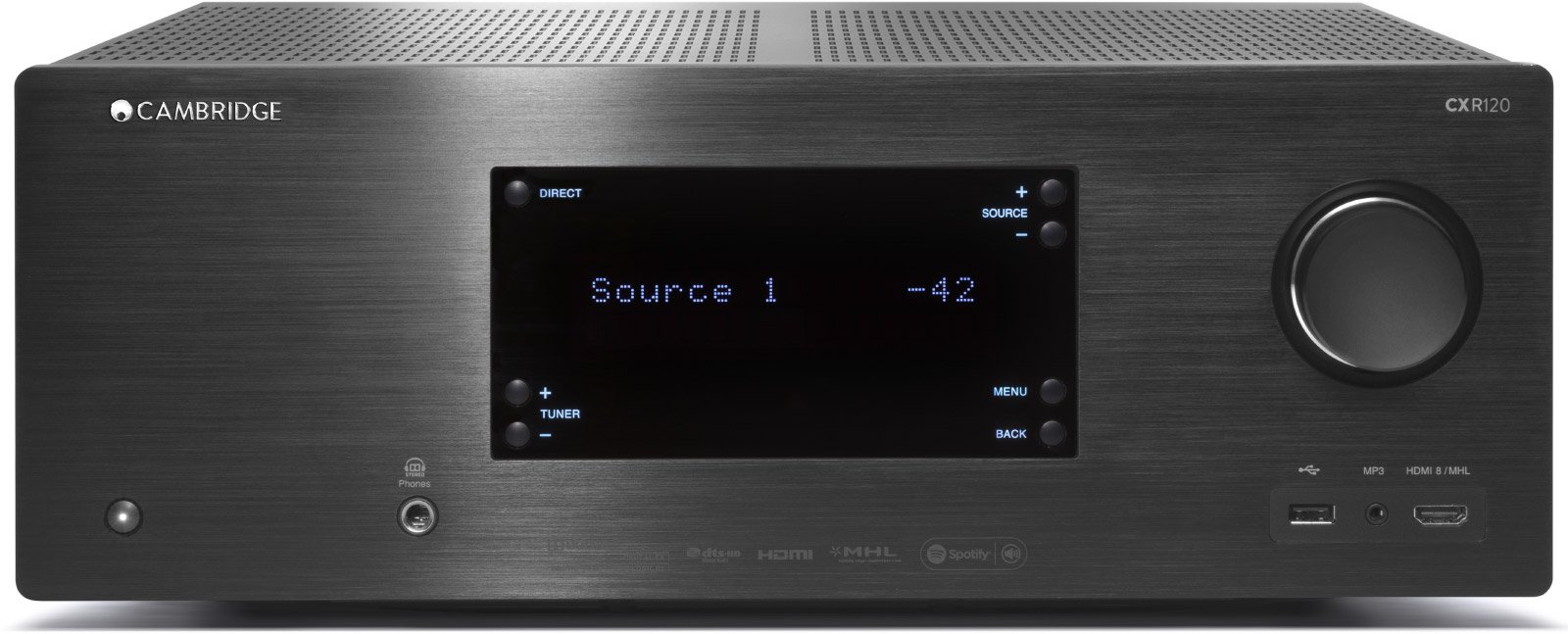

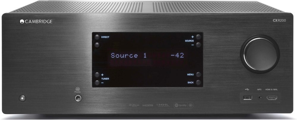

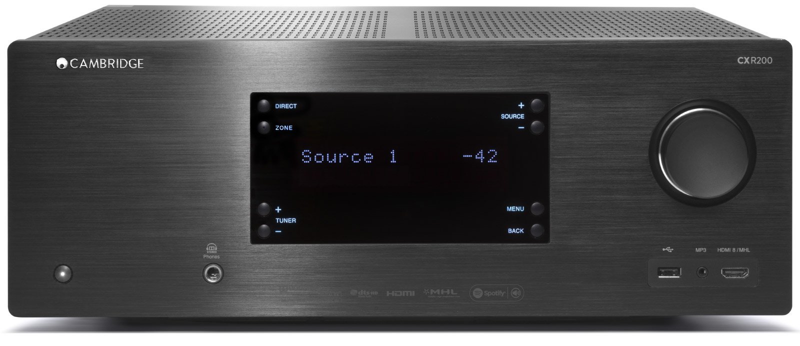

The Cambridge receivers have a clean aesthetic with a thick brushed aluminum face plate in gun metal gray with a large central led display. Buttons on the face are limited to a pair in each corner of the display panel, and only a volume knob, a power button, 1/4" TRS headphone jack, and a single front usb/1/8" TRS/ HDMI input port arrayed at the corners units front plate. No flip down plate or other knobs, buttons, or other doodads are present to clutter the front.

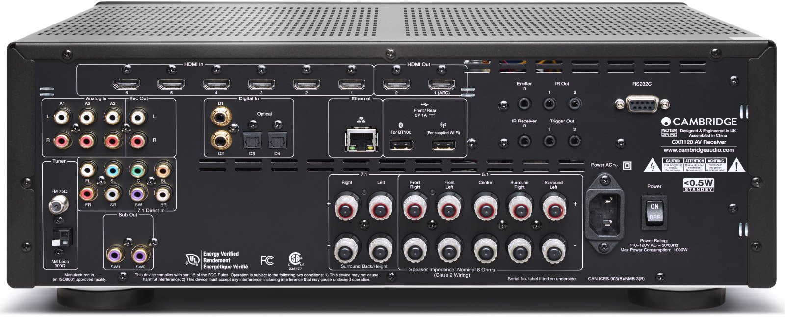

Connectivity is fairly up to date with a total of 8 HDMI 2.0 connections, 7 at the rear and the one previously mentioned front port, and dual HDMI outs with the first port supporting audio return channel functionality and another supporting Mobile High-definition Link (MHL). Cambridge states that both receivers are capable of 4K upscaling without going into much in the way of specifics about the chipset used. Cambridge also mentions Deep Color support, but as Deep Color is functionally defunct and effectively now wrapped into High Dynamic Range (HDR), which requires HDMI 2.0a, this point is likely moot.
Cambridge also highlights the receivers streaming capabilities. Each features three USB ports, two at the rear and one at the front, optional Bluetooth connectivity via BT100, and an Ethernet port that according to Cambridge support steaming UPnP playback from local NAS storage or web services such as Spotify Connect or the thousands of other streaming sites available on the web using Cambridge Audio's StreamMagic platform. Audio file decoding is extensive with a number of file formats that audiophiles gravitate towards including: ALAC, WAV, FLAC, AIFF, WMA, AAC, HE AAC, AAC+, OGG Vorbis (at 16-24 bit, 11.025-192kHz), SACD DSD through HDMI, and the requisite MP3, and at up to 24 bit/196 kHz bit depth and sampling frequency.

CXR120
The CXR120 is a 7.2 channel receiver with seven configurable amplified channels and two subwoofer outputs. The first five pairs of binding posts support a standard five-channel surround set up while the remaining two sets are configurable and marked surround back/height, suggesting home brew processing akin to Dolby Prologic IIz. At 30 pounds, the CRX120 outweighs other receivers with similar wattage ratings. Based on peak power consumptions with class A/B amplification at 50-60% efficiency, the receiver can easily provide more than 60 watts per channel from the wall.
Digital connectivity consists of 6 HDMI input ports at the rear panel and 1 additional input on the front with port one compatible with Mobile High-definition Link (MHL). There are 2 HDMI outs with the first supporting ARC. Legacy digital connectivity includes 2 coaxial and 2 optical inputs. Analog connections include three stereo inputs and one output along with a 7.1 channel analog input set. For internet connectivity, the receiver features 2 USB ports on the back, one of which supports an optional Wi-Fi adapter, a front USB port, and an Ethernet port. For custom installation and programming, the CRX120 has an RS232C port, an IR emitter port, an IR input, 2 IR outputs, and 2 12 volt triggers connections.

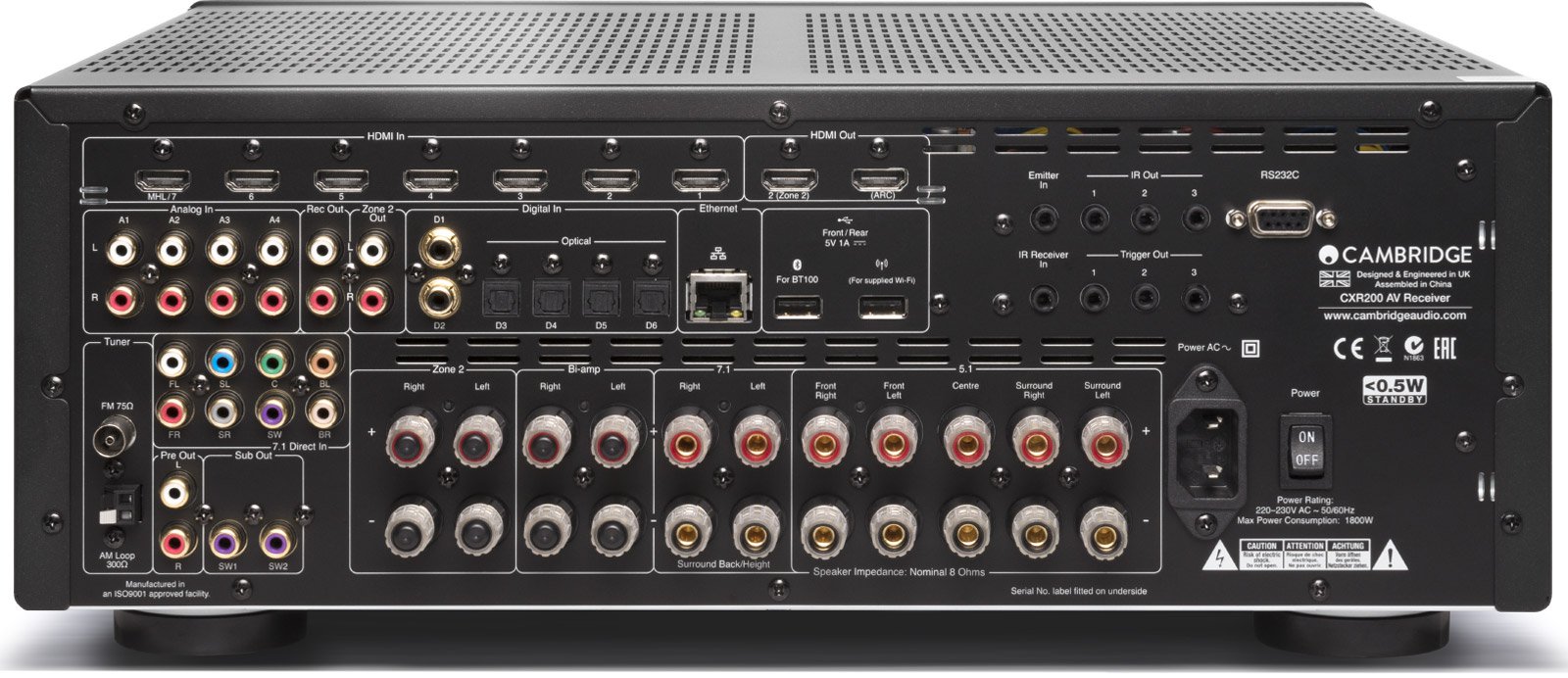

The CXR200
The CXR200 adds an additional 5 lbs making the receiver approximately 35 lbs and increases the maximum power draw from 1000 watts to 1800 watts, again, easily making the rated 120 watts per channel from the wall. The seven-channel amplifier can be configured for 7.2 or 5.1 with the remaining two channels configurable as height channels, bi-amping the front L+R, or to provide a powered zone 2 added from the CRX120. For connectivity, the CRX200 adds an additional rear HDMI port, two additional optical digital ports, an additional stereo analog input, and one each of the IR and 12 V trigger connections.
The CRX200 comes with four additional speaker terminals, with one set to support bi-amping the main L+R or a powered zone two option, both with a 5.2 main zone configuration. The receiver also comes with an additional IR and 12-volt trigger output.
