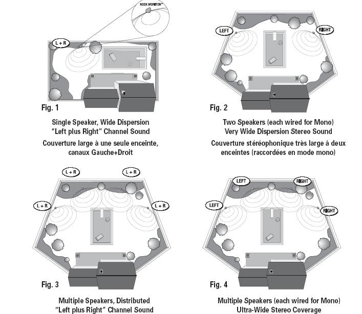

There are basically four ways to
setup these speakers:
- Single Speaker (L+R) Stereo Wired; Fig 1
- Stereo pair (Left / Right) Mono Wire; Fig 2
- Multiple Speakers (L+R) Stereo Wired; Distributed (4 or more); Fig 3
- Multiple Speakers (Left/Right) Mono Wired; Distributed (4 or more); Fig 4
Unless otherwise noted, most of my testing was done as stereo pair mono wired (see Figure 2). I tried wiring them as a stereo pair dual wired to each channel like I did with the Boston Acoustics Voyager RK62T rock speakers, but I didn’t feel there were audible benefits other than a slight increase in output volume and all it did was add further demand on the amplifiers by halving the load impedance. In addition, Paradigm doesn’t even mention this option in their user manual so I stuck to their four recommendations depicted in this illustration only.
Figure 1 is optimal for small listening areas where only a single speaker can be utilized but still provide stereo imaging. Figure 2 is preferred if the installation can accommodate two speakers as it provides broader coverage and better stereo separation. Figures 3 and 4 depict installations of 4 or more speakers are distributed in a large listening area while the latter configuration is the ultimate solution for wide stereo imaging and if the installer wants to get fancy, they can even configure for surround sound. Imagine getting 5 of these rock speakers, a few subs, a projector screen and display and some lawn chairs for some outdoor viewing that all of your neighbors could enjoy too. Hmm, perhaps I need to start building a collection of rock speakers!

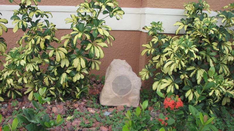

I prewired the front of the Audioholics Showcase home for four speakers in the front yard; two by the front of the house in the landscaped area to provide coverage to people walking on the sidewalk, and two by the front porch to cover the sitting area and front entrance. I installed the 60-SMs in the landscaped areas directly off the front wall of the house about 20 feet apart.
Because of their smallish size and very natural
looking design, the 60-SMs truly blended seamlessly into my landscaping. I found that once I fired them up most people
walking buy couldn’t locate where the sound was coming from. One of my neighbors commented that he wished
he had that quality of sound in his own home, let alone his front yard. I was a bit concerned about all of the
attention they were getting once I unveiled their location that I opted to
install the supplied security stake and cables.

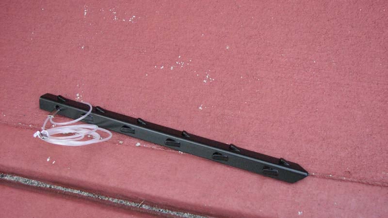

Using a rubber mallet and an old piece of concrete I had laying in the
garage, I pounded down the stake all the way into the ground once the wire was
looped through the loophole in the speaker cabinet. I rested well that night knowing that the
rocks were anchored down. It isn’t
everyday that I leave a pair of $500 speakers outdoors, at least the Paradigms
were somewhat secure do to their incognito design and stake grounding
scheme.

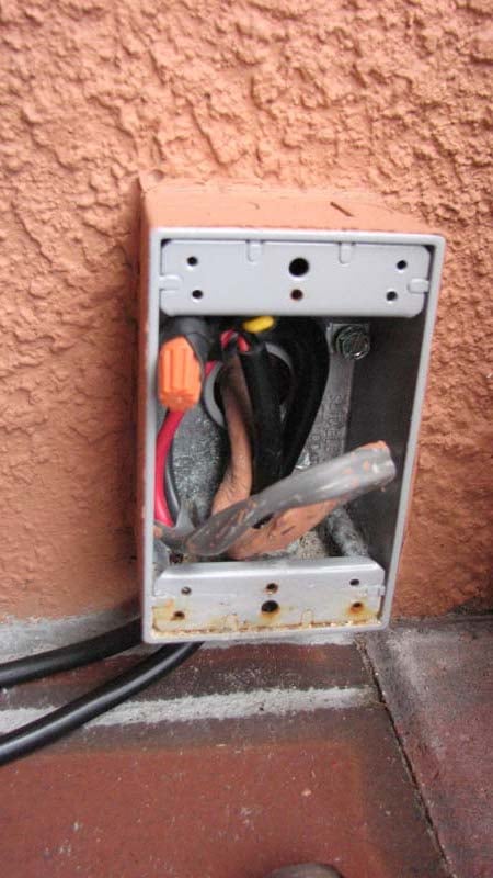

I unfortunately took my prewiring of my home to the extreme by running all 10AWG speaker wires to every location. This made it quite a challenge to connect in wall volume controls as well as self containing the wires in junction boxes. A note to installers and audiophiles alike, you’re better off running 14/4 for redundancy and better flexibility. You can parallel them to yield an effective resistance of 11AWG. Paradigm provided standard wire nuts you get when buying ceiling fans or electronic fixtures. As an added precaution, I also used electrical tape in conjunction with the wire-ties to ensure total isolation and reduce the chances of oxidation from being outdoors.

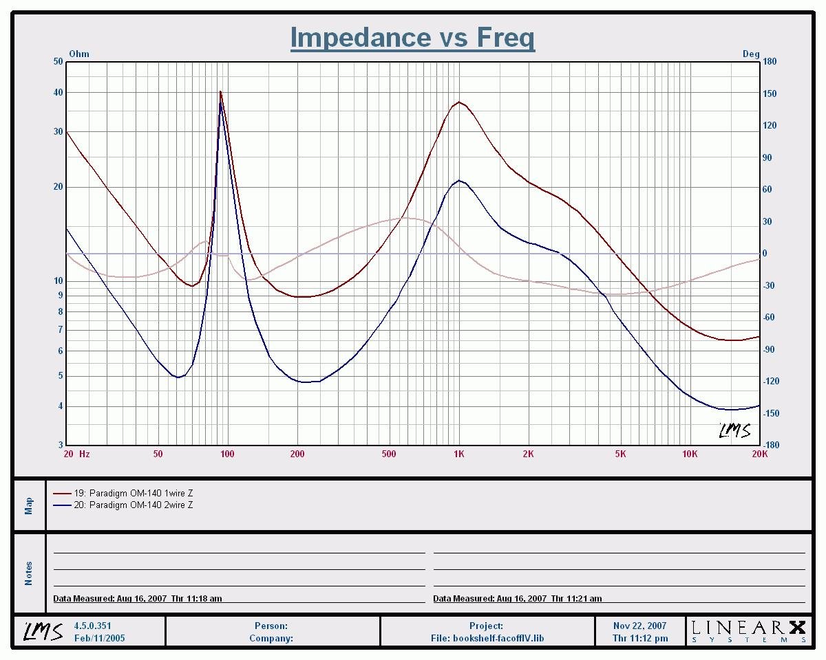

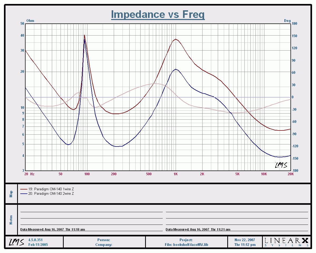

Impedance / Phase
Measurements of the Paradigm 60-SM
The single wired impedance of the Paradigm 60-SMs is roughly 8 ohms while the two wired impedance is (as expected) ½ of that – 4 ohms. These speakers are a tad more reactive than the Boston Acoustics RK6T2s I previously reviewed, maintaining a +30/-45 degree phase within the entire audio spectrum though never below 4 ohms (two wire connection) at any frequency. This demonstrates deliberate and careful crossover design to ensure these speakers will work well with a wide variety of amplifiers. I still recommend using only the single wired connection to a common amplifier output since I found very little sonic benefits of running them dual wired to each amplifier channel and it only needlessly stresses that particular amplifier more than it needs to. Reserve the two wired connection scheme as per the installation diagrams provided by Paradigm previously mentioned in this review.

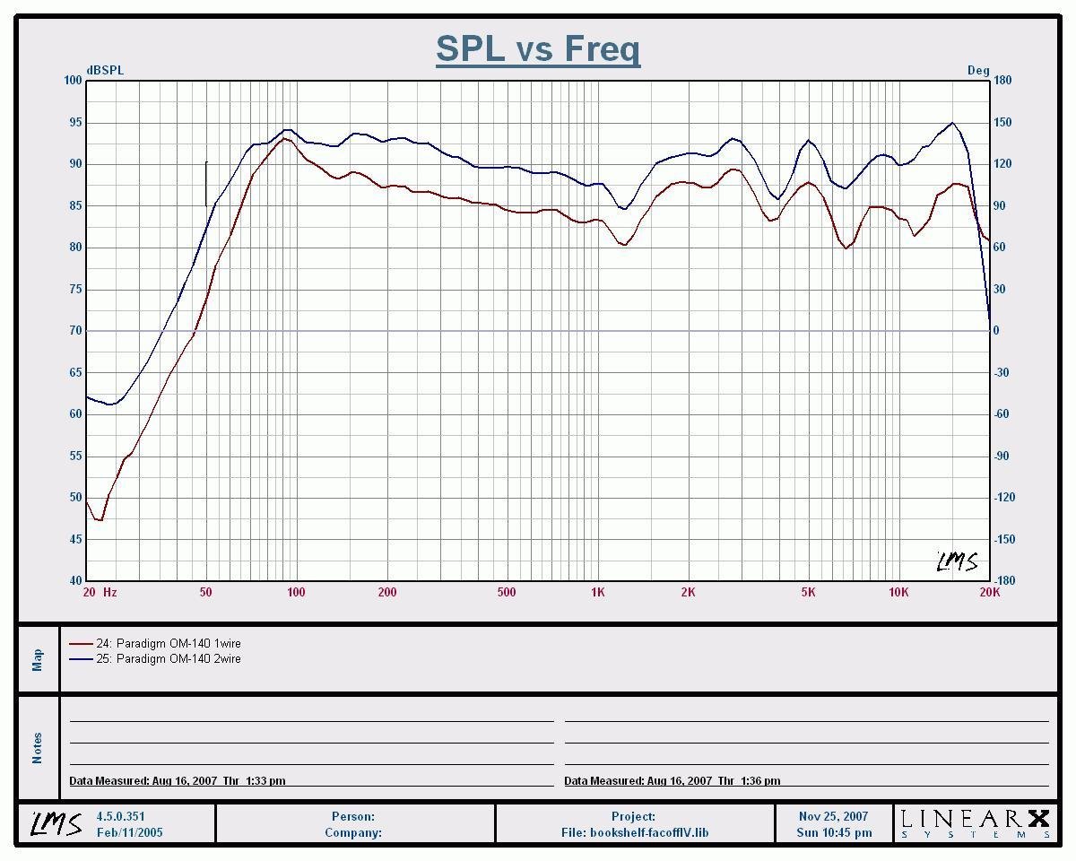

In Room Nearfield Frequency
Response (1/12th octave smoothed) of the Paradigm 60-SM
I measured these speakers in the Audioholics showcase theater room placed on the floor with the mic 1 ft away and up slightly above the acoustical center of the speaker. The results were generally very good, with a -3dB point roughly around 60Hz and measuring +-3dB from 100Hz to 10kHz (ignoring the 1.2kHz dip which is likely a measurement anomaly). Though my measurement shows a slight recession in the mid frequencies, I didn’t find the vocals to be too laid back but instead perhaps lacked a bit of body when directly compared against the more expensive RK-6T2s. As you can see, the two wired connection did yield an increase in SPL output at the same given volume control level but I would again caution the user to stick with the single wire connection per amplifier channel or follow the manufacturers alternative connection schemes that best suite your application. To get some additional bass impact, I recommend placing these speakers against the wall of your house but of course do listening tests before deciding on their final location and staking them into the ground.
