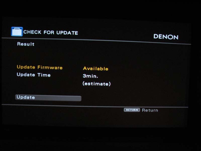

How to initiate firmware update:
  • Turn off power of AVP-A1HDCI
  • Connect straight thru Ethernet cable from your router to the AVP-A1HDCI
  • Enter “Manual Setup” > “Option Setup” area of OSD
  • Select “Firmware update”
Do NOT use a wireless connection when updating firmware and make sure there are no power interruptions during this process. The update can take up to one hour which during the process will render your AVP-A1HDCI/ AVR-5308CI inoperable.
