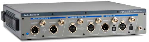

Audio Precision, the recognized standard in audio test and measurement, introduced the APx515, a new two channel audio analyzer optimized for production test and starting at only $6200 in the US. Despite its low cost, APx515 still has excellent performance, with a typical THD+N of -106 dB, 24-bit FFTs, and 192k digital I/O. With respect to the other instruments in the APx Series, it sits just below the APx525, whose lower THD+N and chip-level connectivity options make it more appropriate for R&D.
Comprehensive production test in 3 seconds, easy automation AND low cost
With the High Speed Test option, APx515 can make all the key audio measurements in less than three seconds. In stand-alone mode, test sequences are created by selecting from a list of common audio measurements and saving a single project file. On an automated line, a master application can control the APx515 directly using the .NET API or APx LabVIEW driver. In either mode, the operator can control APx with a keyboard, footswitch or barcode scanner, or the system can be totally automated. Rich graphical reports can be generated from MS Word templates, or data can exported to CSV, injected into a database, etc.
Trusted results between vendors, designers and manufacturers
All APx audio analyzers use the same software, making tests & results easier to share between vendors, R&D and production facilities anywhere in the world. For example, a test engineer using an APx525 can create a production test sequence and email it to a contract manufacturer whose APx515 will run the project natively. Performing quality assurance on the production line, the APx515 operator can save a recording of the actual output of a device under test and email it (along with the 515’s settings) in a single project back to Engineering for further analysis. Every APx515 sold comes with a three year warranty and includes an ISO17025 accredited calibration.
