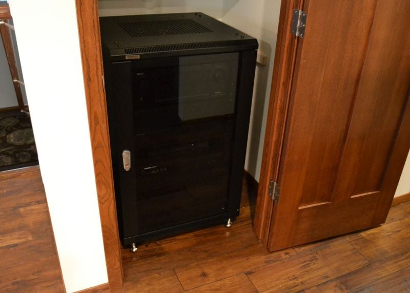

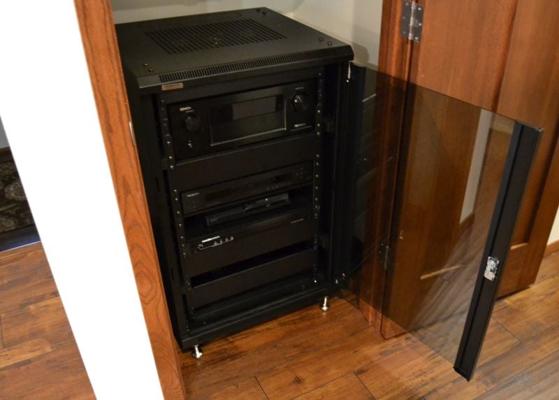

RE18 Front View
RE18 front view, glass door removed

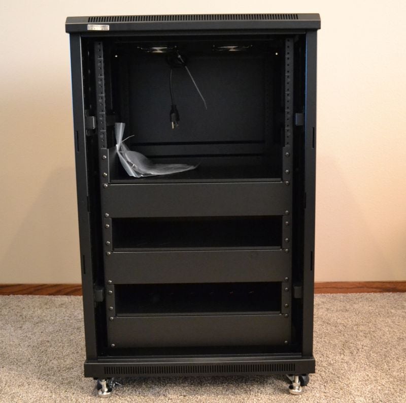

As the description states, it comes “fully assembled.” It’s packaged with three 2U shelves and three 2U blanking panels, which are also pre-installed but can be removed and moved. Each shelf is rated for up to 50lbs, so they should handle most any modern receiver or amplifier. Omnimount sells the 2U shelf and blanking panel separately, if you need them. They also sell a 5U shelf that includes a rear support rail and is rated for 100lbs.

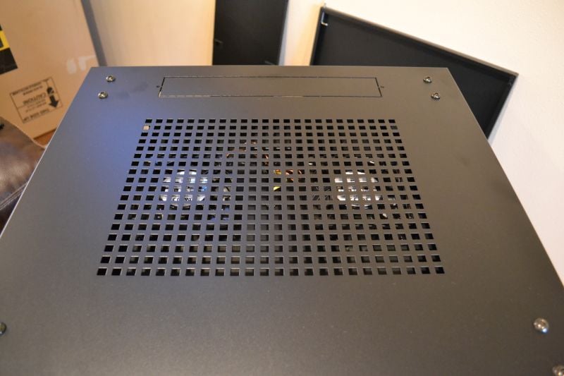

Unlike skeleton racks that are absent of any sort of doors, panels, or casters, the RE18 is fully loaded. It features a lockable glass front door that can be adjusted to hinge on the left or side of the rack. A solid metal rear access door can hinged on either the left of right side. Metal panels flank the left and right sides of the cabinet. Both the doors and panels be easily removed for easy servicing or improved open-air ventilation. Speaking of ventilation, pre-installed cooling fans on the top of the rack really set the RE18 apart from the competition. When used in conjunction with knock-out panels on the bottom of the rack, cool air can be pulled up from the bottom of the rack and hot air pushed out the top.
The RE18 feature list rounds out with a caster base that provides easy placement inside closets or against walls. When in place, adjustable feet level and stabilize rack without interfering with the casters.

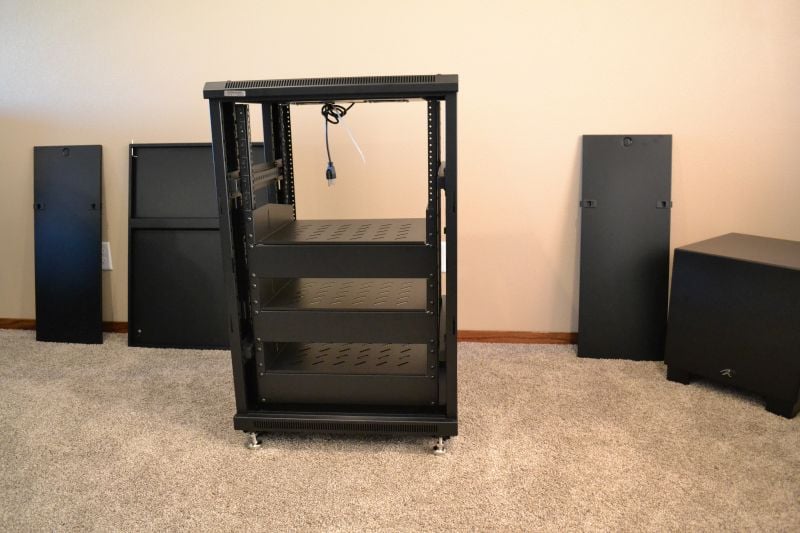

At this point in the review of speakers or an AV receiver, I might talk about how the things sounded, but there isn’t much to say about an AV rack beyond its basic functions. It needs to be sturdy, holes need to be threaded properly, doors and panels need to fit snugly, casters need to roll smoothly. So, right after unboxing, I started taking things apart, swapping around pieces, and in general seeing if I could find anything that didn’t function quite right or wasn’t manufactured properly. I’m happy to say that everything worked perfectly. My only note would be that one of the feet was a little cockeyed, but it still functioned to level and secure the rack.
 RE18U rack parts
RE18 rack parts laid out

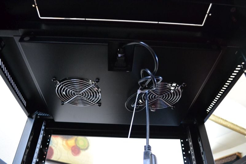

The built-in fan worked well. It moved a healthy amount of air, keeping my equipment cool, and was pretty quite in doing so. It is AC powered, so it won’t work with any of the DC fan controllers on the market, which is a bit of a downside. It also does not feature an on/off switch. When it is plugged in, it is powered on. If the rack is away from earshot, once solution for powering the fan would be plugging it into a switched outlet on the back of an AV receiver or cable box. Another option would be to purchase something like a Niles AC3 voltage triggered AC outlet that would hook up to the 12v output on an AV receiver. I’m sure there’s a way to hook up a temperature controller so the fan would only kick on at a set temperature, but I’m not aware of any off-the-self products that would achieve this effect with AC powered fans. If you know a method, please mention it in forum section at the bottom of the page.
Buyers should note that the lock on the front and rear doors is not designed to deter determined thieves, nor does it need to be. Its purpose it to keep unauthorized individuals – Joe at the office or your toddler – from fiddling with the equipment. Still, even a basic lack will likely prevent many casual thieves.
RE18 Fan Top View       RE18 Fan Bottom View
RE18 fan
The included shelving and blanking panels worked great for my setup. I fit a surprising amount of equipment in the rack without purchasing additional shelving, including a Denon AVR-X4000 receiver, Oppo Blu-ray player, PS3, 5 port switch, and URC RF remote base station. I did purchase rack ears for my Panamax power center and a 1U blanking panel to go above the receiver. I was able to fit all of the equipment in the rack without issue.

I left a 1U space open for the yet-to-be-installed subwoofer amplifier for an in-floor subwoofer.
