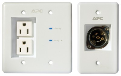

apc-in-wall-power
For projectors & wall mounted TVs, "power bridge" type products allow you to only buy one surge protector for all your electronics

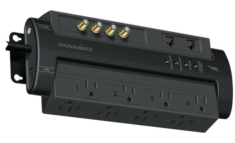

Panamax M8-AV-Pro
The Panamax M8-AV-Pro is a solid surge protector with both coax and Ethernet connections

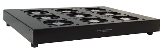

cool components fan
In addition to cabinet ventilation, you can get fans designed to set directly on top of components

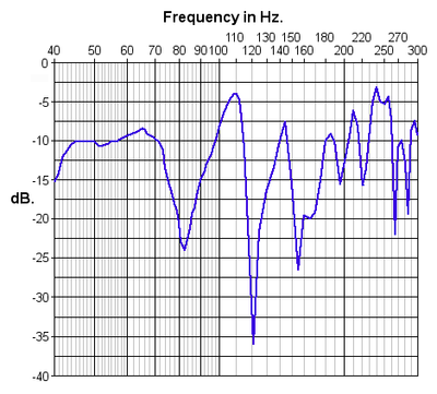

poor frequency response
This is an awful, but typical, frequency response plot. Notice the -35dB null at 120Hz.
If your listening position happens to be in a dip, you will likely keep turning up the subwoofer volume because it sounds like the bass is too quite. However, increasing the volume won’t help because it’s an issue with the room, and you will end up driving the subwoofer harder and harder until the point of failure. By moving the subwoofer and/or listing position to a more ideal position, you can enjoy more even bass and won’t be tempted to turn up the subwoofer volume to overcome an issue with the room.
