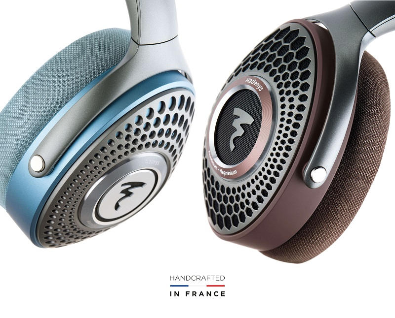

New-Look FocalFocal revolutionized its lineup with two new passive headphones in 2024 with the closed-back Azurys and the open-back Hadenys. Employing the Bathys chassis, the new line of passive headphones represented departure from the familiar French tank frame, bringing a slim fit, enhanced portability and lower than expected cost. The French speaker company may have hit a sweet spot in price, performance and portable comfort that brings Focal's sound to a broader headphone audience. In this review we’ll take a closer look at the Azurys closed-back headphones.
Like its open-back brethren, Azurys is packing Focal’s 40-mm Aluminum/Magnesium M-shaped dome dynamic driver found in many of Focal’s most popular high-end designs. The Al/Mg driver may have been turned for different models and different sound profiles but one constant remains, this driver is renowned for sensitive resolution and a dynamic range that can punch and slam with the best of ‘em.
Azurys, Focal’s passive closed-back headphone brings the technological DNA of its larger, high-end forebears to a smaller, more accessible headphone with its own unique esthetics and sound. Azurys isn’t just a compact Celestee for budget conscious fans of smaller, lighter headphones. I personally love Focal's larger French tank headphones and personally bought the Radiance that has grown into my favorite closed-back. But I have to give Focal credit for modernizing its lineup, the new chassis hits a sweet spot with accessible options that bring more mainstream consumer appeal.

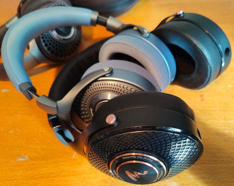

Azurys & Radiance
Azurys & Radiance - The size difference looks bigger than it feels on the head. Focal's new compact designs are perfect for those less committed to larger headphones.

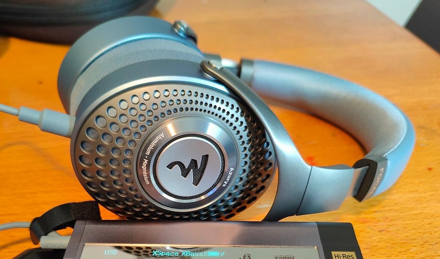

One way to describe Azurys might be; visually distinctive. Focal says the pale blue finish is inspired by azurite stone. While surely a beautiful stone, the shade of blue beneath the honeycomb pattern of the outer earcup wouldn’t have been my first color choice. But to be honest, it grew on me over the time I had Focal’s loaner unit in for review. Thank you, Focal!

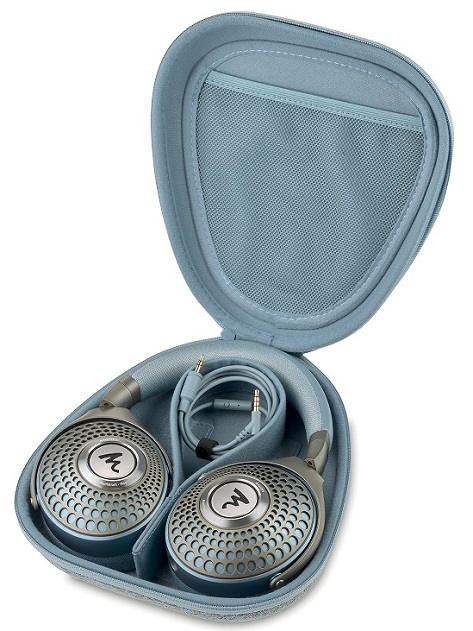

Azurys carrying caseAs an efficient closed-back, Azurys is made for taking your music virtually anywhere. The more I used it walking around the city and catching glimpses of it on my head in a window, I began seeing a certain charm in Azurys’ metallic blue esthetic. The metallic look of the magnesium honeycomb grill pattern of the outer-earcup looks and feels solid, delicately balanced with the blue that contrasts with the dark Focal flame logo, lending a presentation of depth. I started seeing Azurys as looking more like a well engineered instrument than something your grandmother might wear to accessorize.
The smaller Bathys-style frame makes Azurys a practical choice, especially for a closed-back that you’ll want to take with you on trips, whether out of country or just to the coffee shop. Like Bathys, the earcups swivel so you can lay Azurys flat in its compact case. Compared to Focal’s traditional headphone design, these require much less commitment to fit its case into a travel bag.
Overall comfort is excellent. The headphone is light at roughly 306-grams with a soft breathable fabric covering memory foam pads and enough clamp force to maintain a solid seal without turning long listening sessions into jaw workout. The fabric is more breathable than most imitation leather earcups I’ve worn. The smaller overall footprint does come at a cost in space inside each earcup where every square millimeter counts. With an inner-earcup opening height of 5.8-centimeters (2.2-inches) Azurys is only about 4-mm (0.15-inches) smaller than Focal’s premium closed-back Celestee, which is roughly equal to all of Focal’s larger traditional designs depending on the ear pads. Despite my larger than average head, both Azurys and my older Radiance fit comfortably around my ears.

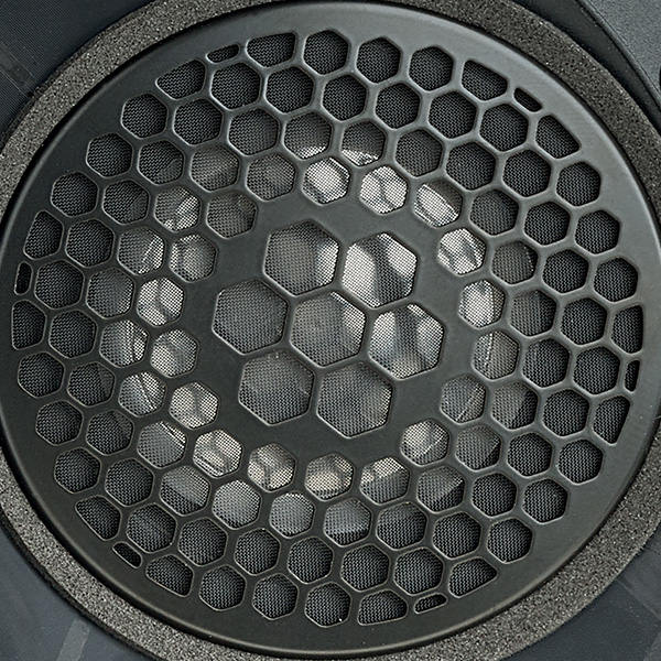

Al/Mg Driver
Focal's legendary Al/Mg driver, the heart of some of the best headphones ever made.

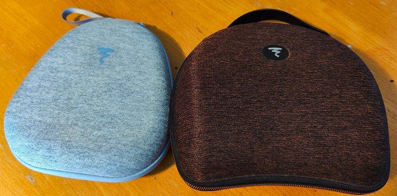

Azury & Radiance Cases
Azurys & Radiance cases side-by-side comparison.
