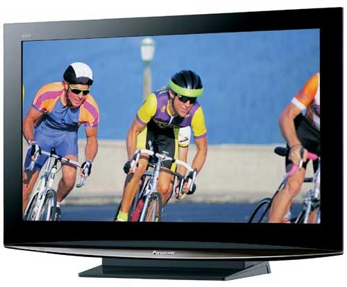

TC-37LZ800 Build Quality and Menu Setup
TC-37LZ800-angled2.jpgPanasonic's use of IPS (In-Plane Switching) in their LCD panels has been a favorite choice of ours for the simple reason that light output remains almost constant from all viewing angles. When you're not the only one watching TV in a room, this can be a big deal. The TC-37LZ800 uses a newer generation of this technology called IPS-Alpha (see our Tech Note) which improves upon earlier designs. Panasonic is the #3 plasma display manufacturer in the world (beat out of the #1 spot just this year thanks to an emergence in smaller sized displays that flooded the market), but the company seems to have a very good understanding of what makes a great LCD television.

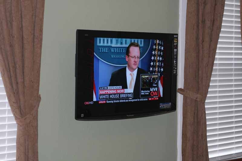

The face of the TC-37LZ800 sports a wide bezel with a piano gloss finish. The screen, inset about 1/4-inch into the unit utilizes a glossy "plasma-like" Plexiglas surface that is highly reflective but presents an incredibly vivid picture. The whole TV is less than 4-inches deep, not counting the little "chin" at the base of the monitor that adds maybe 1/3 of an inch. The right side of the television (looking at it from the front) has a membrane control surface for Power, Channel, Volume, Input and Demo functions. Nearby are the side inputs, which include HDMI, composite, analogue audio and an 1/8-inch headphone output. Just below is an SD/SDHC card (up to 16GB) reader for cards containing JPG, DCF, and/or EXIF formatted image files.

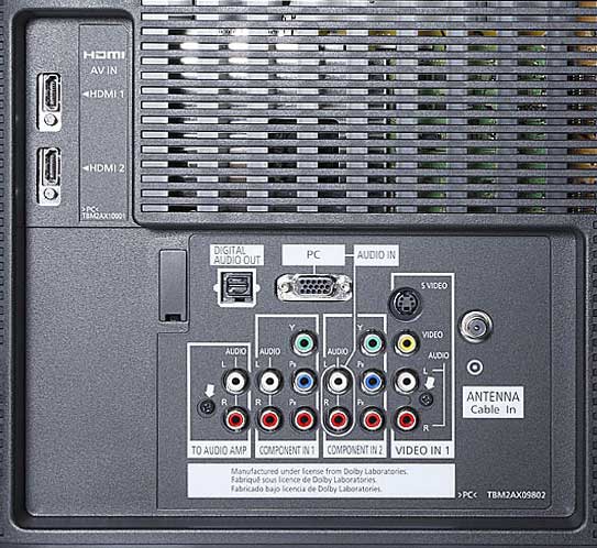

The back of the TV supports two HDMI inputs, two component video inputs, a PC input and a shared composite/S-video input. Separate stereo audio channels are included for use with all of the non-digital inputs (HDMI requires audio be sent over HDMI if you want to use the TVs internal speakers).

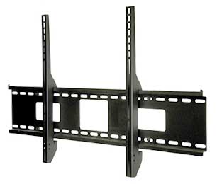

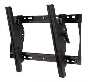

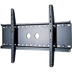

One very important thing to note is that the HDMI inputs will be covered up if you use a full size traditional flat panel mount that includes a full face horizontal mounting plate (see below).
The mount on the left will not play well with accessing the two rear HDMI inputs on this TV; the model on the right will give you a fighting chance but is still not a guarantee and is sure to be awkward.
This type of open-backed mount is going to be your best bet.

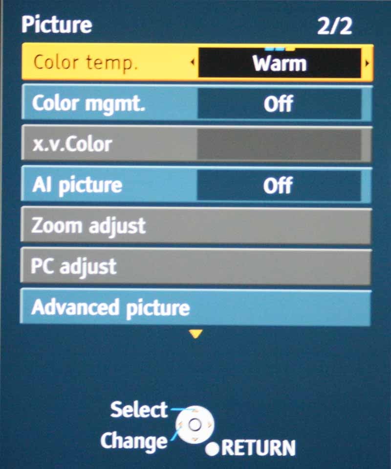

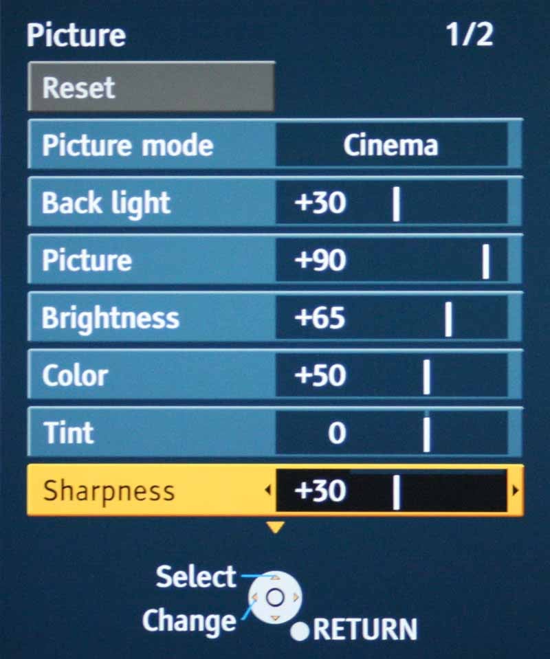

menu-picture-1.jpgThere is a lot to like about the menu system on the Panasonic. It's easy to navigate and it's very simple. Of course, that's also because there aren't a ton of truly advanced picture controls (at least not until you venture into the Service menus which we won't get into here). Primarily, after first setting up the display, you'll land squarely in the Picture menu for most of your tweaking. Here you can select between Cinema, Game, Vivid and Standard color modes. We go into detail later about how each of these affected lumen output and color temperature, but suffice it to say Standard and Cinema will be your best bets for serious viewing. Within this menu there are two pages. The first addresses the basics like Back Light, Picture (Contrast or White level), Brightness (Black level), Color and Tint. We dropped the Sharpness setting to 0 for the best "halo-free" picture. Anything higher and you'll see artificial edge enhancement which detracts from the picture. With the television set to Cinema Mode, here were our settings:
  • Brightness +42
  • Picture +80
  • Backlight 0
  • Color Temp - Warm (the default when Cinema Mode is selected)
Making adjustments on the TC-37LZ800 is an exercise in frustration. One second after making any adjustment, the menu snaps the sub-setting you are working on back to the big menu window - obscuring any test pattern you may be looking at. As a result, it was nearly impossible to set Black and White levels perfectly without guessing at the final exact setting.
The set has a significant overscan in SD mode which cannot be defeated, though HD sources correctly displayed with an option to set the HD Size to either 95% (5% overscan) or 100% (no overscan).
menu-picture-2.jpgThe second page of the Picture menu (accessed by merely scrolling up or down until the page changes) allows you to change the Color Temperature and engage options like Color Management and AI Picture. Color Management is a setting you should leave off - it enhances greens and blues and is mainly for people who want sports-related colors to pop at the expense of accuracy (for shame!).
AI Picture messes with black levels, but not in a way that is helpful to accuracy. It's a sort of gamma control for the darker scenes in movies and program material. x.v.Color can be enabled with HDMI sources to allow for the display to properly display and deal with 10-bit color sources (or simulated 10-bit sources as the case may be). PC Adjust is used when a PC is connected to the HD15 ("VGA") input and you can configure Phase, Position, Sync, etc... all the things that make geeks stay up at night chatting away on instant message boards. Zoom adjust is extremely cool in that it can adjust the image such that the Zoom function provides a custom experience tailored to your most common needs. This can include adjusting the vertical position up or down, or even changing the vertical size to fill the screen as needed.
menu-advanced.jpgAdvanced Picture controls, while not all that advanced, do deliver access to Video and MPEG Noise Reduction, 3D Y/C filter controls and Motion Focus. Motion Focus, unlike 120Hz refresh systems, utilizes the advantages of IPS-Alpha's bright light output to allow for blanking in between the video frames. This gives the LCD screen (and your eye) and artificial refresh which results in a real reduction of motion blur. Since the panel puts out extra light due to the nature of IPS, the blanking takes away overall panel brightness, but doesn't negatively affect the user experience.

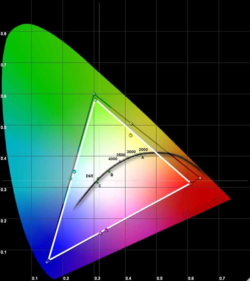

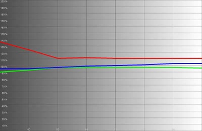

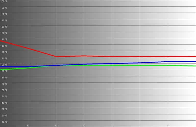

TC-37LZ800-CIE.jpgUsing our reference Datacolor Colorfacts Professional software, we measured grayscale and primary colors as well as the contrast of the TC-37LZ800. Color reproduction, as seen by the CIE chart was pretty good, though red really looked off - like it was leaning towards a more pinkish hue. This bore out in our results, but not as much as I had initially guessed, showing me that instrumentation is a vital addition to my eyes.
We again used the AVIA Pro DVD to set up our grayscale calibration and set our Black and White levels. After proper configuration we were able to record an ANSI contrast ratio of 527:1 - and that was while n a tweaked in cinema mode. This represents a very nice real-world contrast ratio and one of the better measurements we've seen in the past year. Bringing up an 80 IRE gray field we measured 6200K in the Cinema color mode. Here's how the color temp broke down in each of the various color modes (with their default color temps selected):

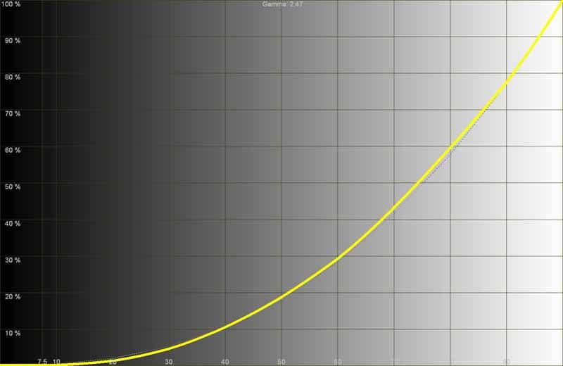

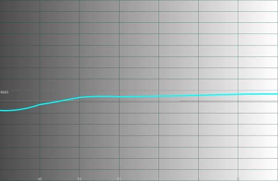

Even though the panel warmed up for over an hour before we began these tests, the CCFL stability was a bit odd. In Vivid mode I literally watched the lumen output climb from 125 fL to over 155 fL. Conversely, when I dropped it back to Standard, the output dropped steadily from about 65 fL down to the initially measured 54 fL. The other thing to note is that the edges of the screen lack uniformity when displaying a solid black (or dark) image. This is light from the CCFL backlight sneaking around the edge of the screen and is a common issue with many LCD displays. One good thing about the backlight in the Panasonic is that its level is affected by the Picture modes of the television. This means that Vivid mode jacks up the backlight level while Cinema mode backs it down. In my experience many backlight settings are universal to all inputs and modes, so this is a great feature to look for in a television.
The TC-37LZ800 passes both Blacker than Black (below Black) signals as well as Whiter than White, making it easy to guarantee the correct levels for viewing (aside from a pesky menu system that seems to have ADHD).

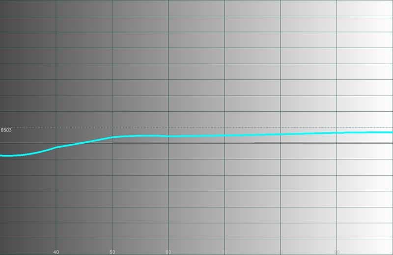

Considering the grayscale cannot be adjusted in the user menu, the best RGB performance I measured wasn't too bad. There is a bit of Red topping out on the television, but easing off the saturation control might help a bit. Overall it’s an apparent attempt to goose up the weakest color of the set and the real-world performance of the set doesn't bear out any sort of deficiency - at least not to my eye:
Temperature tracked consistently, though not quite the D65 that we would have hoped for. You may actually find slightly more accurate color in the Standard mode as compared to Cinema, but you'll need to make other adjustments as well.

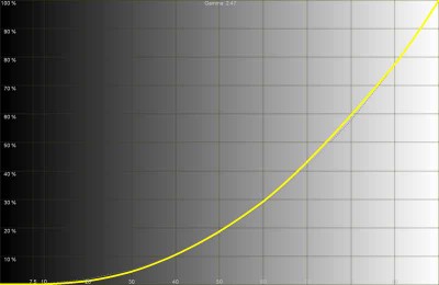

Gamma measured out at 2.47 and was a nice gradual track with no crushing of Black or White anywhere in the spectrum. This bore out with our viewing tests which showed an exceptional picture.

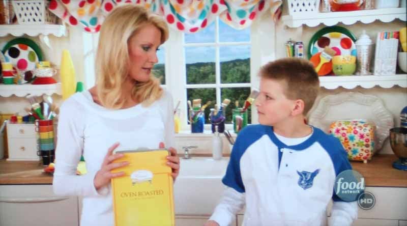

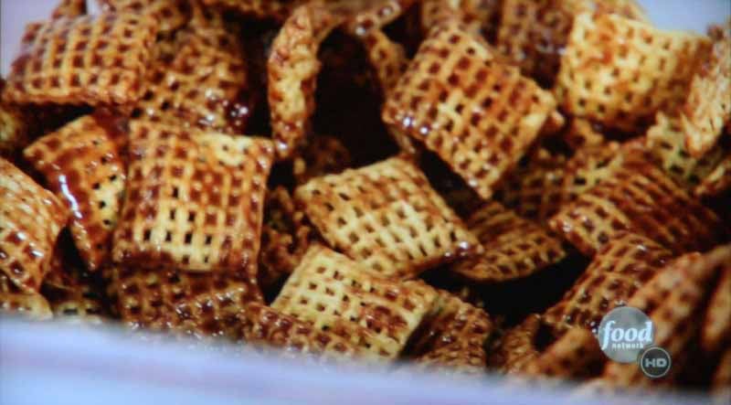

HDTV: Food Network
I don't know what show this was... I don't really even care. The point was that the pastel colors popped and the on-screen images were crisp and gorgeous.

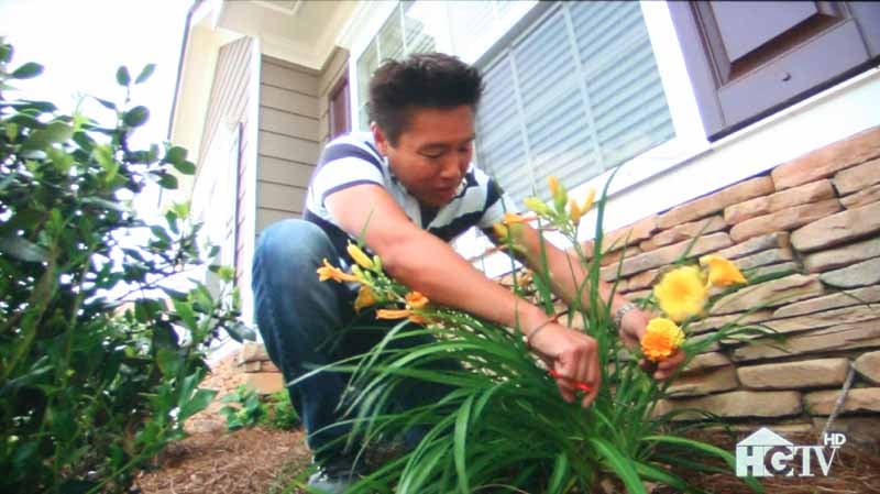

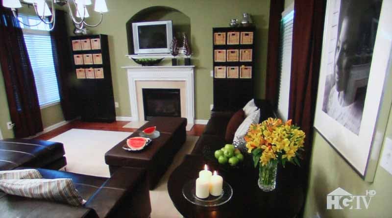

HDTV: HGTV
I had a similar experience with HGTV in high definition. Colors popped, edge detail was crisp but not artificial. In the scene I snapped below the image alternated between close-up shots of the flowers and the selection process which showed the detailed stone wall in addition to leaf and ground cover that was ripe with small, intricate patterns.

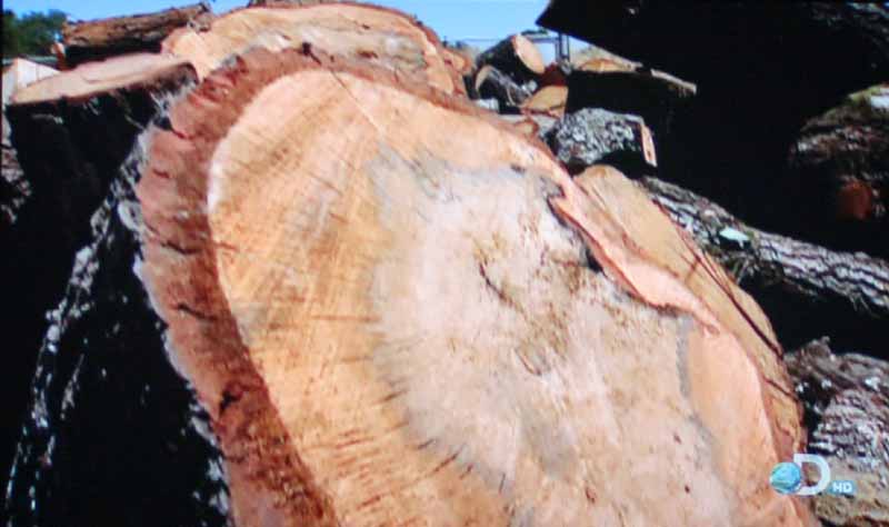

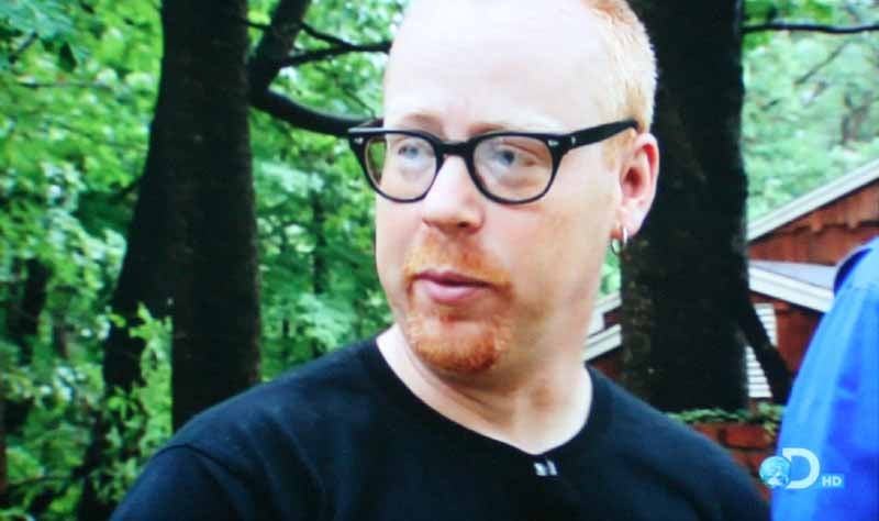

HDTV: DiscoveryHD - Mythbusters
I don't really know anyone who doesn’t enjoy this show, male or female. There's just something to be said for blowing away (literally, sometimes) myths that are circulating around our culture for years. We recorded a show about rolling your own canon out of a tree and decided this was a great place to capture some detailed shots.

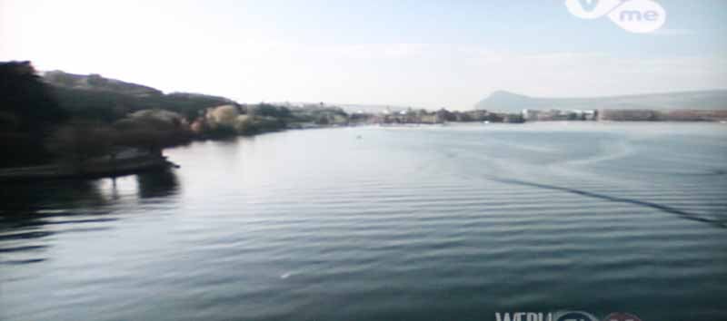

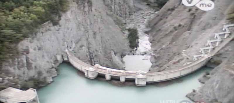

SD: PBS / Public TV
Standard definition looked awesome on this set as well, with digital standard definition pictures coming in looking clean and crisp and clean. Our photography may not have captured it since it was in motion at the time, but the TC-37LZ800 did a great job of rendering fast motion imagery without difficulty.
