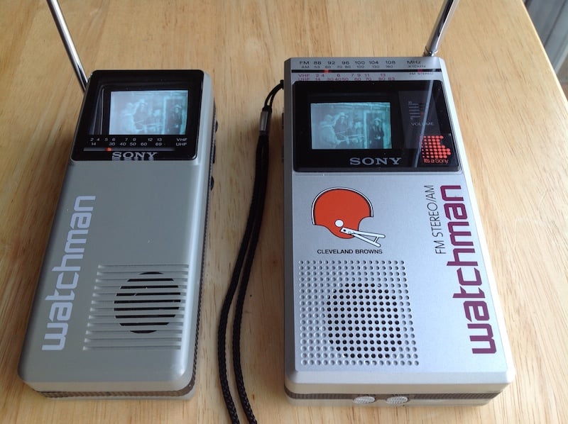

This grand vision for ATSC 3.0 would use the new architecture to pick up the slack for certain Over-the-Top (OTT) services and applications in some interesting ways. For instance, it could theoretically lease the digital air-waves to companies like Apple, Google or Microsoft for certain cross-continental transmissions, like software and operating system updates. In theory, ATSC 3.0 could be a cost-saving alternative to quickly distribute redundant transmissions that could choke the “last mile” of today's Internet service. But this will only work for phones with an ATSC 3.0-enabled communications chip. We'll know the standard has really taken off when it makes the leap from TVs to mobile devices. Devices with ATSC 3.0 will do way more than just get over-air software updates and maybe bring back the Sony Watchman. But it remains to be seen how wireless carriers will feel about another standard cutting into user’s data plans. If things go the ATSC's way in coming years, it’s not too far-fetched to imagine using an iPhone on an AT&T wireless plan to choose or even roam between wireless-data or ATSC 3.0 to watch HBOMax, maybe even on a new-improved Sony Watchman tablet.
