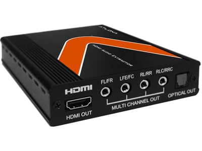

Executive Overview
Maybe you're that guy that just can't give up their processor. Maybe you just love the looks/feel/sound of your gear too much. Sure, you'd love to experience some of those new audio formats but come on, you just can't do it. Plus, with Blu-ray the Dolby Digital and DTS streams are higher bandwidth than before so you are getting a bit of a bump. Sure it isn't DTS Master Audio or Dolby TrueHD but you don't really need them, right?
You know you do.
HDMI has its flaws but right now it is the only way to get truly high definition audio and sound from most of todays high definition sources. This is unfortunate as there are plenty of people out there that would love to experience the new audio formats but don't have the money or the desire to upgrade their gear. They spent too much time and money getting the perfect gear just to have to upgrade for a simple input. Especially when manufacturers seem to be moving away from quality amplification anyhow. Altona Technologies has finally released (almost) a device that will strip the audio stream off the HDMI cable allowing those without HDMI capable receivers/processors to enjoy the lastest and greatest of the audio formats while still sending the high definition video to their HDMI capable display..

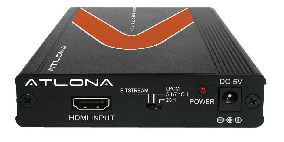

AT_HD570_backThe AT-HD570 HDMI Audio De-Embedder works with HDMI 1.3 and will strip the audio portion off while maintaining the video. You can output the audio either via TOSLink or analogue while sending the video to your display via the included HDMI output. The analogue outputs might look unfamiliar to the general AV populace as it takes the form of four 3.5mm jacks. This is common in the computer world and requires only four 3.5mm to dual RCA cables to make the switch.
The technology isn't without its limitations, however. The optical output only supports Dolby Digital 5.1/2 or LPCM 2.0. No word yet on if DTS is supported but we're guessing it isn't. Through the analogue outputs you can get the whole she-bang - as long as you are decoding at the source and sending 7.1 LPCM. While it makes it sound like it removes the audio from the HDMI feed, it really doesn't. Through the HDMI you can get all the audio formats either LPCM or bitstreamed.
The AT-HD570 is HDCP compliant so you won't have to worry about it working with your other HDMI devices. It can serve as a repeater as well. It has onboard HDMI signal amplification and reclocking. Deep Color is supported from 25MHz to 6.75GHz for 36 bits and resolutions up to 1080p (24 or 60 Hz). The video is passed through untouched - the AT-HD570 doesn't scale or upconvert.
The AT-HD570 isn't for everyone but for those that need it, it will be invaluable. We've seen devices like this on the market but none that supports all the audio formats. Currently, the AT-HD570 is on preorder for the price of $219. While only a bit over a hundred more will get you a brand new Denon receiver with all the decoding and HDMI functions you could need, you'd be stuck with a bottom of the line Denon. For those that love their analogue gear but want to hear what all the high def fuss is about, the AT-HD570 might be just the ticket.
For more information, please visit www.atlona.com.
