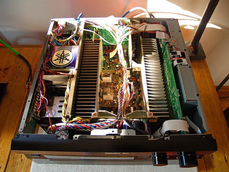

Image of the Yamaha DSP-A1 with the cover removed. Note that the DSP-A1 tips the scales at greater than 50 pounds, suggesting some serious amplification under the hood.
