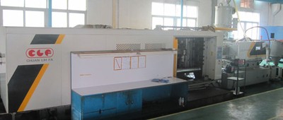

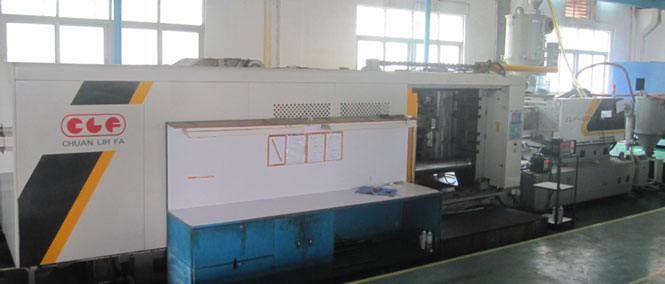

Tooling. The world of manufacturing revolves around tooling. “Tooling” in consumer electronics is when a company needs to do an injection-molded plastic or cast aluminum part. Whether it’s a tweeter faceplate or a swoopy satellite cube housing or a grille cloth frame or a dimpled port tube, those are all examples of tooled parts.
Tooled parts are made by injecting molten plastic or pouring molten aluminum into a block of steel that has been hollowed out using a very precise computer-numerically-controlled (CNC) program, derived from a 3-D engineering file. Whenever you see a nicely molded, shaped piece of plastic or metal, chances are it has been formed by some sort of tooling process. Tooling is very expensive, which is why smaller manufacturers jokingly refer to the need to “tool” something as a four-letter word. Tooling is expensive, has a very long lead time, and you can’t easily change it if you decide to re-design the part later on.
Injection Molding
Injection Molding Machine
There are two basic types of tooling: Proprietary tooling and open tooling.

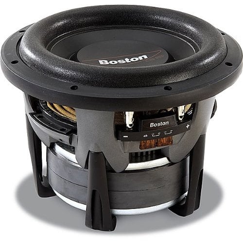

Proprietary tooling is tooling that that particular manufacturer designs and pays for themselves, and then they own the tooling and retain the rights to it forever. There are many distinctive tweeter faceplates, woofer frames, or plastic satellite cubes which we associate with a particular manufacturer’s look and style, and that’s because they’ve done their own tooling. The manufacturer will often protect their tooling appearance with a design patent, in order to make their design immune to counterfeiting and unauthorized copying.

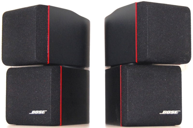

Good examples of proprietary, patented tooling are Boston Acoustics’ automotive Pro Series cast aluminum woofer baskets and Bose’s famous satellite cubes.
boston-driver     Bose Cube
Boston Acoustics Pro Series Woofer                 Bose Cubes
