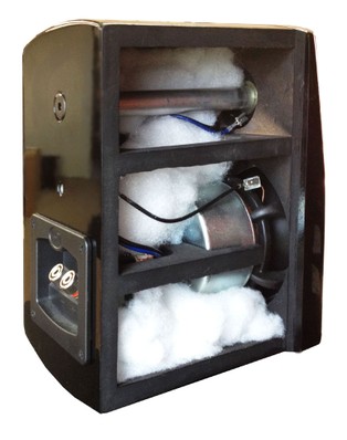

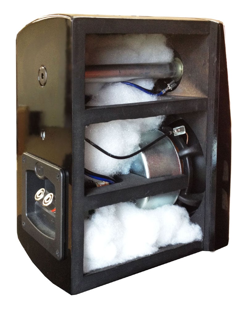

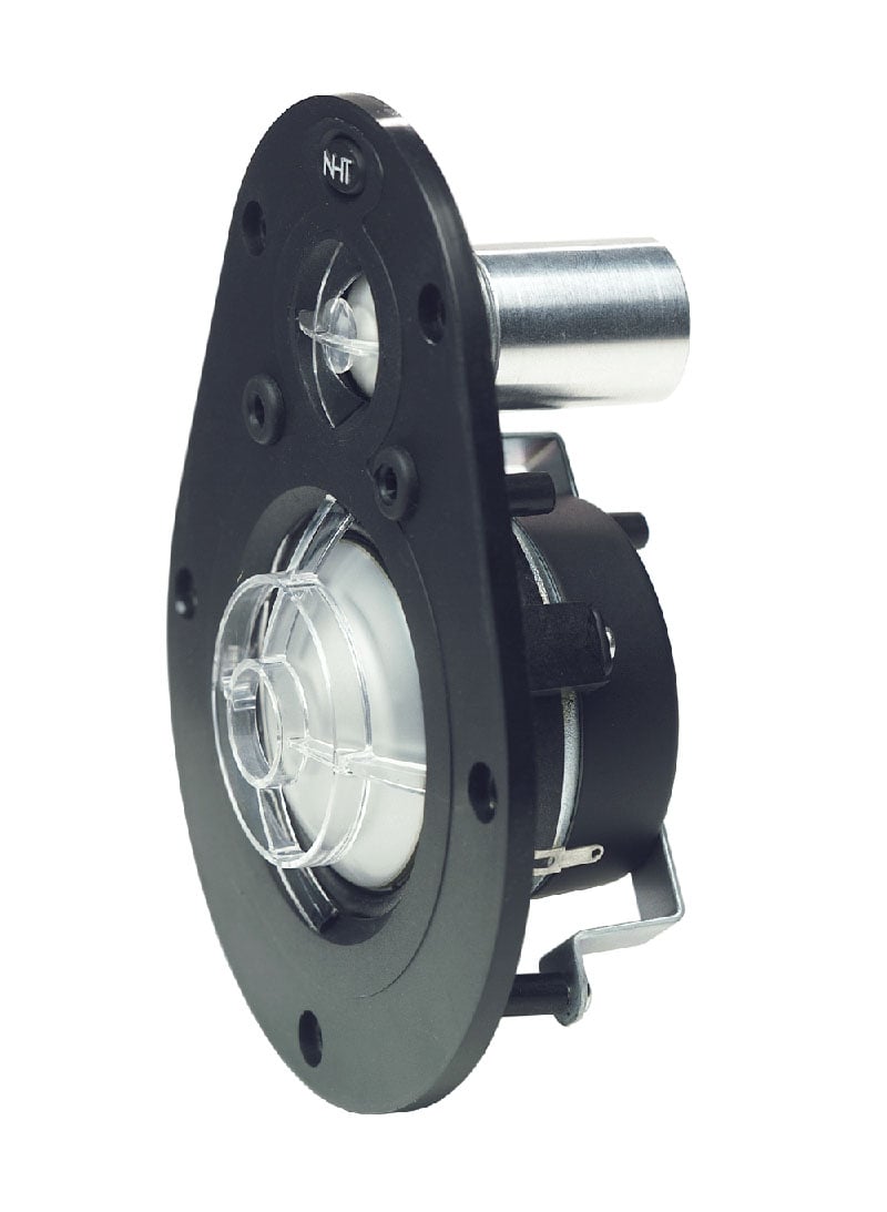

NHT Classic Two Cut-Away - notice the thick and multiple braces and aluminum bar heatsink/brace combo

Chris: We have almost always used MDF, because
of its integrity and its propensity for precise cutting. We use braces or internal laminates to be sure there
are not spurious resonances caused by weak surfaces. We sometimes use drivers
and other metal parts to help strengthen cabinets, while assisting with other
sonic attributes.
Examples: The Absolute Zero, Classic Two, A. Tower and Wall speakers which all employ Neodymium magnets on their tweeter to keep it as close as possible to the mid-woofer for sonic coherence. The tweeter also contributes to rigidity. The problem with Neo is that its properties change with heat. Our solution was to bolt a 3/4” diameter aluminum bar to the back of the tweeter that runs all the way to the back of the cabinet and is bolted there. This solved both issues. The tweeter bar acts as a heat sink keeping response consistent during use and a cabinet brace. Obviously the body of the tweeter has to be designed appropriately.

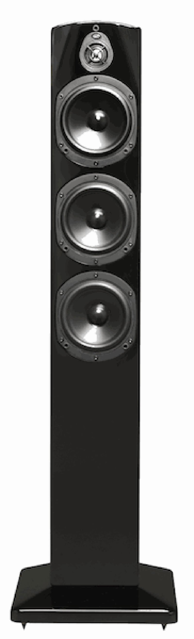

NHT Classic Three (left pic) and Absolute Tower (right pic)
