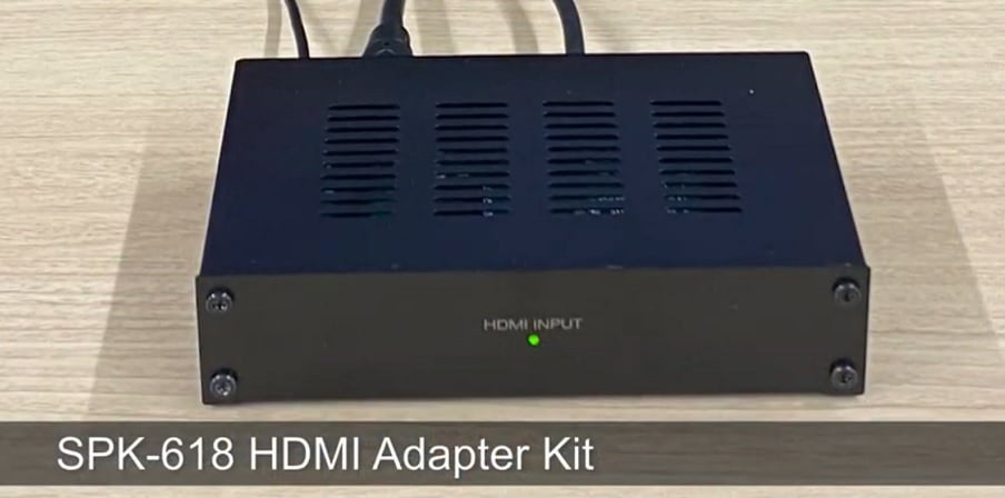

Today, Sound United announced a fix for the remainder of the issues regarding the chipset problems. The SPK618 HDMI adapter is designed to remedy the compatibility issue between SPECIFIC Denon and Marantz A/V receivers that support 4K/120 and 8K/60Hz video resolutions (models listed below) and gaming consoles that support 4K/120Hz and 8K/60Hz video resolution output.

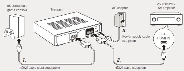

The SPK618 adapter takes an HDMI input signal from the gaming source and delivers the corrected HDMI data to the AVR, thus remedying the error and allowing a 4K/120Hz or 8K/60Hz signal to pass. The SPK618 adapter will be available for the customers who own an affected AVR and are observing the aforementioned pass-through issue. Current Denon & Marantz AVR users will be asked to update their firmware to ensure the adapter compatibility if they do not have their products set to Auto Update. The adapter will ship starting from the middle of May 2021 in North America. Customers who have an affected receiver will not need to ship anything or retrofit their products at home. The low-profile adapter will be provided to customers with the listed AVR models at no cost during the warranty period.
