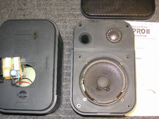

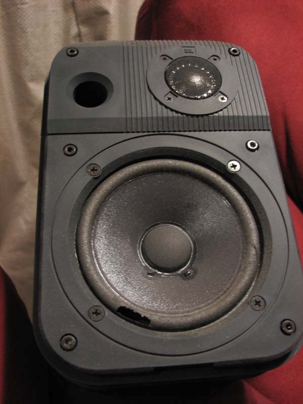

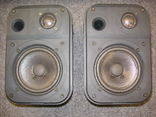

Recently I’ve noticed they were simply not sounding as good as I remembered. The bass was weak and I heard a lot of buzzing emanating from the woofers. When I popped the grills off it was obvious what was going on. Dry rot. Before butyl rubber took over as the primary choice of woofer surrounds, most companies utilized foam. Foam is actually more efficient than butyl rubber but there are no free lunches. The problem with foam, especially in humid climates like Florida, is that they deteriorate over time. Considering I had these speakers for over a decade, it only makes sense that the inevitable would happen to my cherished little JBLs.

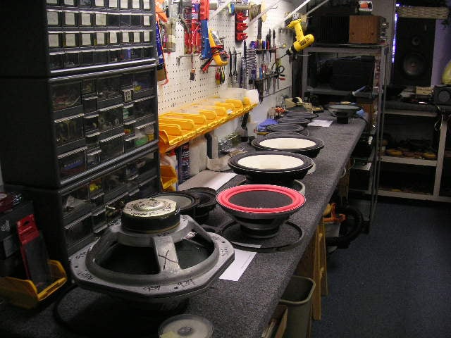

It was at this moment that I decided to pursue my second option. I did a Google search on refoaming kits and came across a company known as Simply Speakers. Not only did they offer refoaming kits but they also offered the option of mailing in your speakers to have their professional staff do it for you. Since I don’t have the steadiest hands (hence why I am an engineer and not a surgeon), I opted for having them restore my speakers for me. Instead of simply sending in the woofers, they insisted I send in both speakers fully assembled so they could inspect the crossovers and tweeters. As I was getting ready to ship them out, I realized their location was about a 1 hour drive from me so I opted to hand deliver them and meet the folks behind Simply Speakers.
What I didn’t realize until I stepped into their place was that I had dealt with them before. Back when I was in college I worked for a hifi shop called Cooper 4 Stereo where I assembled systems for clients, repaired electronics and installed gear in people’s homes. I used to frequent Simply Speakers to get vintage McIntosh woofers refoamed. They changed locations so I didn’t realize it was the same company.

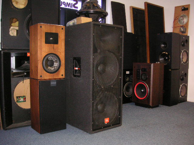

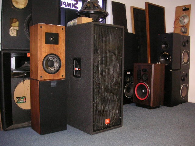

Simply Speaker Storefront with fully restored vintage speakers from JBL, Cerwin Vega, Infinity and many others
I always admired the work they did, as did their customers whom in a way felt like their precious speakers were re-birthed after they were fully restored by Simply Speakers. Some people have an affinity for vintage speakers and electronics just like they do for cars. I totally understand that as I still have a place in my heart for old JBL speakers. After all the JBL LX-44s were considered my first truly high end speaker system that I owned and spent a summer working at Publix supermarkets when I was in high school to afford them. Why ditch something you're so fond of just because it needs a little tender loving care?

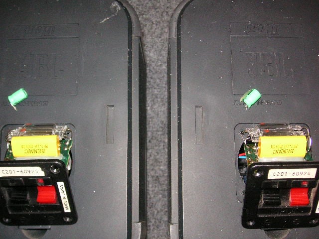

  • Replace the electrolytic capacitor in series with the tweeter with an equivalent value polypropylene one. This decreases frequency response variations because the latter dielectric has tighter tolerances. Poly caps also last a lot longer as they aren’t as susceptible to rotting out like electrolytics. This is more critical for high frequencies so only the tweeter cap was replaced, not the electrolytic on the woofer.

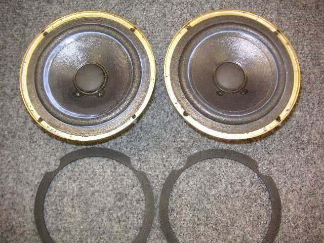

Dry rotted surrounds and nasty electrolytic cap in the tweeter HPF (left pic);
Restored woofers and new polypropylene caps being ready to installed (right pic)

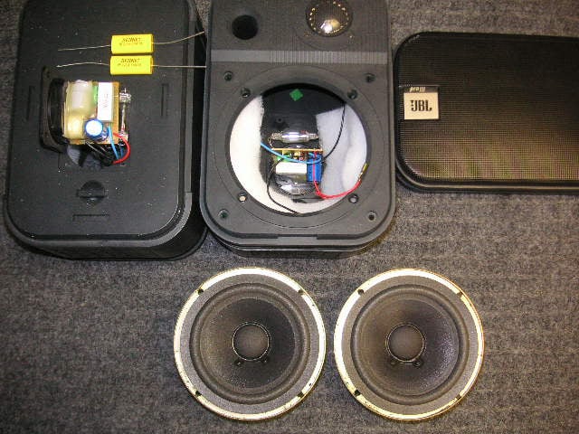

JBL Pro III Woofers Foam Sealer Applied.JPG      JBL Pro III New Caps Installed.JPG
Foam sealant and new surrounds on the woofers (left pic);
Clean install of the new capacitors (right pic)
