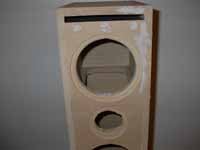

I decided not to use the upgraded option since they were only to be used as center and surround speakers and I felt it wasn't necessary to get the more expensive drivers and crossovers. Being a handyman, I also decided to build the cabinets myself thereby reducing my overal expense to $840/pair thereby selecting option one.
