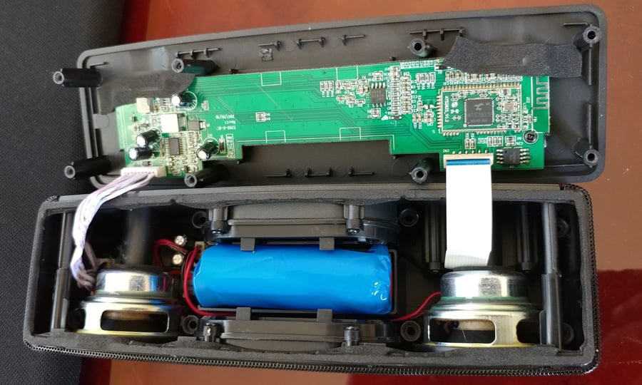

Well for one, RBH didn't pull any punches with the amplifier powering this little brawny speaker. It utilizes a Class D Texas Instruments TPA3118D2 high efficient stereo amplifier that is capable of delivering up to 50 watts x 2 (with a 21V power supply) or can do 2 x 15 watts without external heat sink on a single layer PCB. RBH rates the amp at 2 x 10 watts/ch which is likely a peak rating considering the speaker is being powered off a battery.
Inside View of RBH Sound Sidekick - notice the hefty drivers and large blue battery pack
We asked RBH about their power rating and they confirmed it was not a continuous rating but they were able to measure 9.36V at 100Hz across the 8-ohm driver. This would give you 11 watts which is quite amazing for a compact battery powered speaker running off a couple of 3.7V lithium batteries!
As impressive as the amp section of the Sidekick is, the speaker drivers RBH employed are equally impressive. They employed (2) 45mm drivers in a stereo configuration with a patent pending dual-membrane 70mm oval passive radiator.
