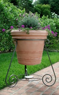

The Terra
Cotta 8.20 arrived in a HUGE box that was deceptively light. I just hope they
were paying shipping by the pound and not the square inch. There are two
pieces, the large plastic “planter” portion and a cast iron stand. At some
point you’ll be tempted to remove the planter from the stand, and that is fine.

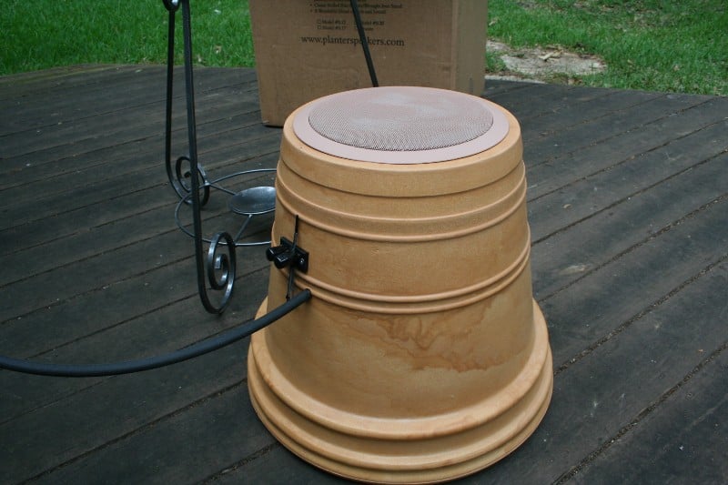

But DO NOT set the planter down on the “bottom”. That is where the speaker
lives and it is actually convex. If you have soil and a plant (especially if it
has been watered lately) you could very likely damage the tweeter or worse. The
speaker resides at the bottom of the planter and it is nigh invisible unless
you are lying down on the ground near it. There is a small metal “reflecting”
plate under the speaker that is used to help disperse the sound from the
tweeter in all directions. The metal grill on the bottom is painted a similar
color as the planter, but as I said, you’d have to be lying down to see it.

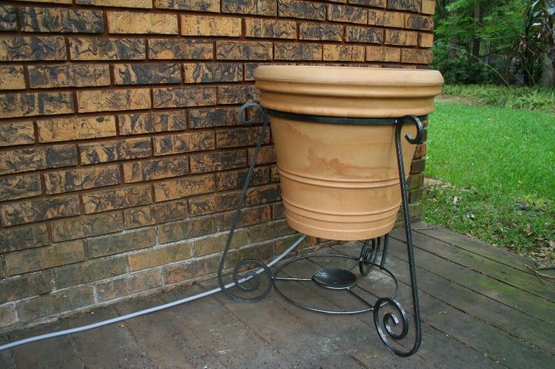

The planter is a good size and looks like it could
hold a small tree if you really wanted it to (it is large enough, though I
don’t think that is a good idea). Most of the pictures show a drooping
fern or ivy of some sort and I imagine it would look fine with some perennials
or decorative grasses.

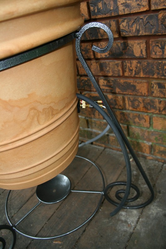

Out of the side of the planter is a long rubber hose for drainage. If you look inside the planter, you’ll see a number of drainage holes that feed a reservoir which feeds that tube. Near the drainage tube are two five-way binding posts that you’ll likely only use one way – bare wire. Each binding post has a rubber cap to keep your connection safe from the elements and three small tie downs for neatly securing your wire and the drainage tube to one of the cast iron legs of the stand.

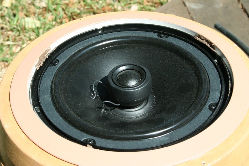

The driver
is a coaxial type with the tweeter assembly sitting quite close to the grill
(another reason not to set these speakers down on their grill). The driver is
completely sealed within the enclosure so I really couldn’t get a look at the
back. There is a rubber surround around the base of the center mounted tweeter.
The metal plate dispersion system we mentioned earlier is very good for a more
open sound, but you may want to either invest in more directional speaker or
place this up against a wall if you are looking for more “traditional” imaging.

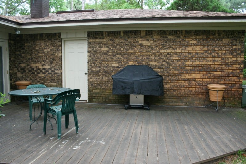

In most
backyards, you are going to have two basic setup options: near a wall or out in
the open. Near a wall gives you the advantage of a little boundary
reinforcement that should extend the bass response and provide more
directionality to the sound while the open placement diffuses the sound more
and helps fill a larger area. If you are specifically looking for a more
directed sound (like a conventional loudspeaker), PlanterSpeakers makes
planters to fit the bill, though they look a bit different. You’ll, of course,
need to run wires to your speakers from an amplifier or receiver (typically
located inside). If you are near an exterior wall, you’re in luck. Just drill a
hole, push the wires through, and apply a little caulk to keep out the elements
and bugs. If you aren’t, well, you’re going to have to make some decisions. If
you have a deck, it seems like a no-brainer to run wires underneath. For those
with exterior speakers already installed under eaves and such, you’ll have to
either extend those wires down to the deck, attach them to the wall, and paint
them to match or just re-run altogether. Those who are planning to install
speakers outside for the first time will probably be looking at a trip to the
attic, under the house, or both.

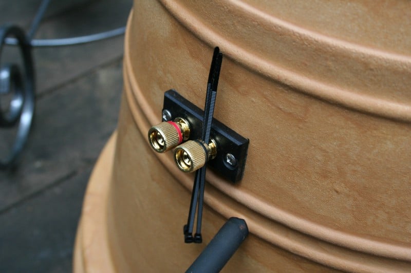

You’re
going to need to secure the wires to the cast iron frame (in order to hide
them) so consider a few things. First, you may want to invest in some “darker”
jacketed wire (if you can find it). Another option is to wrap or encase the
speaker wire in a tube or perhaps wrapped with electrical tape. PlanterSpeakers
provides some small tie-downs with instructions to strap the speaker wire and
the drain tube to the same leg. Given their proximity, this is really the only
option you have.
