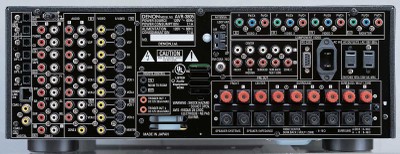

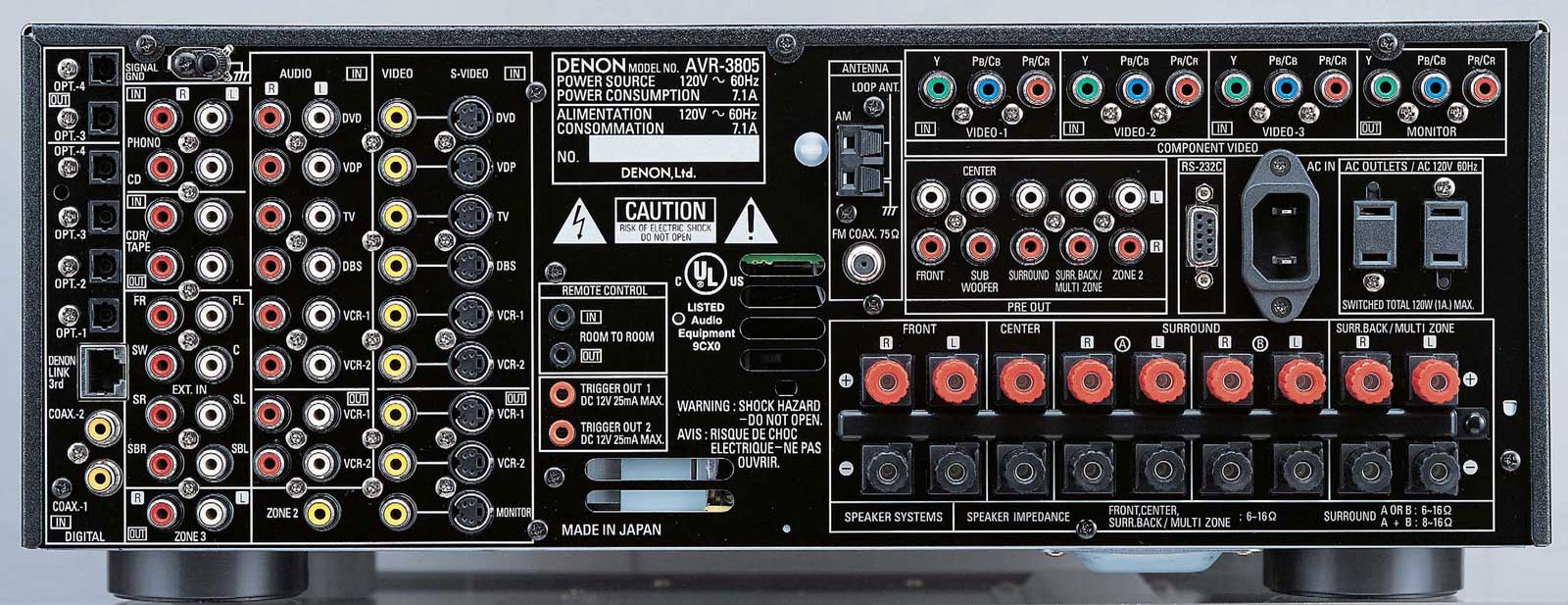

Audio Inputs: 7.1 external wide bandwidth (100 kHz) multi-channel inputs, 5/7 Channel Stereo, DENON Link 3rd (SACD & DVD-Audio compatible), 7 assignable digital inputs (5 optical, 2 coaxial), 10 analog inputs
Audio Outputs: 2 optical digital outputs, 2 multi-zone stereo pre-amp level audio outputs, fixed or variable level
Additional Connections: RS-232C port for third party control Systems, remote I/O ports, 2 assignable +12V triggers, detachable power cord

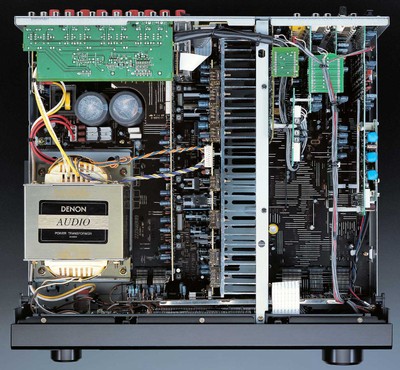

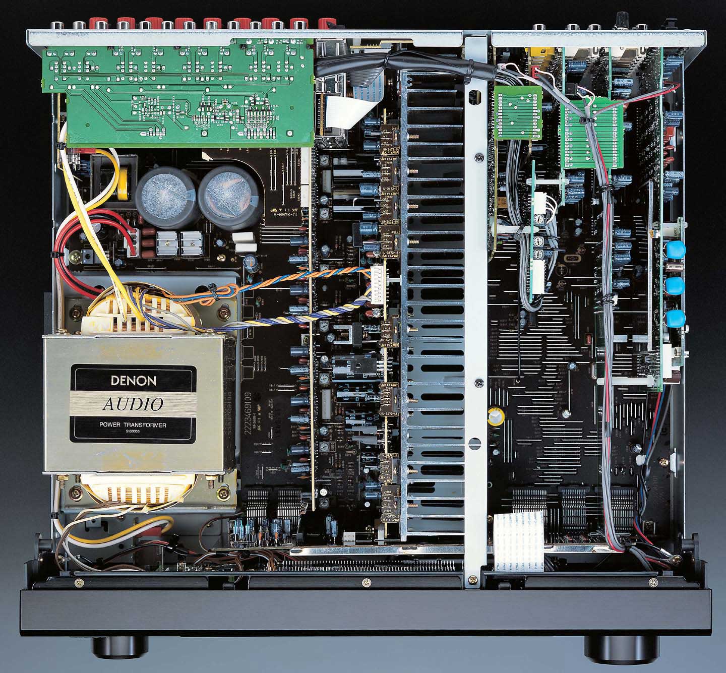

  • 16 Burr Brown 192 kHz/24-bit DACs in differential configuration on all 8 channels (Note: Upon having Gene review the schematics for the AVR-5803 and this receiver, he discovered that Denon counts the + and - of each differential DAC as a separate DAC. In reality, this is still one DAC. Hence, there are really 8 DACs all configured differentially, with paralleling two DACs per channel for noise averaging in "direct stereo mode.")
