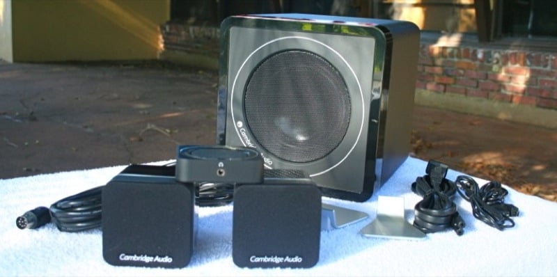

The Cambridge Audio Minx M5 speakers came double boxed with clear markings on both (I'm more a fan of having the outer box discretely marked - especially if it will be used for shipping). The inside of the box was split into two sections, the top to house the satellites, control unit, and cables and the bottom for the bass module. All the speakers were covered with a very thin cotton fabric because AUDIOPHILE! The satellites took a bit of assembly. There is a small base which is slid into a slot on the back. Also included are four, very small, rubber feet which can be attached to recessed marks on the bottom of the bases. But I encourage you to think about your speaker placement before you attach the base or the rubber feet. The base angles the speakers up a bit. This is perfect if you are going to place the speakers on a desk and a bit away from you. If they are going to be up higher, you may want to forgo the base entirely and just place the rubber feet on the bottom of the speakers. There are four rubber feet for the bass module as well.

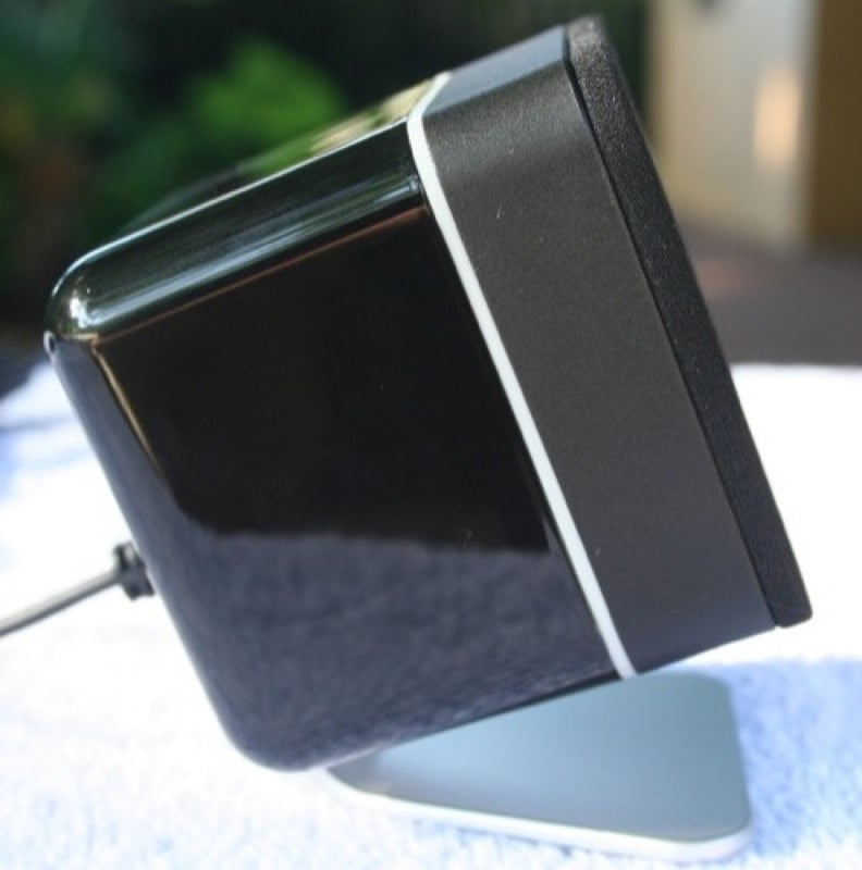

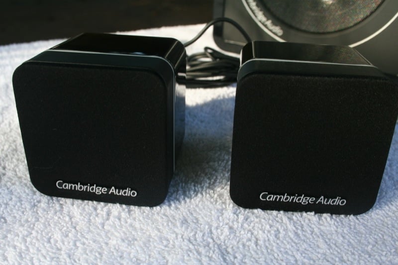

The speakers themselves, are very attractive. The satellites have non-removable (I tried but I didn't want to risk breaking them) fabric grilles and the bass module has a slightly concave wire mesh grille. The satellites have a gloss black finish with a matte black trim near the grille. The bass module is exactly the opposite with matte black everywhere except near the grille. Each of the speakers sorts the Cambridge Audio "logo" (just their name) so that you'll never forget who made your speakers.
Cambridge Audio Minx M5 Speakers

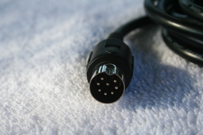

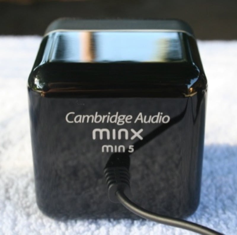

Glancing at the back of the satellite speakers, you'll notice that they have a connected cable. If you follow it to the end, you'll find a proprietary connection. Begin groaning noises now. I'm a big proponent of using standard, and preferably removable, cables. With RCA, speaker terminals, and any number of other cable types out there, using a proprietary connection on a non-removable cable just strikes me as either shortsighted or haughty. "We know what you need. What kind of idiot would place their satellite speaker further away than six feet from the bass module?"

Connecting the Minx M5 speakers to the bass module was a bit of a breeze. With the weird, proprietary connection, there was no way to plug it in wrong. All you needed to do was to remember which was the left and right. Each of the satellite speakers have a 2" "full range" drivers that are designed to tackle the high and some of the midrange frequencies. The speakers are tiny, just under 3" cubes and are sealed for easy placement. They weigh next to nothing and they are very easy to place and move about. The stand is just about perfect at aiming the speakers at your shoulders from your desktop if you have good posture, or at your ears when you lean back to think about something. That seems to be a pretty good design choice to me.

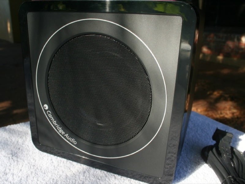

Minx M5 Bass Module
The words "bass module" set my teeth on edge. I like my subs to be
subs and my woofers to be in my speakers. But in multimedia speakers,
the bass module is not only a standard fixture, but a must. If you had
space on your desk for full sized speakers, you would have them,
wouldn't you? With space at a premium, offloading the bass to a separate
box that can be placed, well, historically on the floor near your feet
where it benefits from TONS of boundary reinforcement, is a must.
The front of the Minx M5 bass module is almost entirely covered with the mesh grille. The bass module is just about an 8" cube and has a 5.25" woofer. While each of the speakers have a 15 watt amp, the bass module has a whopping 30 watts. The bass module is also sealed which is a bit unusual for this type of speaker. Usually manufacturers are looking to eke out as much bass as they can from their bass modules. A port is an easy way to do that. The fact that Cambridge Audio didn't go with a port (I even used a flashlight to see through the grille to see if they snuck one back there - they didn't) should tell you that they were more worried about sound quality and a specific frequency response rather than trying to trick you into thinking their offering was good because of bloated bass.

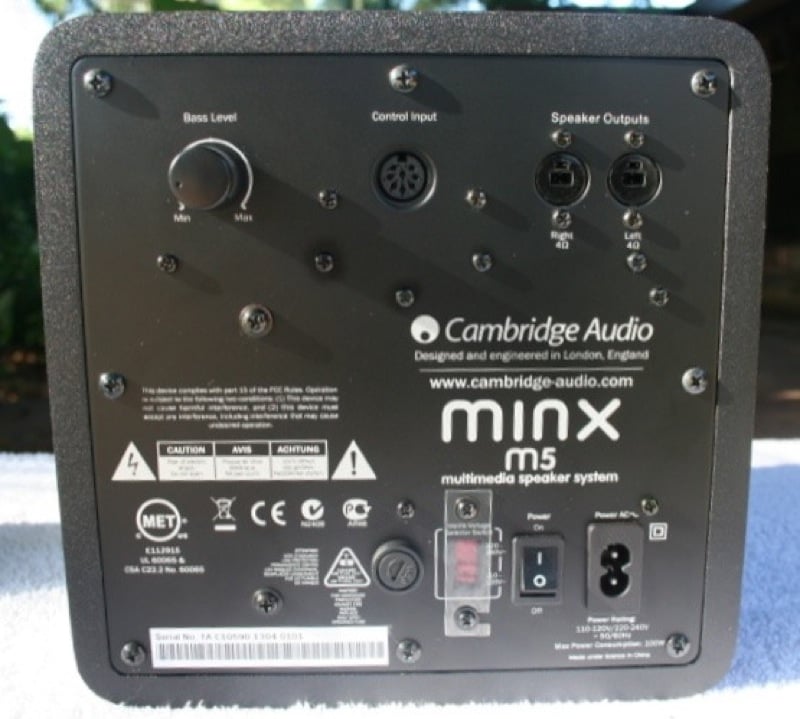

The back of the Minx M5 bass module has a removable power cord, a power switch a voltage selector switch and a bass level volume knob. There is an input from the control unit (proprietary, grr....) which looks like a really big s-video connection and two proprietary outputs to the speakers. Just like every multimedia system on the market, there is no way to send a test tone just to the woofer (though you could try a really low note that the satellites couldn't reproduce but that probably wouldn't work for a number of reasons) so calibration will have to be done by ear. There is no volume adjustment on the satellites other than moving them closer or farther away (or putting something in front of them I suppose) so the bass is the only control you'll have to worry about. I found it fairly easy to dial in the bass but that could be because I've done this a few times before. You may have more problems.

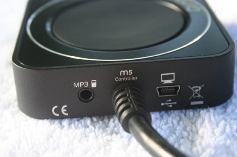

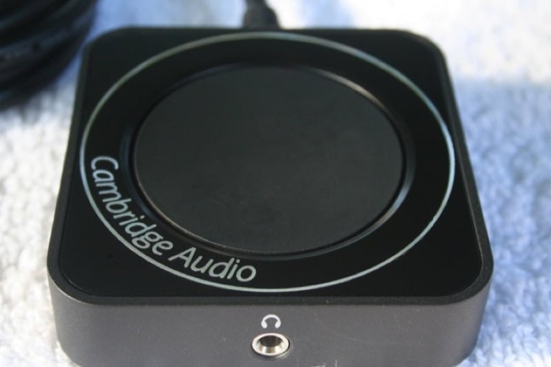

The really unique part of the Minx M5 speakers is the control module. This flat, square unit has a connected cable (for running to the bass module) and a few ports. On the back they have the main mini USB port for connecting to your computer with the supplied USB cable. It also has a 3.5mm input for adding your portable device. The front of the module has a 3.5mm output for headphones. The top has a soft, rubber spinning dial. The spin controls the volume and you can press on it to put the speakers into standby mode. I find this to be a very convenient setup as you can place the control module very close to you making the controls easily accessible without having to move (or locate) your speakers. Most computer speakers have the headphone and volume control on one of the speakers. I infinitely prefer the control module of the Cambridge Audio Minx M5 mulitmedia speaker system.
Now, if you are like me and keep your tower computer on the ground next to (or under) your desk, and the bass module on the floor, the wiring looks like this: Up from the computer to the control module, down to the bass module, and two wires back up to the speakers. That's four wires (and the control module to the bass module wire is very thick) added to your current setup. Plus Cambridge Audio has included a ridiculously short mini USB to standard USB cable (probably three feet long) making it necessary to place the control module on the same side of your desk as the computer adding to my frustration. Yes, it is a standard cable and yes you probably have a longer one somewhere but really? Three feet?. But, bear with me, I think the convenience is worth it.
You may also be like me and have not just a desktop but more than one laptop in the house. Most speaker systems connect to the audio output of your computer. That probably is a 3.5mm port. Sure, you could connect that to the headphone output of your MP3 player or laptop, but it requires getting behind your computer. And no one wants to do that. With the mini USB port on the control module, you can do as I do - just keep an extra (or that stupid short one they gave you) nearby and swap them out. I haven't found a device with a USB port that didn't play nice with the Cambridge Audio Minx M5. And if that doesn't work, use the 3.5mm input (with supplied cable) to your headphone jack. Either way, it is very, VERY easy to use the Minx M5's with multiple devices - something that most "multimedia" speaker systems can't claim with a straight face.
The last point that I think needs to be really hammered home here is that the USB connection means that the (probably crappy) DACs in your computer are being bypassed for the ones in the Minx M5 system. Cambridge Audio has a long history of high end gear including standalone DACs. Those DACs start at prices higher than the entire Minx M5 system and range all the way up to multiple thousands. So, yes, I trust the Cambridge Audio DACs long before I'd trust the ones connected to the stock $1 AV card in your Dell.
