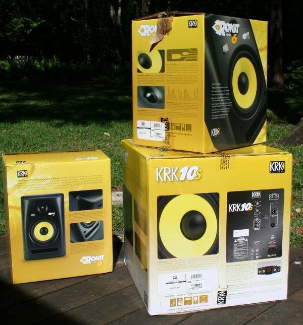

The KRK Rokit Powered
6 monitors (there is an unpowered version FYI) came in individual boxes as did
the 10s subwoofer. Each speaker is wrapped in a thin foam fabric with foam
endcaps. The speakers were all double boxed with the outer box still having all
the branding. The speakers arrived in good condition with no damage. There are

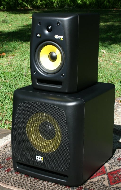

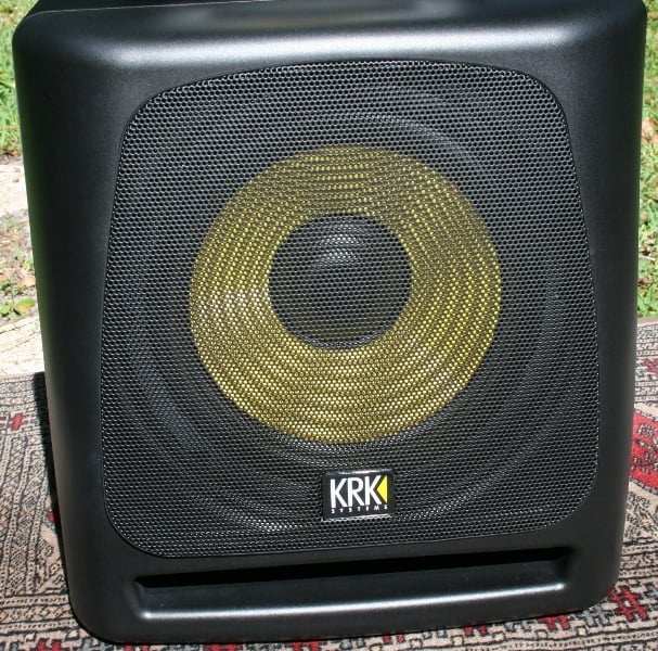

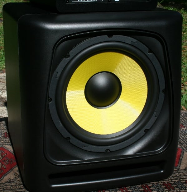

The 10s subwoofer is about the right size for a home theater sub which gives is a bit more bulk than you are used to seeing in an office. At 16" deep, 14" wide and 15" tall, you're not exactly going to shove this thing under your desk. You're definitely going to want to make sure you know what you are getting into with the KRK 10s. It sports a ten inch driver under a mesh grill. The grill is technically removable though it is a bit of a pain to do so, and the sub looks a little weird with it off. There are no feet of any kind nor are there provisions for such.

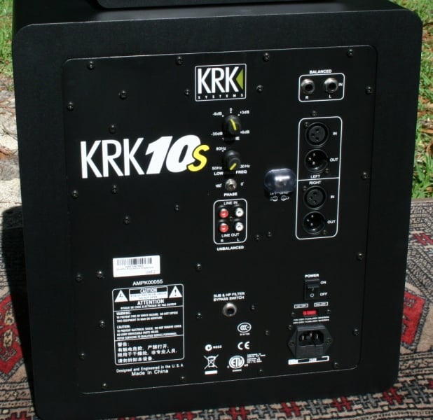

The back of the sub
may look a little unusual to home theater enthusiasts but it all makes sense
once you take a deeper look. Since all of the speakers have their own amp, the
idea is that you'll need to run them all through the sub in order to take
advantage of the crossover. Down the center of the sub, you'll notice a few
more common controls - volume (-30dB to +6 dB), crossover (50Hz to 130Hz with a
label at 80Hz), a 0/180 phase switch, and RCA line in and outs. I'll get to
that 1/4" plug at the bottom in a minute. To the right you'll notice TRS
(1/4") inputs and balanced inputs and outputs. A power switch (no auto-on
function) and detachable power cord are at the bottom. Under a small plastic
cover, there is a ground lift switch for those having problems with a grounding
buzz. This is a feature I wish they had on all subs and is a welcome find here.
In order to use the 10s in a 2.1 configuration, you can use the RCA, TRS, or balanced inputs from your computer/soundcard. You can then connect your speakers by either balanced or RCA output. The any input can be matched with any output (you don't have to do RCA to RCA for example). But what if you don't want to use the sub, if only temporarily? Well, that's what that final 1/4" plug at the bottom of the center column is for. You can connect a foot pedal so that you can bypass the sub as you wish and send a full range signal to your monitors. Pretty cool.

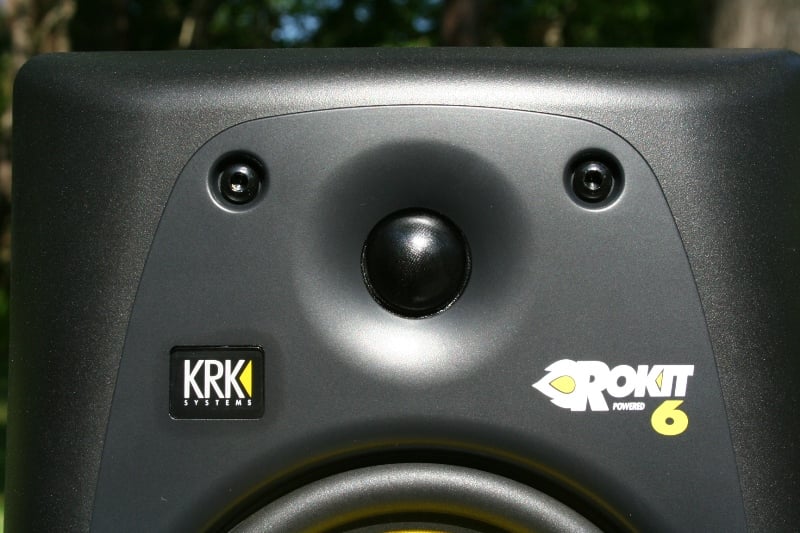

Rokit 6s sport a 6" woofer (hence the "6" designation) and a
1" neodymium soft dome tweeter with ferro fluid. KRK Systems also makes a smaller 4 and a larger 8
monitors with the appropriate sized woofers. The speakers are a bit bigger than
you might expect at over a foot tall, nearly a foot deep and almost 9"

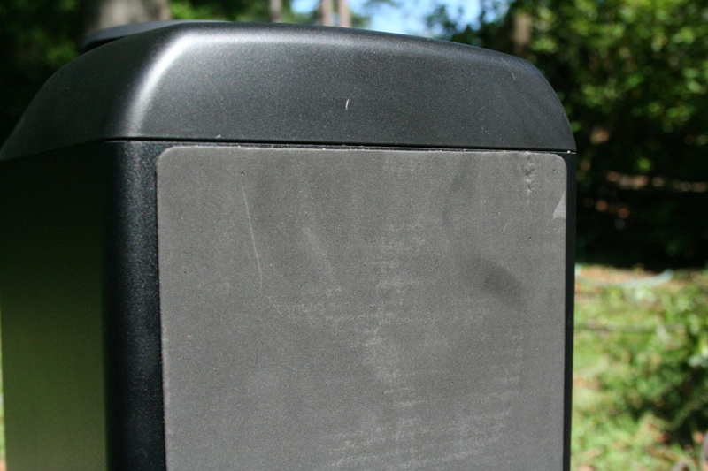

wide. The bottom of the speakers have a rubber mat covering nearly the entire
bottom which means you can pretty much put them on anything. The mat didn’t
stick or mar any surface I put them on including a cherry desk.

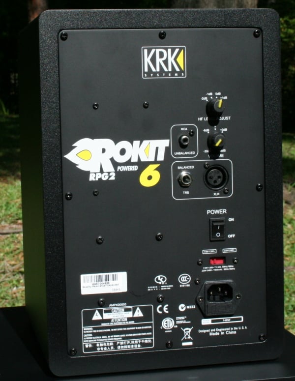

The back of the Roket 6 has the amp with a number
of input and control options. You have your three different input options (RCA,
TRS, and balanced). Only two of them (RCA and balanced) are compatible with the
10s sub (it doesn’t have a TRS output). There is a volume control (again with -30dB to +6 dB control) with a High Frequency adjust
from -2dB to +1dB. This allows you to really fine tune your high frequency
experience. Lastly, you'll find a power switch and a detachable power cord at
the bottom.

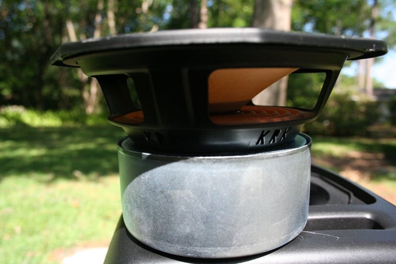

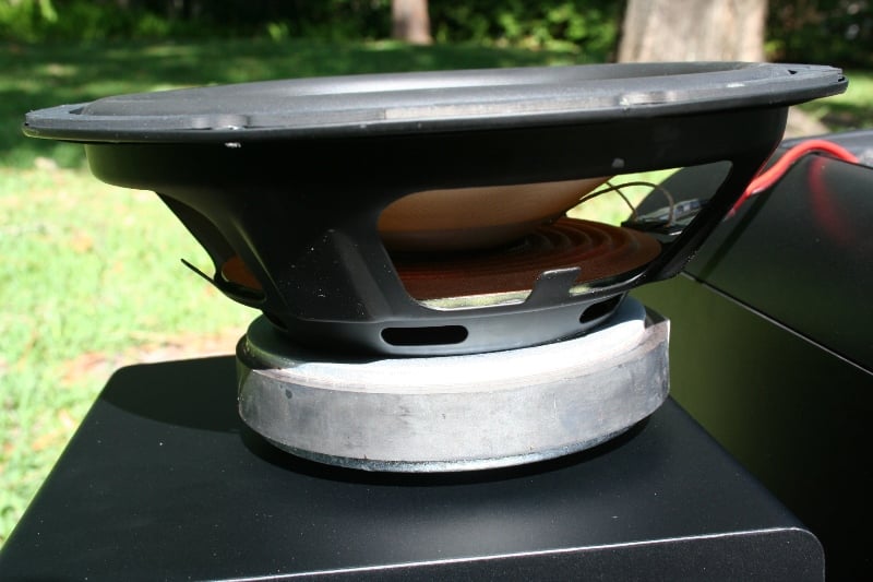

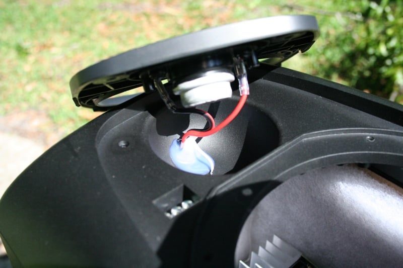

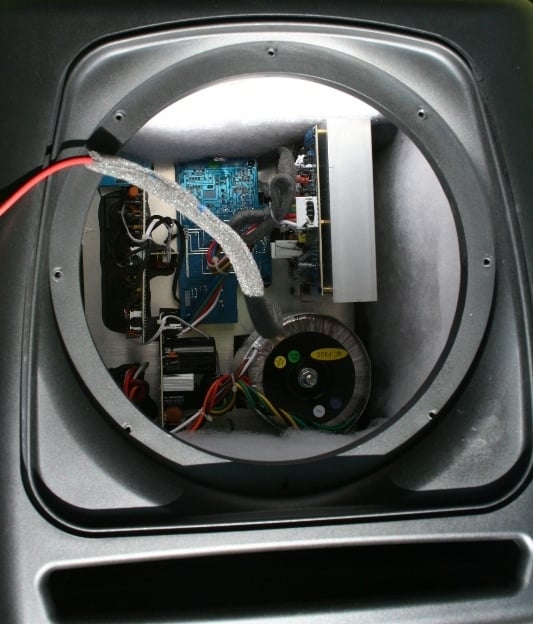

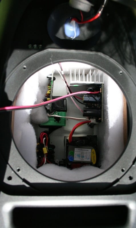

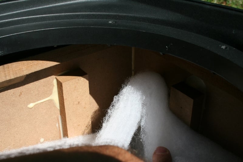

Cracking open the Rokit 6s I needed to remove a large front plate which doubled at the housing for the tweeter. The woofers were shielded with stamped baskets. The magnet structures looked about right. There were some braces glued to the sides and along the edges but none across the middle other than the structure for the slot-style port. The knock test was sufficiently dead. The speakers had a layer of polyfill glued to the walls. The amp appears to be housed into its own compartment which I’d surmise it’s likely a Class D design. They utilize a linear power supply with a fairly hefty torroidal transformer and a meaty power reserves.
The 10s sub shared many of the same features of the Rokit 6s including the cabinet materials, stamped baskets, and polyfill on the walls. The differences were that the driver wasn't shielded, there was an extra layer of polyfil between the woofer and the amp, and the knock test wasn't nearly as satisfying. With a sub the size of the 10s, I'd expect at least one substantial brace but there were none. The magnet on the 10s looked a little less beefy than others I've seen on drivers this size. The amp appears to be housed into its own compartment which I’d surmise it’s likely a Class D design. They utilize a linear power supply with a fairly hefty torroidal transformer and meaty power reserves.

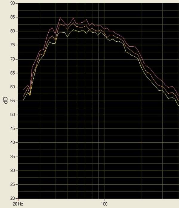

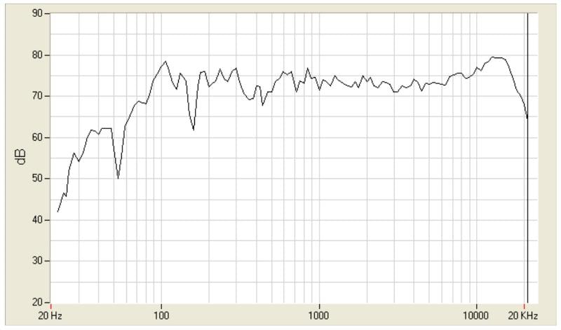

For laboratory measurements I used the Sencore SP395A FFT Audio Analyzer plugged directly into the internal amps of the Rokit 6 speakers and 10s subwoofer. The first thing I did was take the sub outside and do a groundplane measurement at one meter.
KRK10s Subwoofer Groundplane Measurement 1 Meter
As you can see the KRK10s subwoofer has very strong and linear output from about 100Hz to 35-40Hz. The bass response is definitely more linear at lower volumes (which is most likely how this sub will be run). Depending on the placement, your in room response might be a bit lower.

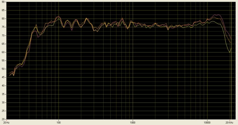

I measured the KRK Rokit Powered 6 speakers in-room on- and off-axis frequency response with 1/12th octave resolution.
KRK Rokit Powered 6 1 Meter Frequency
Response (1/12th Octave) On Axis
Note
- this is NOT a 1 watt measurement
As you can see, the Rokit 6s measures incredibly flat on axis except for a bump around 12-15kHz with a fairly dramatic dropoff below 70Hz which is expected and likely deliberate to preserve system dynamics since these monitors are designed to work in concert with the 10s subwoofer.
KRK Rokit Powered 6 1/2 Meter Frequency
Pink - On axis, Orange - 15 degrees off axis, Yellow - 30
degrees off axis
KRK specs these speakers to 49Hz which doesn't look very likely from the 1 meter graph but it much more plausible in the above. Since the speakers are probably mostly going to be used nearfield, this seems to be the most representative of actual use.

The 10s managed to shake the desk when it needed. It was closer to the
crossover point that I noticed some trouble. The overlap of the sub and
monitors was creating a muddier and more congested sound than I experienced in
the other frequencies. Whatever the problem with their crossover design, the
overlap of the sub and the speakers with this album was creating a fidelity
problem that I wasn't hearing in other recently reviewed systems with this listening
material.

Again, I found that the high end of the Rokit 6's was smooth and clear. The
midrange really jumped out at me with this test. Very clear and articulate, I
could hear a lot of the richness of what the original recording engineer was
going for. The bass was again punchy and tight but it was mostly coming from
the speakers with the sub just reinforcing the lower harmonics. The dynamics of
the Rokit 6's really impressed with all the percussive and guitar elements plus
tempo and volume changes. It seems that the problem with the sub crossover will
really only manifest itself if you are listening to content with a lot of
material at that point.
