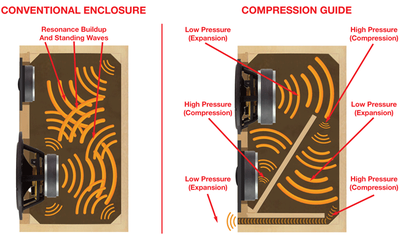

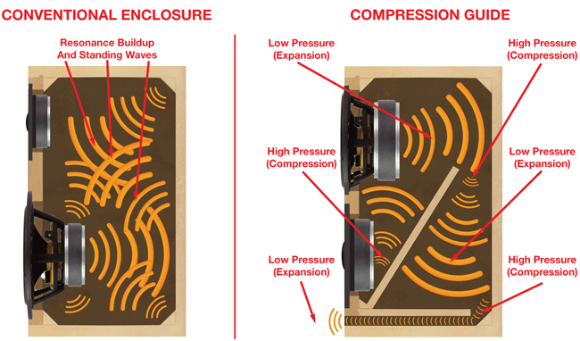

RSL Speakers Compression Guide Enclosure
RSL speakers come standard in piano gloss black and one of their main selling points is their patented Compression Guide technology, which claims to reduce cabinet resonances and standing waves.
According to RSL: The Compression Guide is our patented tuning method that divides the internal cabinet in sections of high pressure (compression) and low pressure (expansion). As the wave passes through these areas, the effects of cabinet resonance is reduced. By reducing the effects of cabinet resonance and its associated muddiness, clarity is increased. Also, bass overhang is reduced (listen to the sub especially).
While we haven’t yet dug into the patent to validate these claims, one thing is clear, the brace appears to add cabinet rigidity which is always a good thing in our book. Though the claim of reducing standing waves (a low frequency problem) and illustrating them as tiny waves in the cabinet is unclear as the wavelengths at 100Hz are in themselves over 11 feet long! Still many companies make similar claims of internal standing wave reduction by utilizing non-parallel walls which again seem questionable. According to leading Acoustician experts like Dr. Floyd Toole, these type of countermeasures won't necessarily reduce standing waves like many manufacturers often claim but they can make them more unpredictable. Whether that is a good or bad thing will ultimately depend on the end result achieved which must be analyzed empirically and subjectively. In addition, it's important to note that any "standing waves" that could exist inside a box are excited only by the woofer that is open to it. Nothing happens above the woofer crossover.

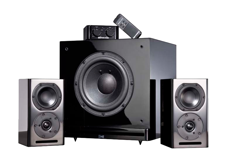

RSL CG24 Studio Monitors with Speedwoofer 10 Subwoofer
The Studio Monitor 2.1 system consists of two of their CG24 speakers (which can be used either horizontally or vertically), and the Speedwoofer 10 subwoofer. We are big fans of vertical MTM's as the dual mid woofers offer higher sensitivity and output in the critical midrange band compared to a conventional MT two driver design using the same woofer element.
The Speedwoofer 10 is controlled via a wireless remote control and features an external receiver box. The receiver box can allows you to use the remote even when the sub is hidden. It's a relatively compact box (roughly 16" cube) for a 10" driver and RSL claims the driver has a massive motor structure which we have little reason to doubt given the hefty 64 lbs weight of the product. The Speedwoofer 10 is powered by a 375 watt Class AB amplifier with linear power supply and the system's -3dB pt is rated at 24Hz, though the SPL reference is not indicated. Their big claim with this sub is it's "speed" as indicated in the product name. This is something we will have to validate with a group delay measurement and listening tests in a formal review.
