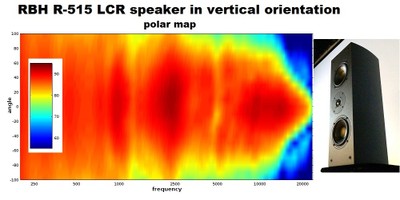

  • Excellent control of dispersion on R-515

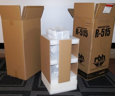

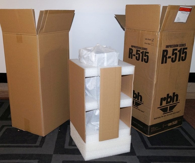

The R-5 and R-515 arrived inordinately well-packed for speakers at this price point, with double-boxing, polyethylene foam protection on all sides and additional cardboard protection, and finally a cotton sleeve over the speaker to protect it from scuffs and moisture. RBH clearly doesn’t want to deal with shipping damage claims. This packing is worth holding onto in case the speakers have to be moved or shipped anywhere else.

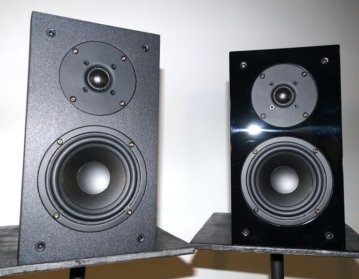

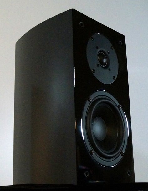

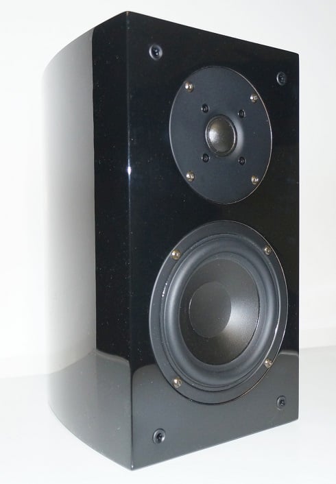

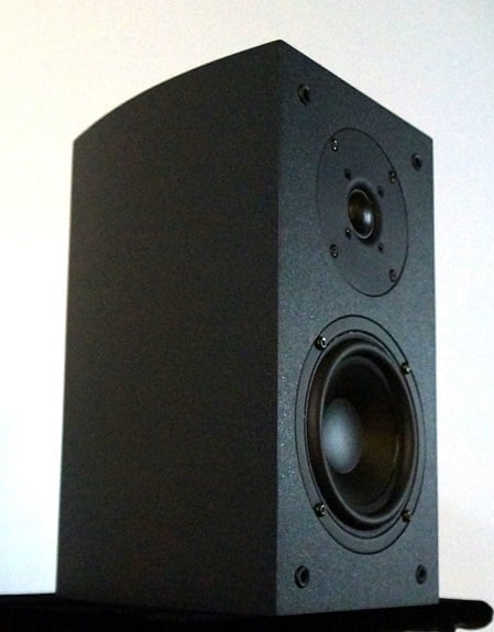

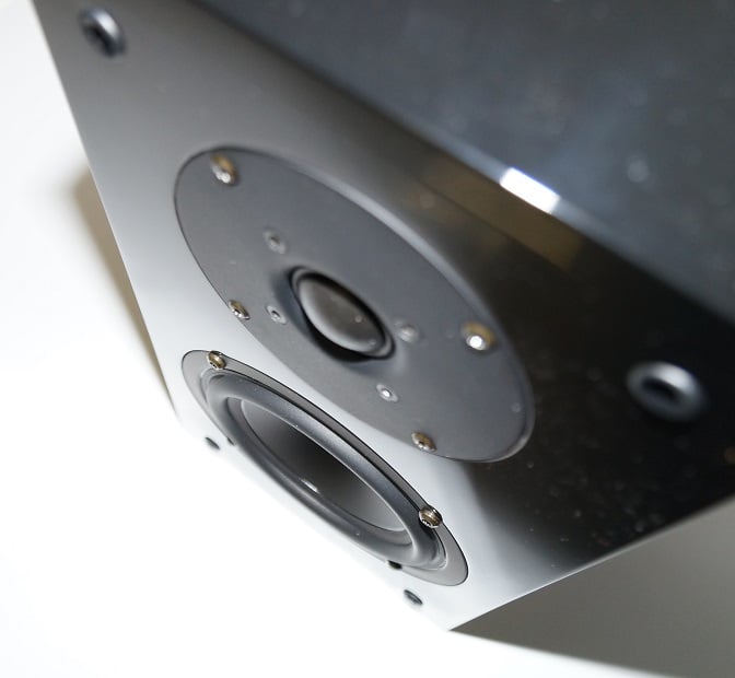

Once unpacked, the RBH speakers looked both adequate and also terrific.  I know, a little confusing, but I was intentionally sent a regular ‘Phantom’ Black, textured-vinyl finish speaker and also a gloss-black finish so I could get a sense of the difference between the two finishes.
The standard Phantom Black finish is fine for the price, but it is not exactly lavish. The gloss-black, on the other hand, is pretty sweet. It is so nice, in fact, that it is well-worth the $25/ea upcharge, and it’s hard to believe that such a nice finish increases the price by such a modest amount. The Phantom Black finish that RBH also calls a satin finish is a textured vinyl that I have seen on a spread of low-cost speakers. It is not bad; it is innocuous and durable. It doesn't scratch or scuff easily, and RBH makes it available for theater rooms with projectors, since it is quite non-reflective. The High-gloss Black finish makes for a very pretty speaker, whereas the Phantom Black looks much more plain in comparison.
RBH R-5 standard black (left pic); high-gloss black (right pic)

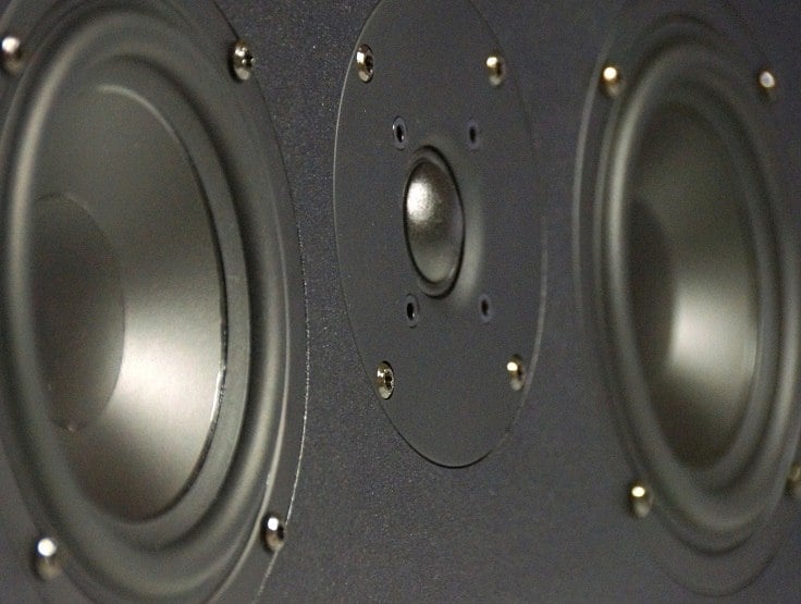

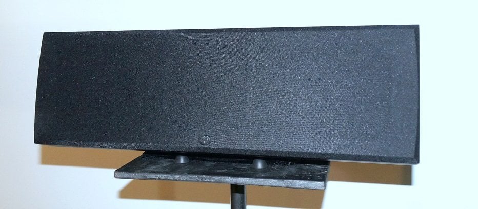

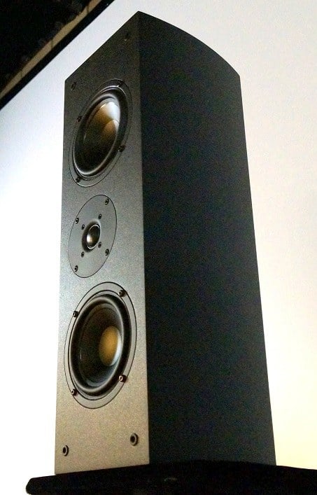

The curved cabinet definitely helps to make these speakers look nice by getting away from a box shape. The matte-black woofer with its inverted dustcap looks great, and there is no way I would hide that with the grille, but that is a personal taste in aesthetics. The grilles tone down the speaker’s functional aspect of appearance but rob them of personality. The grilles are not going to do the sound any favors either, because the grille frames will only create more diffraction edges for the front baffle. Overall, I would say that the Phantom Black R-5 looks commensurate for the cost, whereas the High-gloss Black R-5 looks like a much more expensive speaker than it actually is.

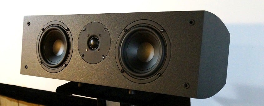

I would imagine the same holds true for the R-515, but I only received one in the Phantom Black finish. Nonetheless, it is a fine looking LCR/ center speaker.

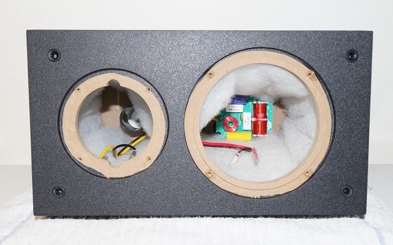

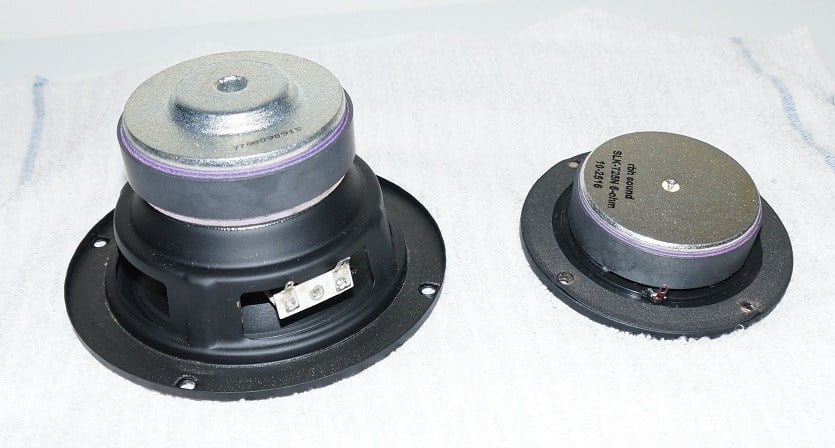

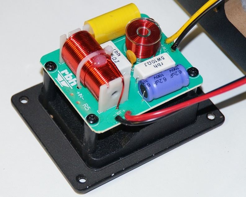

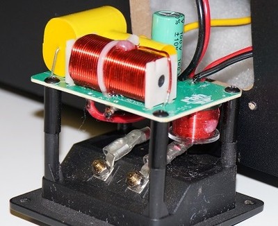

At first glance, the RBH R-5 and R-515 adhere pretty closely to sensible design principles. They are not trying to break any rules or revolutionize loudspeaker design; they are merely trying to use a common form factor in order to produce a good sound from a nice-looking enclosure for a very reasonable cost. The R-5 is a medium-sized bookshelf speaker using a 1” dome tweeter and 5.25” woofer in a second-order crossover. The R-515 is a center speaker/ LCR that uses the same 1” dome tweeter and two 5.25” woofers in a MTM configuration that also uses a second-order crossover. The tweeters use a fabric dome diaphragm and the woofer uses a polymica cone. The woofer motor has a substantial magnet that is 1.5 cm thick, 8 cm diameter magnet, but the tweeter has a relatively huge magnet that is roughly the same mass: 2 cm thick and 7 cm in diameter! Normally, tweeters use a small neodymium magnet, but RBH has decided to use ferrite which has some advantages and disadvantages. The advantage of ferrite is it has better thermal dispersal properties and is less expensive, but a disadvantage is that it has to be a lot bigger, since neodymium has about ten times the magnetic force for the same volume of mass. The woofer uses a stamped steel frame and a bumped-out backplate with a vented pole piece.
R-5 crossover(left), R-515 crossover (right)

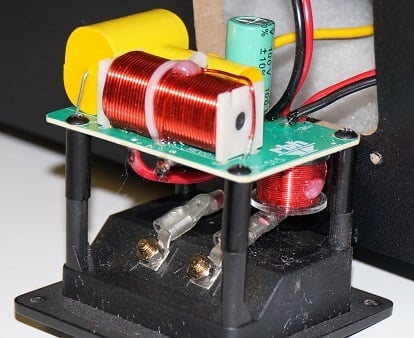

The second-order crossover looR5 rear.jpgks capable for the task of protecting the tweeter and keeping the woofer from interfering with higher frequencies. The R-5 crossover features two inductors, two capacitors, two resistors, and a polyfuse. The R-515 looks to have three capacitors, two inductors, and a polyfuse. The polyfuses protect the tweeters by limiting total current to a safe value. The crossover components are not massively overbuilt but neither are they bottom-of-the-barrel. They look to be a solid build for this price point.

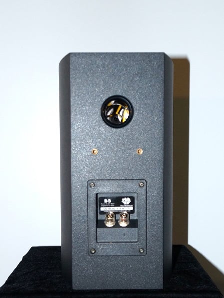

The cabinet is a relatively robust construction that uses 2 cm thick panels all round. The R-5 uses a window brace between the woofer and tweeter, and the R-515 uses two window braces, each between one of the woofers and the tweeter. There is a generous amount of stuffing inside the speakers for damping and also isothermal conversion. The tweeter on the R-515 is offset to the edge of one side of the front baffle. Both speakers are rear-ported using 1.5” ports with slight flaring, with the R-5 having one port and the R-515 using two ports. Neither speaker has feet, but RBH provides two rubber bumpers for the R-515 which allows the user to adjust the tilt of the angle when the speaker is used in a horizontal orientation. The grilles are made from stretching a acoustically transparent fabric over a thick MDF frame. As was mentioned before, the frame of the grille is bound to create additional diffraction, so for the best sound, leave it off. Sturdy five-way binding posts are used to connect the speaker wire.
