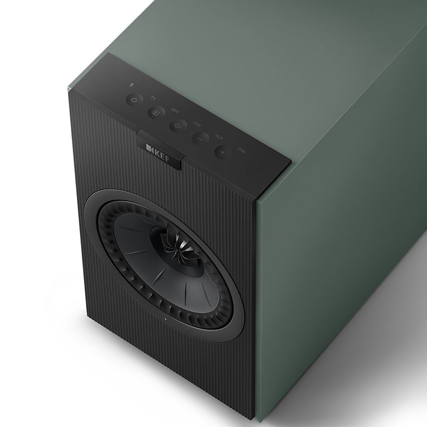

KEF Coda W top controlsEven after the advent of KEF’s signature Uni-Q driver array in the late 1980s, speakers in the brand’s Coda series used more traditional (i.e., non-concentric) drivers to keep prices down. But the new Coda W uses a large 12th generation Uni-Q driver array, in which a 1-inch aluminum dome tweeter sits at the acoustic center of a 5.25-inch mid-woofer with a magnesium/aluminum alloy cone. As in other KEF speakers, the Uni-Q driver array acts as a point source, delivering “remarkably detailed performance… recreating how sound is produced naturally,” according to KEF. A well-designed concentric driver array like the Uni-Q ensures uniform dispersion throughout the room, creating what KEF describes as an exceptionally natural and immersive listening experience. KEF is not the only manufacturer going this route — you’ll find similar concentric arrays from brands like Fyne Audio, MoFi, Elac, and TAD — but KEF was the first to build a truly coincident source driver, and the company’s decades of acoustic expertise are now backed by advanced simulation and precision engineering.
In each Coda W speaker, the tweeter is powered by a dedicated 30-watt Class D amplifier, and the mid-woofer gets 70 watts of Class D power from its own beefier amp. With a combined 200 watts of system power, the Coda W promises the all-important “room-filling sound” from a compact cabinet measuring 11.2 inches tall, by 6.6 inches wide, by 10.55 inches deep. All that power is tamed by KEF’s Music Integrity Engine, a proprietary suite of DSP algorithms handling everything from the crossover to distortion reduction. The Music Integrity Engine has been specially tuned for the Coda W, according to KEF, enhancing overall performance by providing “remarkable sound integrity, detail, and accuracy.”

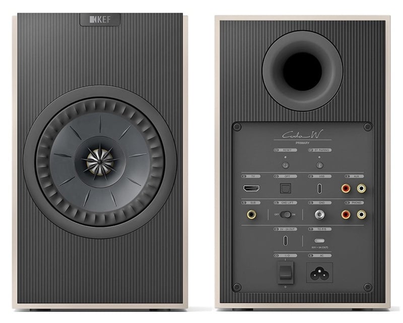

The Coda W uses Bluetooth 5.4 with aptX Adaptive, Qualcomm’s high-quality, low-latency codec that promises both clarity and a reliable connection for content up to 24-bit/96kHz (although it’s worth remembering that this is a lossy codec, so some info will be sacrificed to the gods of data compression and bandwidth reduction). Purists might prefer to take advantage of the Coda W’s support for aptX Lossless, which can deliver CD-quality resolution up to 16-bit/44.1 kHz without resorting to lossy compression. But here, there is yet another caveat: very few source devices support aptX Lossless, and it only works when both the source (such as a smartphone) and the receiving device support the tech. You can work around that limitation by attaching a compatible dongle, such as the $60 Sennheiser BTD 700, to your source device, but I would recommend skipping Bluetooth altogether and adding a network streamer with a digital output instead — more on that later.
KEF Coda W lifestyle
Vinyl enthusiasts will love the fact that the Coda W is turntable-ready, featuring an integrated phono pre-amplifier that connects directly to any turntable running a moving-magnet cartridge. If memory serves, the Coda W is KEF's first active speaker system with a built-in phono preamp. While not everyone will take advantage of it, I think it’s a useful feature, and an appropriate one for this class of product. Any vinyl devotee spending $6K on KEF’s high-end LS60 wireless speakers probably has a separate phono preamp, but for a more “lifestyle” customer running a pair of the Coda W speakers, the ability to dispense with additional separate components will probably be much appreciated. For turntables with a built-in phono preamp (such as the $699 Cambridge Audio Alva ST), the Coda W also offers a line-level input.
KEF Coda W in room with sub
For those replacing a soundbar, the Coda W’s HDMI input makes it simple to use the speakers with a TV. And for desktop duty, the USB Type-C input makes the Coda W a natural partner for a PC or Mac, offering support for files up to 24-bit/192kHz, though resolutions above 24-bit/96kHz will be downsampled. (While KEF’s LSX II and LSX II LT both make great computer speakers, some might find the Coda W a bit on the large side for this application. Your mileage may vary depending on the size of your desk and your aesthetic sensibilities.) An optical digital input on Toslink rounds out the input options, accommodating your favorite disk-spinner, an older TV, or — crucially — a network streaming device. The primary speaker, which handles all the IO for the pair, also includes a dedicated subwoofer output for easy connection to the subwoofer of your choice. KEF might steer you toward the KEF Kube 8 MIE, which sells for $700. An optional KW1 wireless subwoofer adapter kit ($250) enables a clean and stable wireless connection, minimizing cable clutter.
KEF Coda W front and rear
Speaking of cables, the two speakers must be connected to each other by way of the included 3-meter inter-speaker C-Link cable, which looks suspiciously like a USB-C cable. This provides both the digital signal and power to the secondary speaker. Those needing a longer run can purchase an 8-meter inter-speaker cable for the relatively sane price of $60.

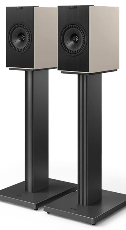

The optional SQ1 floor stands might be a harder sell at $400, but they promise a stable platform for elevated positioning and optimal listening height, and they do look very nice indeed. The Coda W features intuitive top-panel buttons for quick access to essential functions and source switching.

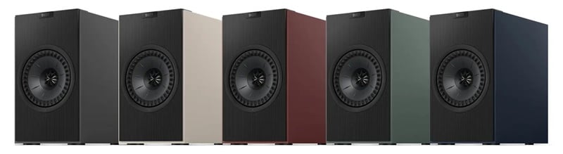

Compared to KEF’s curvy LS50 Wireless II and LSX models, the Coda W veers more traditional in its styling, thanks to its clean rectilinear lines and subtle detailing. The minimalist, vintage-inspired look is lent some modern refinement by the five carefully-curated finishes: Vintage Burgundy, Nickel Grey, Moss Green, Midnight Blue, and Dark Titanium. I think the overall look is one of quiet sophistication — not screaming for attention, but not just another black box.
KEF Coda W colors
