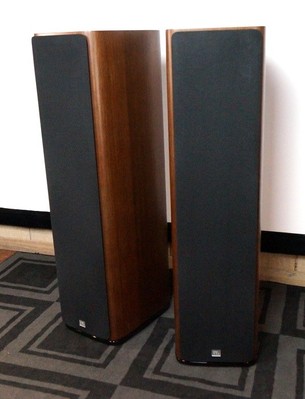

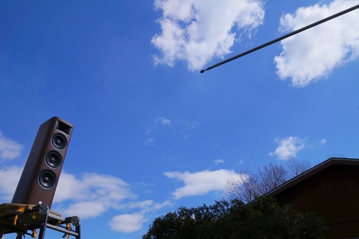

The JBL HDI-3800s speakers were measured in free-air at a height of 4 feet at a 2-meter distance from the microphone, with the microphone raised to a 7.5’ elevation that was level with and aimed at the tweeter center. The measurements were gated at 9-milliseconds. In this time window, some resolution is lost below 400 Hz and accuracy is completely lost below 200 Hz. Measurements have been smoothed at a 1/12 octave resolution.

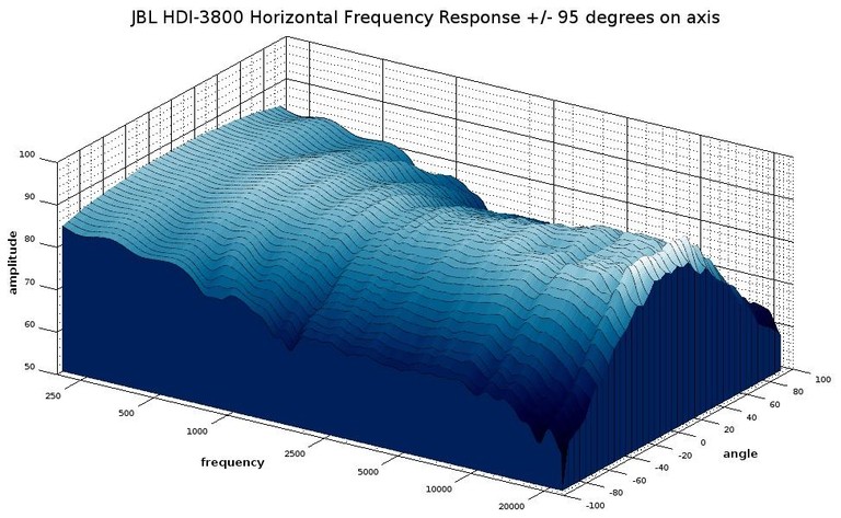

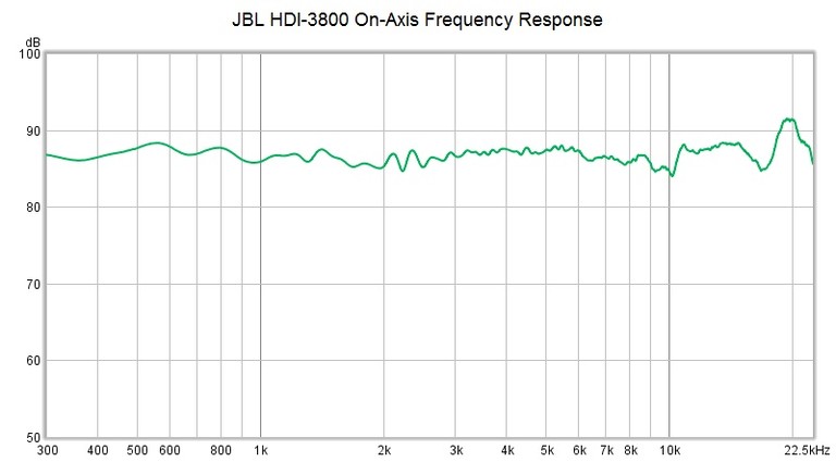

There is a whole lot to like about the measurements seen in the above graphs...

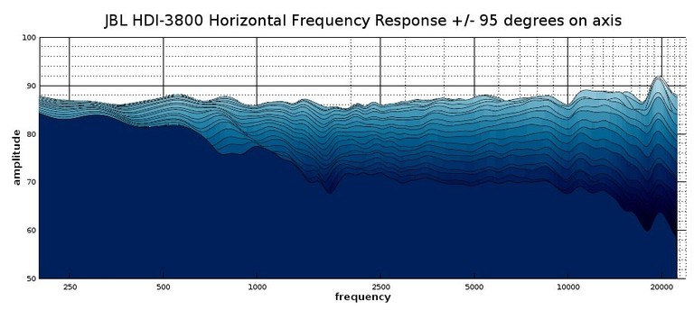

The above graphs depict the JBL HDI-3800’s on-axis and horizontal dispersion out to a 95-degree angle in five-degree increments. Information on how to interpret these graphs can be read in our article Understanding Loudspeaker Review Measurements Part II. There is a whole lot to like about the measurements seen in the above graphs, and pretty much nothing to complain about. This is a beautifully neutral showing both on and off-axis. You could listen to these speakers over a broad angle in front of them and get the same tonality, and it would be an accurate sound. The good news about that is not just that you could listen at an off-axis angle for the same experience, but that all the acoustic reflections in-room will have the same tonality as whatever the direct sound is hitting the listener. You really don’t need acoustic treatments with that kind of performance. This is terrific performance, and it is befitting the kind of expectations that one would have for a modern high-end speaker from JBL.

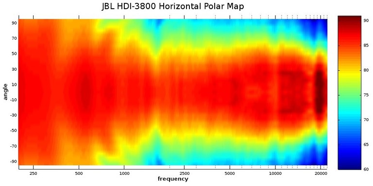

The above polar map shows the same information in the preceding graphs but depicts it in a way that can offer new insight regarding these speakers’ behavior. Instead of using individual raised lines to illustrate amplitude, polar maps use color to portray amplitude, and this allows the use of a purely angle/frequency axis perspective. The advantage of these graphs is they can let us see broader trends of the speaker’s dispersion behavior more easily. More information about interpreting this graph can be read in our article- Understanding Loudspeaker Review Measurements Part II.
What we see here from the HDI-3800s is beautifully controlled directivity. JBL’s waveguide technology is no joke and is really paying off here. The beamwidth, which is defined as the off-axis angle at which the amplitude is down by 6 dB, is impressively flat at around the 50-degree angle. There is no doubt that this is one of the best waveguides out there. This is not exactly a wide dispersion pattern nor is it a very narrow dispersion. As the graphs above it demonstrate, we see it offers uniform coverage over a wide area, and so long as the listener isn’t seated way off-axis, there isn’t a bad seat in the house.

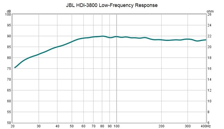

The above graph shows the HDI-3800’s low-frequency response captured using groundplane measurements (where the speaker and microphone are on the ground at a 2-meter distance in a wide-open area). Here we again see a nicely linear response that accounts for how sharp the HDI-3800’s bass sound is. There is a gradual roll-off in deep bass below 50 Hz, and the port tuning looks to be quite deep, perhaps below 30 Hz if I had to guess from this measurement. That explains how this tower speaker was able to handle deep bass so well. That being said, I wouldn’t want to throw high levels of infrasonic bass at this speaker, meaning stuff at or below 20 Hz. Below port tuning frequencies, the drivers are not protected by compressed air within the cabinet and can be more easily over-driven. If your listening tastes are geared for movies with deep bass, the addition of subs may still be worthwhile.

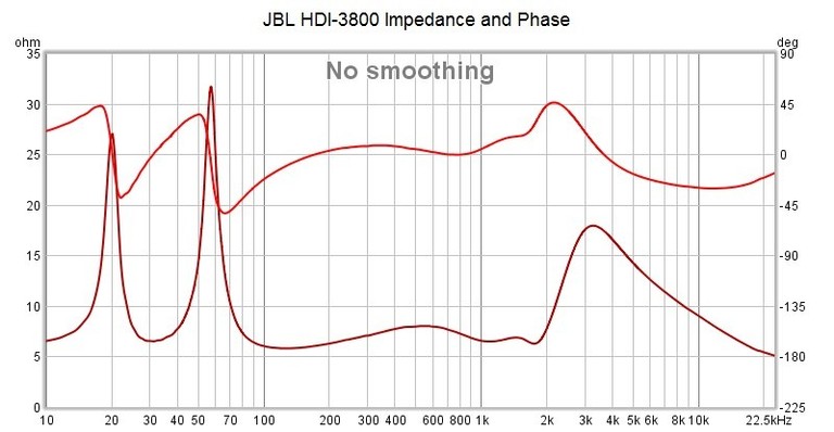

The above graph shows the electrical behavior of the HDI-3800. JBL specifies these as a 4-ohm speaker, and that is a conservative rating according to our measurement. If they called it a 6-ohm nominal speaker, I wouldn’t argue. The minima is 5.8 ohms at 127 Hz, but that happens with an agreeable phase angle of 11 degrees. Overall, this is not a difficult electrical load for any competently-engineered amplifier. I think even budget AVRs could cope with this, although I doubt anyone who buys these speakers will pair them up with a budget AVR. I measured the sensitivity at 90.4 dB at 1 meter for 2.83v. JBL specs them at 92 dB for 1 meter at 2.83v, and that isn’t a big difference when variability in the way sensitivity measurements are done is considered. That is above-average sensitivity for a floor-standing speaker, but perhaps not one as large as the HDI-3800. Given the low-frequency extension of the HDI-3800, it is expected that the sensitivity wouldn’t be huge, but they can still go a long way with just a few watts.

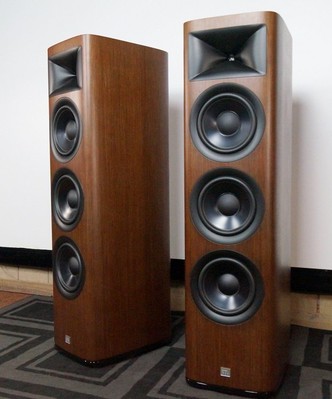

HDI outside.jpgApart from their sound quality, they do look very nice. They are largish, but they are tastefully designed so that they won’t draw as much attention as something their size might have otherwise. In other words, their subdued aesthetics help to mitigate their size. The build quality is very good, and these are solid, sturdy loudspeakers that are built to last. If you take care of them, they will endure for decades without problems. In addition to their looks and build quality is their electrical load which wouldn’t present a challenge to all but the weakest amplifiers. You can run the HDI-3800s on nearly any amplifier and not have to worry. Of course, they can handle a great deal of power, so if you want to get the most out of them, don’t starve them of wattage, but then again that all depends on your preferred listening levels.
As I said before, the HDI-3800s are not inexpensive, but they are a lot of speaker for the money, and I would say you definitely get your money’s worth. They sound terrific, they look great, they have the acoustic characteristics that make them a good fit in many different rooms and the electrical characteristics that allow them to run on many different amps, and they offer subwoofer-like bass so they are very much a full-range loudspeaker. The HDI-3800s might not be cheap, but for the overall package, I would say they are a bargain. It pains me to send these back to JBL, but if I didn’t have so many other speakers to review, they may well have been keepers for me. Highly Recommended!
