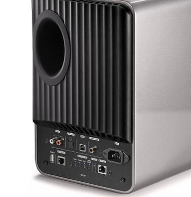

The active components in the new speaker system have been selected to make this a compact powerhouse that will feel right at home in a wireless and hi-res music environment without any compromise to audiophile demands. The preamplifier section has dual-band 2.4GHz/5GHz a/b/g/n Wi-Fi. and 10/100 Ethernet. The Ethernet port doubles as a service port should you need it. Bluetooth 4.0 with the aptX codec are also standard. You can pair up to 8 Bluetooth devices with the LS50 Wireless. For input options, you have USB Type B, Toslink, and RCA line-level analog. There is also an unbalanced subwoofer output if you want to expand the system’s low end frequency response.
To decode any digital source with the utmost fidelity and precision, KEF has included an astounding two DACs per channel (for a total of four). The DACs are capable of decoding 192kHz/24-bit music files. In the materials we received, KEF did not specify which DAC they have chosen for the LS50 Wireless but given the caliber of this product, we are confident they employed top notch components. Note that the Toslink port is limited to 96kHz.
Detail view of the KEF LS50 Wireless heat sink, port, and inputs.
