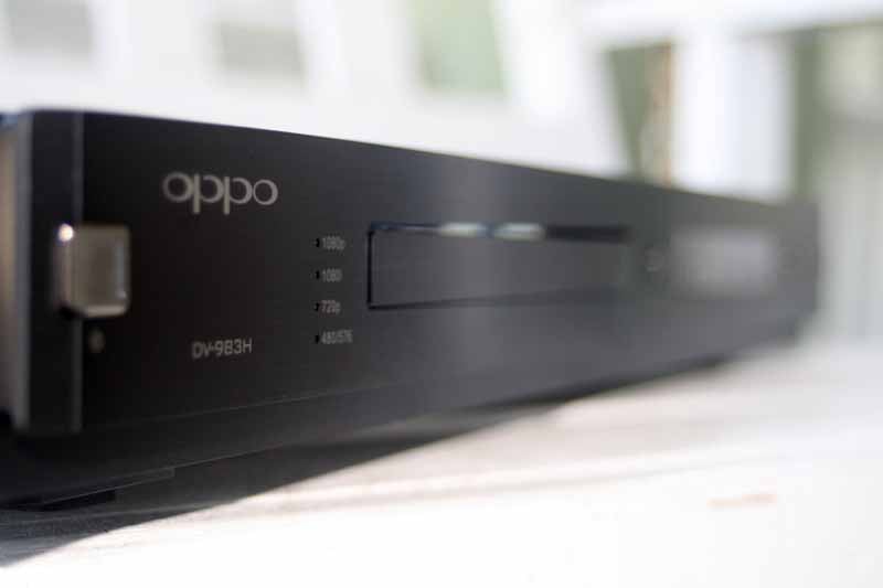

Oppo DV-983H DVD Player
  • Product Name: DV-983H Upconverting DVD Player
  • Manufacturer: Oppo Digital
  • Review Date: June 23, 2008 07:00
  • MSRP: $ 399
  • Buy Now
Supported media: DVD-Video, DVD-Audio, SACD, CD, HDCD, Kodak Picture CD
CD-R/RW, DVD±R/RW, DVD±R DL
Video
Analog Video: Composite, S-Video (Y/C), Component Video (Y/Pb/Pr, 480i/480p, 720p/1080i/1080p available for non-encrypted content only)
Digital Video: HDMI with HDCP (NTSC: 480p/720p/1080i/1080p, PAL 576p/720p/1080i/1080p)
Composite Video Amplitude: 1.0Vp-p (75Ω)
S-Video Amplitude: Y: 1.0Vp-p (75Ω), C: 0.286Vp-p (75Ω)
Component Video: Y: 1.0Vp-p (75Ω), Pb/Pr: 0.7Vp-p (75Ω)
Audio
Analog Audio: 7.1ch, 5.1ch or stereo
Digital Audio: Coaxial, Optical
HDMI Audio: Stereo or up to 5.1ch high-resolution PCM
Frequency: 20Hz - 20kHz (±1dB)
Signal-to-Noise Ratio: >100dB
Total Harmonic Distortion: < 0.01%
Power Supply: ~ 100V – 240V, 50/60Hz AC
Power Consumption: 20W
Dimensions: 16-7/8 x 10-1/2 x 2-1/8 inches (430 x 267 x 53mm)
Weight: 6.1 lbs (2.8 kg)
Operating Temperature: 41°F - 95°F (5°C - 35°C)
Operating Humidity: 15% - 75% (No condensation)
