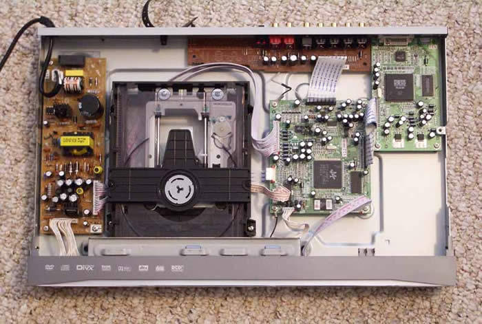

Internal Components
The build quality if
the unit is what I would expect for a low-profile DVD player. The overall layout of the chassis
components is clearly defined and organized with a drive, power supply, connector board, DVI and
Genesis video processing circuitry and a MediaTek MPEG board. The MediaTek board uses the 1389 chipset
which is found on many PC-based drives and has had its share of firmware issues (which fortunately for
owners, Oppo has been excellent at addressing to date based on user feedback). Even with these issues,
the MediaTek chipset remains a very progressive system with support for such formats as DivX Pro. The
Genesis FLI-2310 chip, which appears exclusively on the DVI video output board, is no slouch and
appears on many higher-end DVD players. Why it is limited to the DVI board is an unfortunate mystery,
but we imagine Oppo was doing its best to meet its particular target price point. The OPDV971H has a
very modest power supply with a single 47uF capacitor and a PFC Boost Inductor. The slim-load DVD drive
is mostly plastic, but the unit seems built more for form than function in going with the slim overall
design.

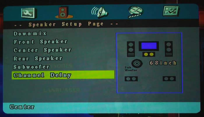

Setting up the audio for the player was easy, though I found myself looking for more
information and options. You can select the Downmix which will appear on the twin RCA connections
labeled "Mixed"
on the back of the player. If you select 5.1 then discs with 5.1 content
will play straight through with no downmixing. There are basic bass management options provided by the
player and speakers can be set to Large or Small to allow bass frequencies to either route to the
speakers or be crossed over to the subwoofer. While we were glad to see this, the crossover frequency
could not be adjusted, and time delay varied per speaker. The center channel, for example, maxed out at
68"
(5'
8"
). That was just over half the distance I needed to get to my listening
position. Subs and surrounds were more flexible, with maximum settings of 204"
(17'). In
addition to the issue of maximum distance, the channel delay was configurable in 4"
increments.
There are also no delay settings available for the main speakers, which is confusing considering the
center channel would need to closely match the main speakers (and thus, by deduction possibly controls
delay for the mains as well).
Update: According to OPPO, the audio channel delay adjustments are relative distance between the main speakers and the center, left surround and right surround speakers. The adjustments are not the absolute distance between each speaker and the listener. For this reason the adjustable distance of the center channel is limited to 68", and for the same reason the delay for the main speakers is not adjustable. The idea is to compensate the audio propagation difference caused by the distance difference of the speakers. This is not clearly mentioned in the manual, thus the confusion.

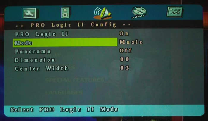

Audio Setup Page allows you to configure the unit to upsample PCM audio to either 48kHz, 96kHz, or
192kHz. You can also set up Dolby Digital and Dolby Pro Logic II modes within the player through
dedicated sub-menus, though this only works with the analogue outputs of the player. In this way you
can tweak the options for dynamic range and also set Pro Logic II to default to Music or Movie modes
(there is even an option for good old fashioned Pro Logic). Music mode gives you additional settings
for Panorama, Dimension, and Center Width (how much of the mains gets fed into the center channel
speaker). Most users will configure such settings on their receivers. Moving back to the main Audio

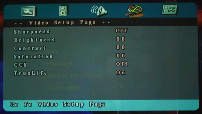

The
Video Setup page finishes up the Setup menu with access to Sharpness, Brightness, Contrast and
Saturation (+/- 10 for each setting except Sharpness which is Off/High/Medium/Low). It was at this
point that the lack of a key repeat on the remote control really started to get to me. To make
adjustments you'll need to repeatedly press the key for each incremental change. After a while it
just gets tiring. TrueLife (switchable on/off) enables the DVI-only Faroudja processing that uses
non-linear algorithms to enhance small details and colors in images. It is designed to improve depth
perception by sharpening large edges without introducing visual artifacts or distortion. Basically,
turning TrueLife "off"
disables the Faroudja deinterlacing, causing the Oppo to perform
rather poorly when feeding any DVI/HDMI-capable device.

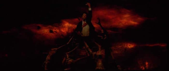

DVD: Constantine
No, it's not an epic movie about a third century Roman Emperor... Constantine is done in the (seemingly endless?) style of comic book-turned-movie franchises which pepper the audience with dark, dimly lit scenes periodically erupted by peaks of action and explosions. I chose this disc, not for its great cinematic qualities - but to check out how well the Oppo did in low luminance level situations. What I found was that, while the Oppo passes blacker than black signals (and this DVD had quite a bit of very dark content) it tended to crush the blacks a bit more than my DVD-3910 reference player. Since there was no way to adjust gamma on the player, this condition was a consistent issue during dark scenes. For people who don't adjust the brightness on the player this could be a real problem. The picture in Constantine was not as noisy as the previous movie and so I didn't see too many occurrences of noise that detracted from the viewing experience. There was quite a bit of motion in this disc, which gave the Oppo OPDV971H a chance to show off its motion adaptive deinterlacing ability along with a consistent color representation that didn't seem to falter (lose bit depth) during action-heavy scenes.
