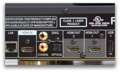

But... Take a look at the back and you'll see dual HDMI outputs but also an HDMI input. There are dual USB inputs and also full 7.1 audio outputs. Of course if you have legacy audio connections you can still use the optical or coax digital output of the player to connect it to your AV receiver. The BDP-103, like the former BDP-93, includes an RS-232C connection for home control systems. What you WON'T see are any analog video outputs. These are now officially, as of 2013 at least, disallowed under the new analogue sunset rules which state that no licensed player that passes decrypted AACS content to analog video outputs may be manufactured or sold by a Blu-ray adopter after December 31, 2013. Since Oppo didn't think it would be a great idea to have to re-adjust the hardware on their player mid-production, I'd say this was a good advance call.
HDMI "in" means that you can make up for a lack of a receiver or enough HDMI inputs.
Or you can use the Oppo as a switch of sorts to feed just one HDMI cable to your television.
Now let's go back again to the dual HDMI outputs and HDMI input on the back of player. The two HDMI outs can be split so that one sends just audio to an AV receiver and the other goes to your display. This is good if you have a 3D television but a receiver that can't pass 3D. Same goes for the eventual issues we'll have with 4K. You can also use them as true dual outputs, sending both audio and video to 2 different displays at once.
The HDMI input actually lets you set up a cable box or some other source device that will then feed into the player. Then you can select the source device via the player's Input button at the top of the remote. This means you can use the BDP-103 in-line with the another device - and that's going to be good for people who don't have an AV receiver or who just have a couple of source devices but they don't have another HDMI cable running to their television. It also has another use and that's for audio return channel (ARC) control. While it lets you select between the MHL front input and the HDMI back input, it also gives you control over whether you are using HDMI output 1 or 2 to provide ARC audio from your TV.

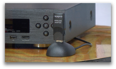

You can place the dongle directly in the player or use this included extension
We connected the BDP-103 to the Internet using Ethernet, but you can also use the included Wireless b/g/n dongle with any of the 3 USB connections to make this a wireless player.

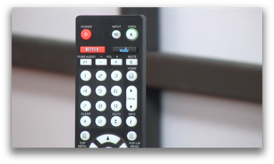

The remote control is very similar to the previous model, however it added to the top Netflix and Vudu buttons and it reorganized the navigation controls to be a little more standard so that you don't slip off accidentally and touch something you're not supposed to. We also like the new backlight. The button is about the same except it's round - and when you press it you get a nice white white light instead the more amber glow of the old remote.

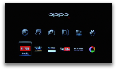

Okay let's talk play back. The Home menu now has icons for Netflix, Vudu, film fresh, YouTube, Pandora and Picasa. It's not clear whether Oppo can add more applications at a later date. Right now it seems to be very fixed in what the player will offer - but knowing Oppo, the sky's the limit. Aside from the benefits of Netflix, Vudu and others, we also liked the effortless way in which the player can stream audio, video and photos from network computers. We streamed a ton of both Pandora music and also high resolution audio content and loved how well this player sounded in reproducing the material.
