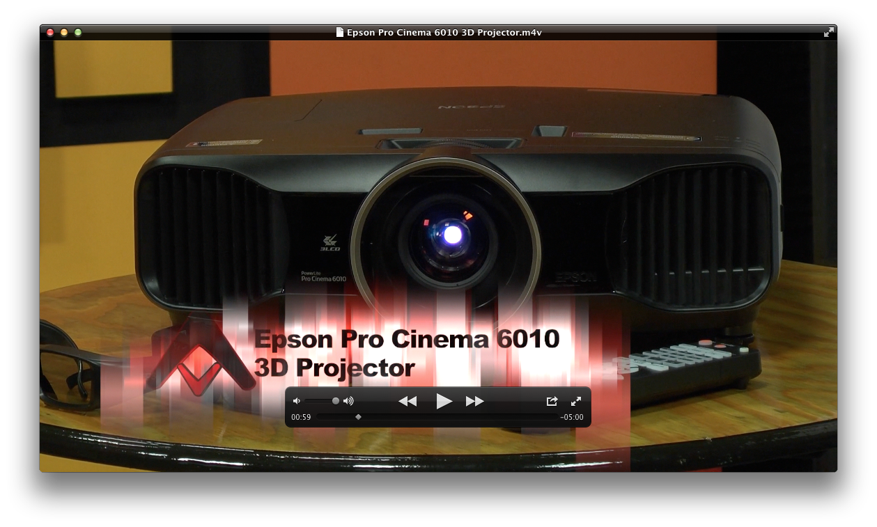

Epson Pro Cinema 6010UB 3D Projector Review

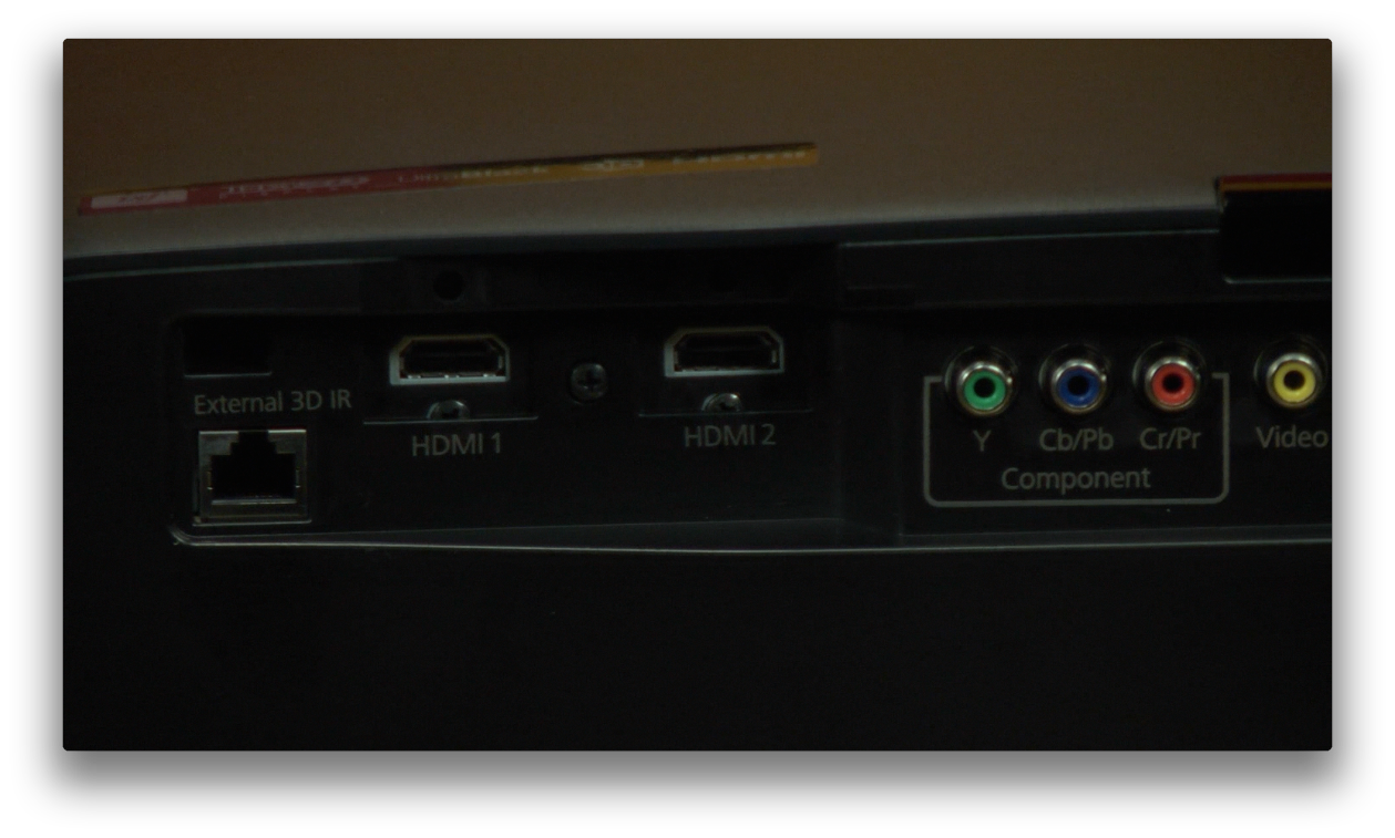

- Inputs: 1 composite, 3 component, 1 VGA D-sub 15 pin, 2 HDMI, 1 RS-232C
- 12VDC Trigger On/Off (3.5 mm stereo jack)
- RJ-45 (for external 3D IR emitter)

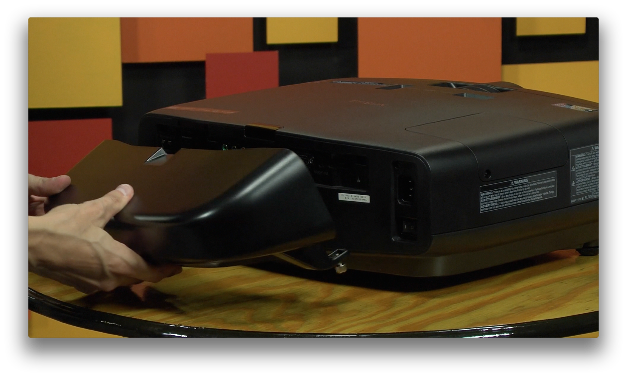

mount made by Chief. There's also a really nice cable cover that will
significantly clean up the look of your install and the 6010 includes
a full 3-year parts & labor replacement warranty, an extra year
